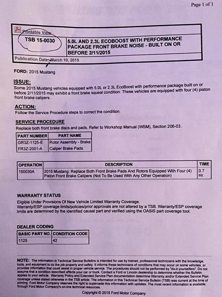

********A TSB HAS BEEN RELEASED MARCH 10 *********
Call your dealership now to look it up. There are part numbers for new pads and rotors. The pads are the same, but the rotors are updated. Have them place your order today!
Thanks again Rachel at Ford for getting the ball rolling.
Yep, got a call today from my local service dept. Bad part is that they won't just order the parts for me. I still have to take the car in.
I'm just glad they are finally fixing the problem. Just in time for the warm weather days.

Posts: 31
Is there a tsb number? I called my dealership and they said they couldn't see anything
Old Mar 11, 2015 | 11:19 PM
  #155
klumpikat's Avatar
Joined: January 6, 2015
Posts: 25
From: La Jolla, CA
TSB 15-0030

Just dropped off Mustang
Of course I called first explaining the TSB, and they said to bring it in (3rd time!!). First thing the technician said is (I showed him the TSB) is "sorry man we don't have those parts yet, but we'll try to clean up the brakes".
What am I missing here?
Old Mar 12, 2015 | 10:05 AM
  #157
SpectreH's Avatar
Joined: February 5, 2015
Posts: 4,247
Likes: 1,155
From: Yukon, OK
That TSB is dated 10 March. It will take a while to get all the parts manufactured and out to the dealers. I'd be willing to bet that the first run of parts went to all those cars that were built and held for a few weeks pending testing of the final parts.

Update
So they inspected the vehicle and what a surprise it is this known issue. So they ordered the new parts and will be here 2-4 weeks. But apparently I had to bring the car in just to get to that point as someone else said. I don't understand why I would need to bring it in if it's a widely known issue, but whatever, god forbid anyone makes this easy

  #160
MrsThomas's Avatar
Joined: December 31, 2014
Posts: 20
TSB 15-0030
So I have a question?
The TSB says ecoboost but I have the 5.0. Will this cover mine or are they coming out with one for just the 5.0?
