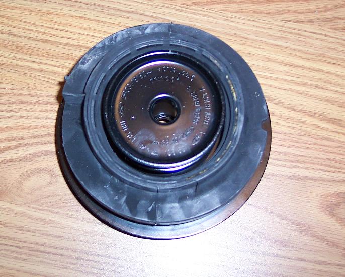

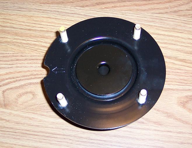

I just got the replacement mounts from Ford today (no charge) and will be installing them myself when I do the Eibach pro kit and Dspecs tomorrow. It will be a big difference with all the new parts, I hope it takes care of the noise. Otherwise no big deal, I have dealt with it long enough as is. And no extra work for me, or out of pocket money.
