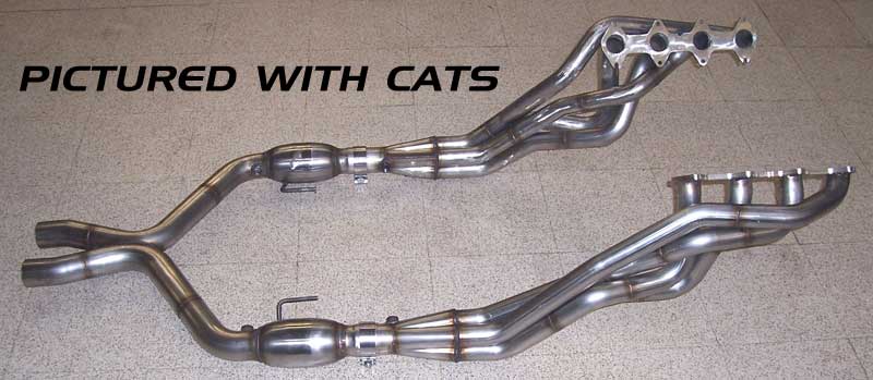

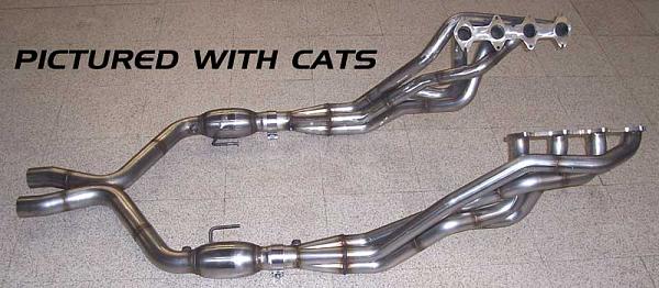

Posts: 1,032
Originally Posted by Redfire 05Gt
Scott,
I think I see two welded primaries on the left header.
http://www.mustangforums.com/m_1355445/tm.htm
check out the ARH long tubes again...just a few welds:
