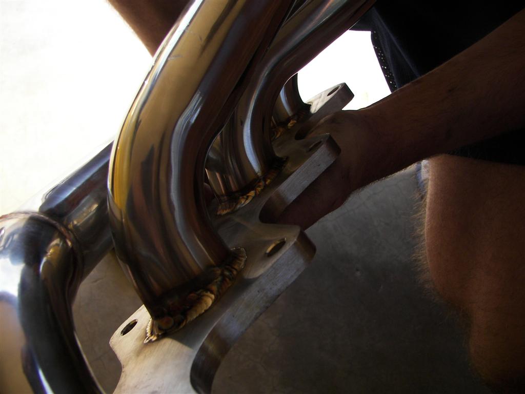

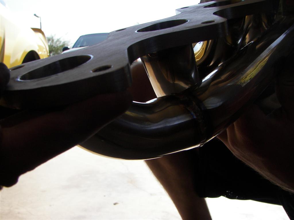

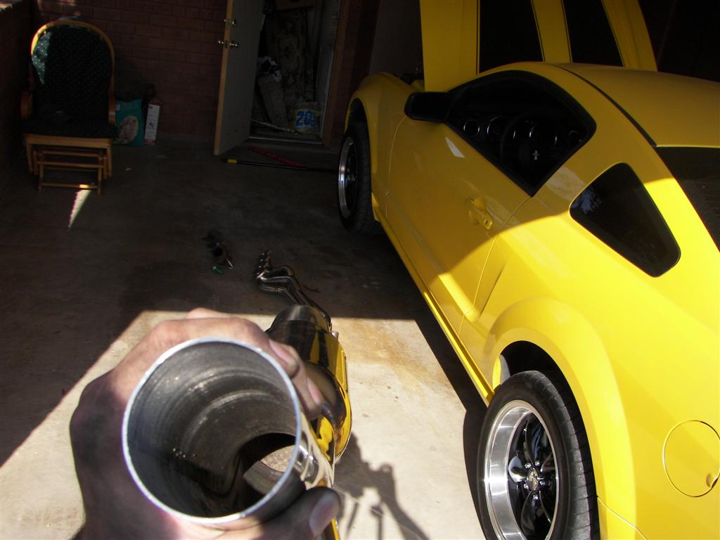

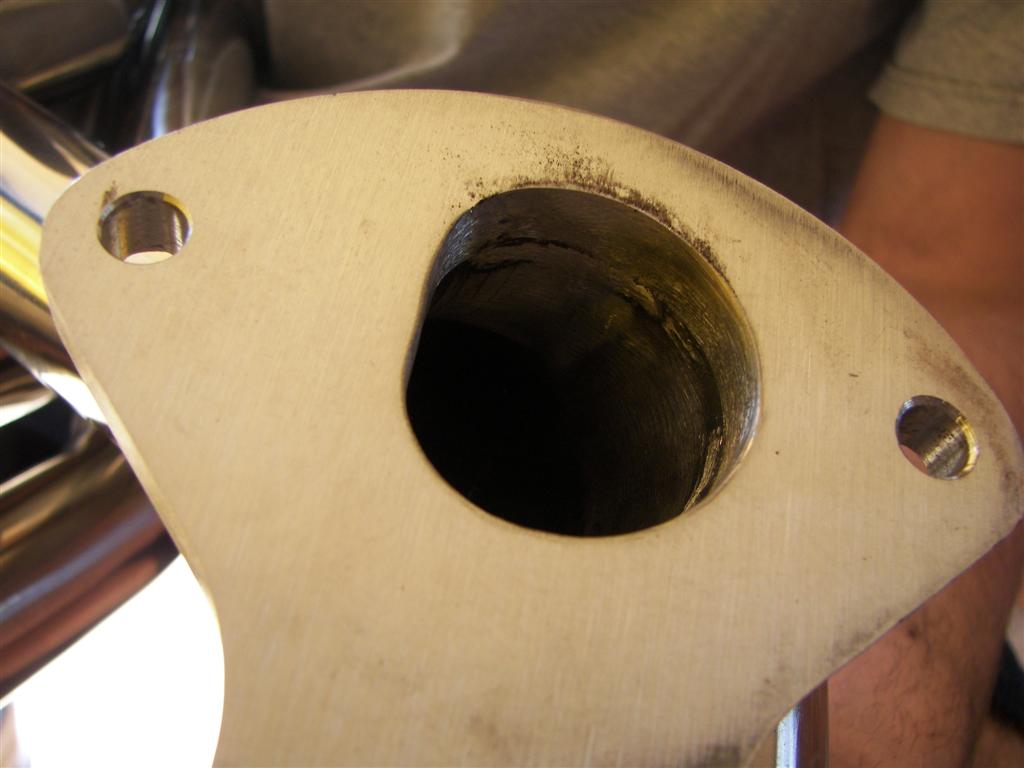

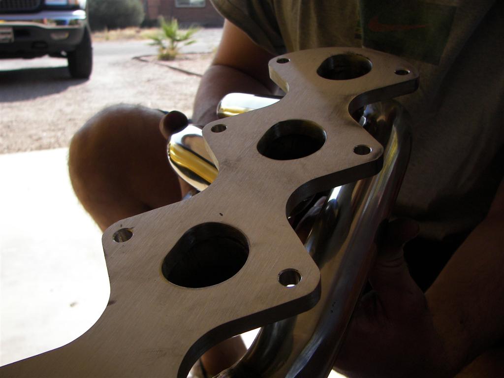

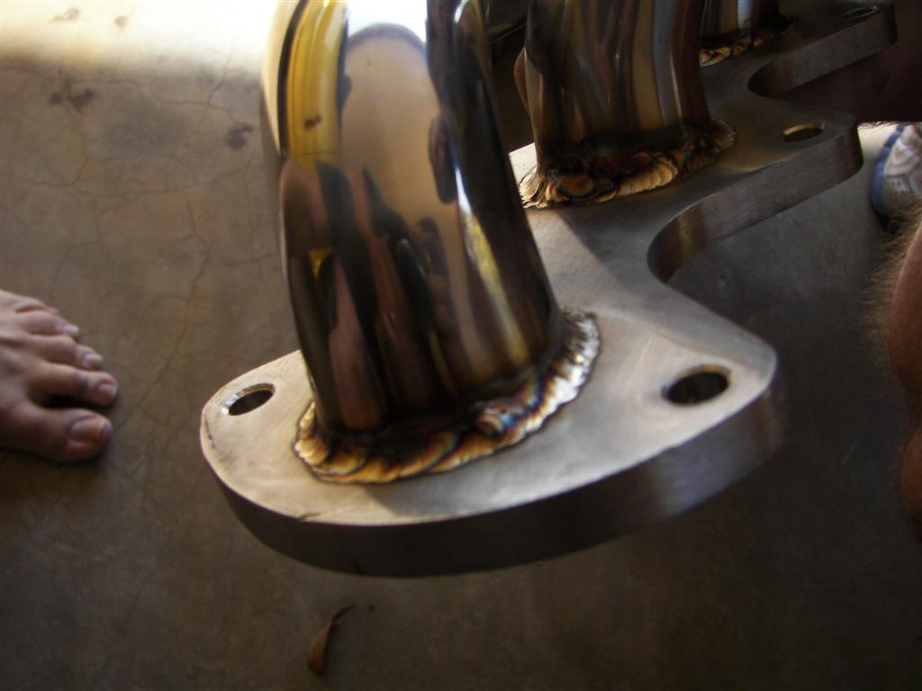

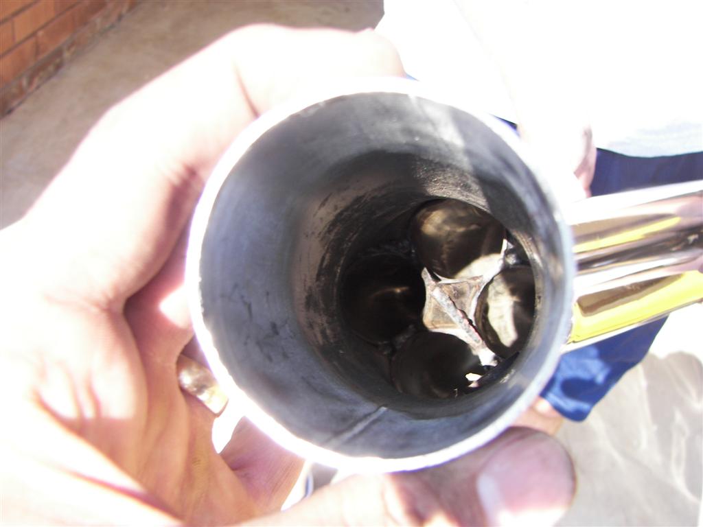

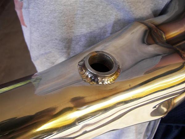

Here are some pics. Notice the welds are very nice, The walls of the tubes are thick, the cnc'd flanges are nice and perfectly flat. At the point where the primaries come into the collector there is a nicely fabricated spike to avoid eddys in the airflow. the high flow cats are actually just a small race muffler, so no chance of the cat coming apart and blowing up your motor.
I would buy these headers all week long and twice on sundays. Cheap chinese junk my a**...

Not to be a butt about it, but aren't step headers made from more than one piece of pipe and then welded together, Ken? I've seen and used a CNC tube bender and sometimes, even if you can bend it, its not always the best solution. I've also seen custom headers made by hand, piece by piece, and tig-welded from the flange to the collector by hand, and they look and perform as well, if not better than a pre-made piece. Just b/c something costs alot doesn't always mean its the best value, in fact, if more competition is in the marketplace, then it causes the manufacturers to find lower cost methods to keep up with the competition and who benefits this? The consumers!! And possibly the manufacturers by coming up with better, lower-cost technology. When these cars first came out, I could understand why some parts were so expensive, but now, 4 years later, I don't see how some of these companies can charge what they do. I'm not made of money, and even though I'm a UAW autoworker, my '66 has a number of off-shore repro parts on it (some parts have to be, unless you buy N.O.S.!!) plus, I know that alot of the parts on this car O.E.M. are source from outside the U.S. so, when I buy parts, I look for the best value. Like the CAI that Ken has come up with, its a great piece, but for me, is it worth the money? Well, I think it is, but the JLT is less expensive and it American made too, so which am i going to buy? Not sure yet, gotta see if Ken's tune is comparable to Doug's for the auto. or if he releases the air transfer function so Doug can use his tunes with Ken's piece. Anyway, these headers are going on my car, when I can afford them!! And if someone can prove with real-world testing that these are inferior, I'll still buy them, even though this car will be mine forever!!

I have to admit, those close up pics do look nice. I said that a 1 piece tube is what I prefer. I didn't say it was better. We can argue that forever. The reason I prefer a 1 piece tube is a weld is a possible failure point. And on a street car, this is very important due to the use and environments they go through.
