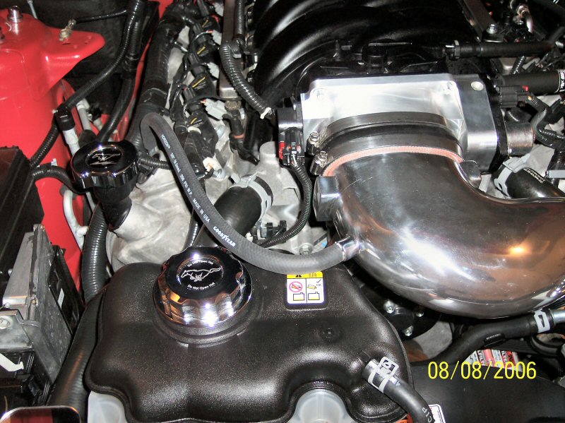

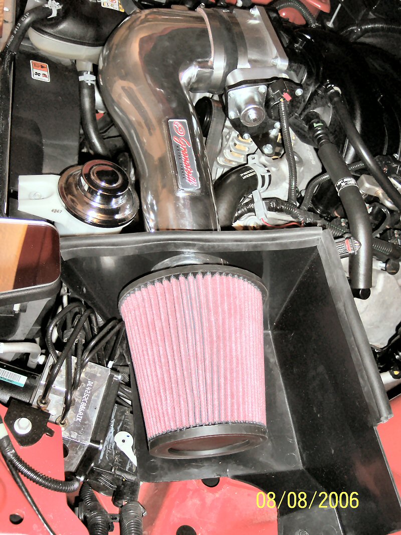

It's finally Here.
Well the unit arrived and I began the installation...Not very hard but there are a few comments to start with.
1. Polished unit has a some pitting. I guess I expected perfection. It's not terrible but we all like a lot of "show" as well as go.
2. The plastic box that covers the air filter is really too thin in my opinion and is an easily breakable piece as it currently is made. Mine came with two cracks but the box looked like it went through a Browns tackle practice.
3. The STOCK breather/vent hose from the manifold cover over to the CAI is NOT LONG ENOUGH. Mine misses by 4 inches. GMS does provides a long tube to replace the stock unit. I mention this because it wasn't in the instructions and I didn't see the piece till later so when yours doesn't fit, don't freak just grab the hose.
Basic install for anybody...
Step 1. Remove old stuff.
Step 2. Put the sleeve on the end of the CAI first and tighten down till it's pretty tight.
Step 3. Put the MAF into the slot with the 2 screws provided. I put a little blue locktite on them.
Step 4. Put the plastic box on with the 1 and only stock screw but don't tighten it down yet. You will want to move it around just a bit until the cai is on. Oh, The front slides underneath the radiator cover to firm it up once you do tighten it down.
Step 5. Slide the cai over the t-body and clamp it down. Make sure you have it through the plastic air cleaner box.
Step 6. Attach the air cleaner and tighten it down. I found it easiest to remove the clamp, get it on and then put the clamp back over. Just a little easier even though you take the clamp all the way apart.
Step 7. Attach the long tube to the cai and the manifold vent , tighten everything again and that's it....Your ready to fire the car up and see what she will do.
Rate: Cai unit....A little pitted and not as polished as I would like.....7 out of 10.
Plastic box..... Not very strong plastic....2 out of 10. Only one screw (stock) to attatch this box so it MIGHT break after time due to vibration...This is just my opinion
Overall I like the unit. It just had a few minor flaws that can be easily fixed or replaced and GMS is shipping them out ASAP. Can't do better than that.
Tomorrow is the real test, starting the car and seeing what type of Gains that I will at least FEEL. That, is after all, what it's all about.
Below is the unit installed and also a shot of that "hose" that I originally missed.
Attached Thumbnails Granatelli MAF--where are you????-morecai_0369.jpg   Granatelli MAF--where are you????-morecai_0371.jpg

Yep, and I knew you would...Your customer service has been excellent and I can't complain about that at all. You also mentioned that you would replace the CAI if I wanted but it's really not bad enough to send back, just not up to what I consider your standards. So really, the only downside to this was the plastic box which is getting replaced. I will let everybody know how it starts and rides tomorrow. Hopefully things will go as smoothly as the t-body went when I installed that.
