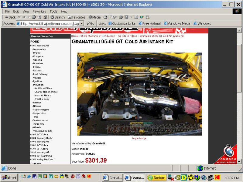

I'm not sure if it's polished or not but the add shows the polished with the price of 301.00 (so that would mean it's the unpolished version). This was just a quick search...I would imagine it could be found elsewhere for even less.

Yah, I saw that one as well. The prices are so variable that I thought something was up with that. It would be nice to see a pic of the satin finish, and to know what the price difference is.
I think the 301.00 at Lethal is the satin because the part number says 410040. The 410040-P is the polished. I found a site that sells the satin 410040 for $289 and the polished for $90 more at $379.
This is the link but I don't know if he actually stocks them yet:
http://www.jdsperformance.com/index....tem&inmake=651

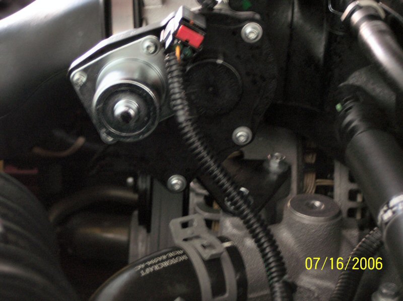

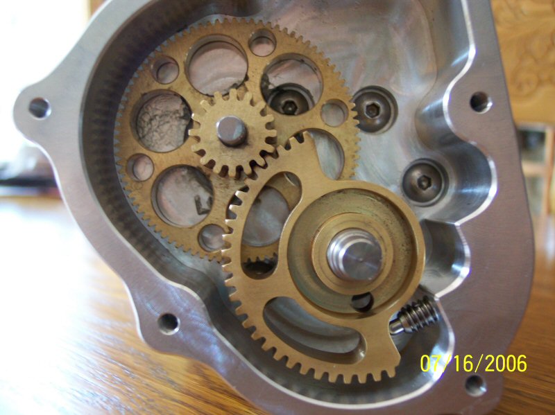

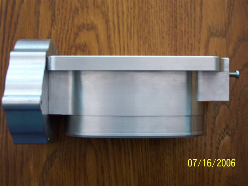

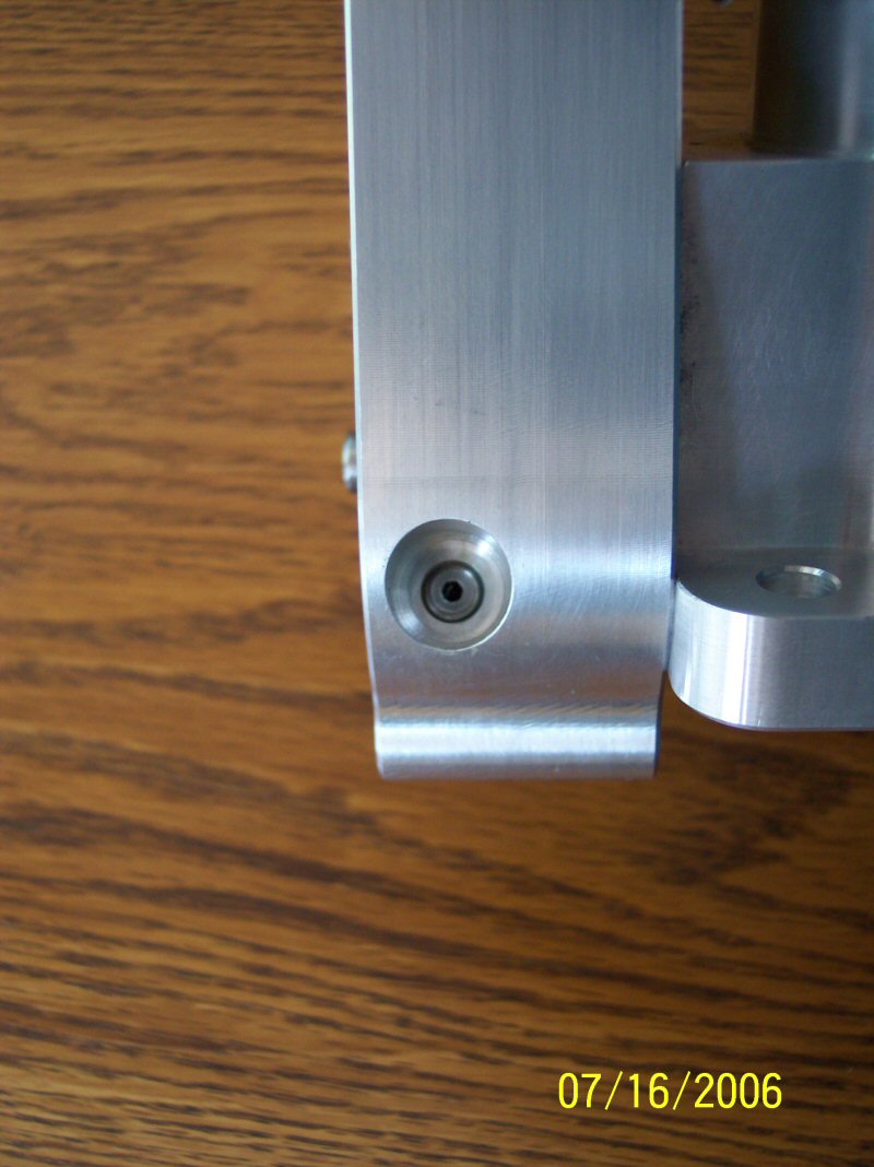

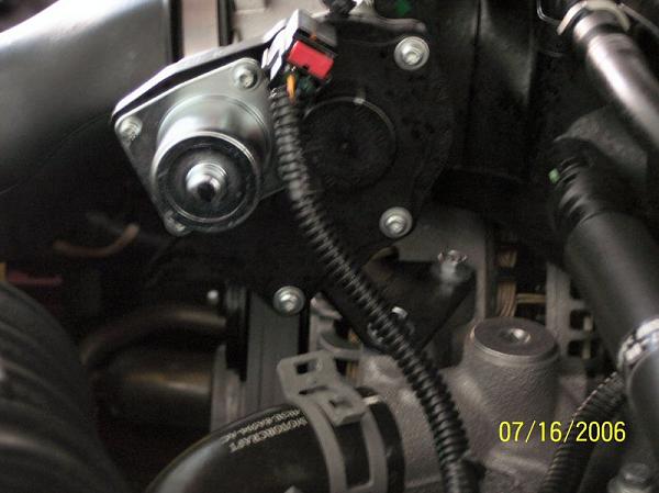

Well the throttle body arrived friday and I am putting it on today...Only complaint (and it is a small one) is that they should provide the little 25 cent allen wrench that you HAVE to use to adjust the blades or at least put the correct size in the instructions so there is no guessing. Oh, I used a 5/64th allen wrench.
Why they aren't pre-adjusted also somewhat baffles me but again, small issues but things you need to be aware of. Adjusting the blades or indexing the unit is pretty easy... Just back the allen bolt out out till it's not touching the gear and then back in till it touches and then 1/4 more turn. That's it and your ready to go to the uninstall of the old unit, removing old parts and then putting them on the new unit before reinstall.
I will get some pictures as I go and hopefully early next week the 410040-p unit will arrive and I will post that as well. The throttle body looks to be very well made with brass gears which look to be as precise as a swiss watch and not some plastic junk I have read about in other makes. The allen head adjuster was a bit rounded as if the mold wasn't very well done or maybe rounded during the initial making of the product. Again, this is not an issue with the product or design. (JR, could you send me another allen head screw just for backup purposes). Oh, I am also suprised that the GMS logo is not on this piece as it is in all of the pictures. Below are some of the pictures of the unit out of the box. Note the allen screw with the somewhat rounded edges, the precise brass gearing and smooth overall appearance.
Attached Thumbnails Granatelli MAF--where are you????-100_0659.jpg   Granatelli MAF--where are you????-100_0660.jpg   Granatelli MAF--where are you????-100_0662.jpg
Old Jul 16, 2006 | 09:05 PM
harleybill's Avatar
Joined: August 26, 2004
Posts: 757

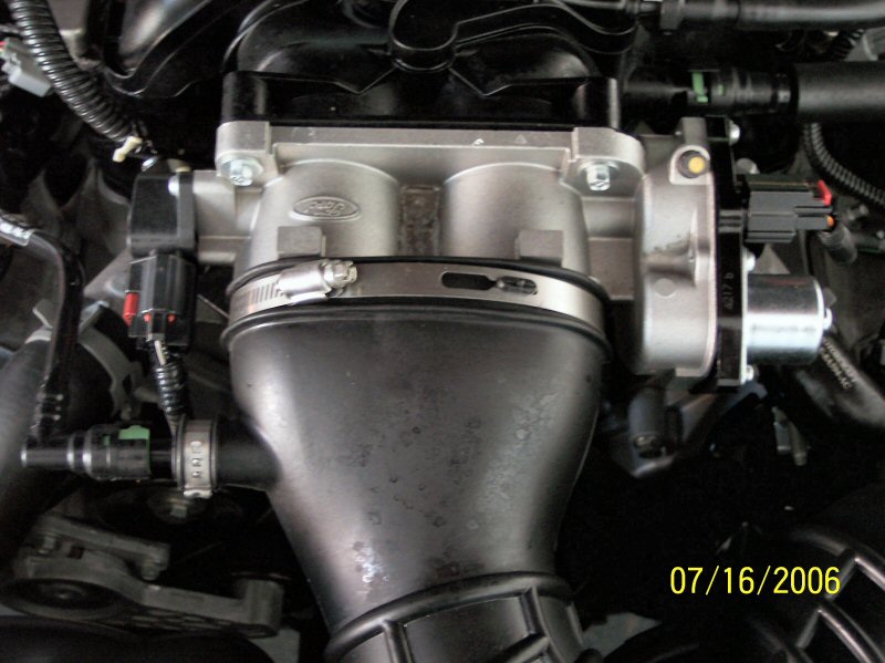

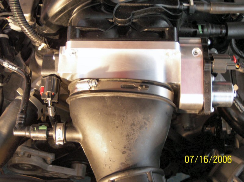

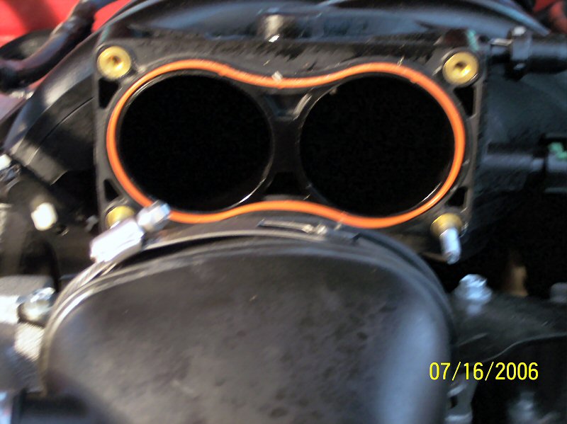

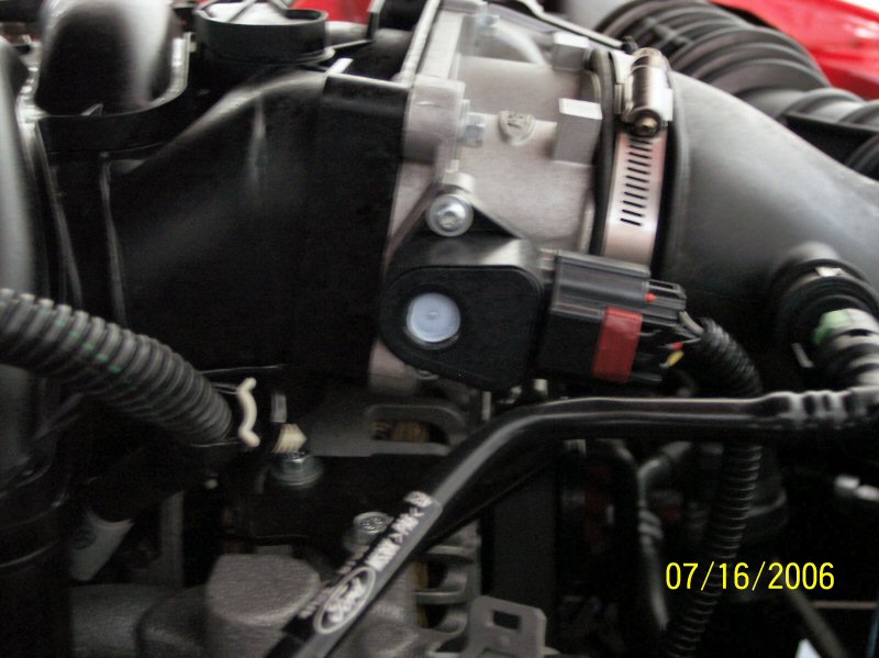

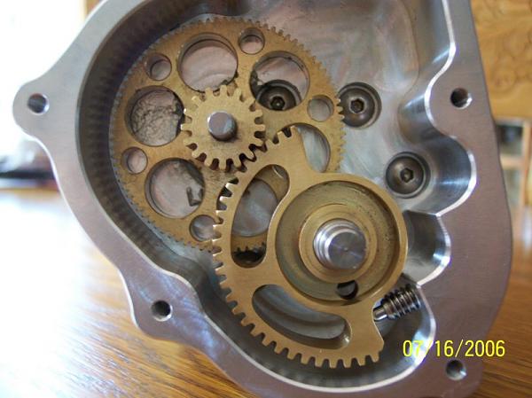

More of the install of Throttle body.
Boy, this turned out to be one of the easiest upgrades you can do. As you can see from my previous post, setting/indexing the blades was the only thing you had to do to the new TB before you started taking apart the original. Removing the original was pretty easy but you will need a T20 hex head to remove most of the bolts, a phillips screwdriver, a 10 MM socket (2 nuts at the bottoom of the TB) and a 5/16th socket. None of this is in the instructions so it's good to have all tools before you begin the project.
Once the blades are indexed (previous post), you then proceed to remove the original electronics connections...This is a simple squeeze and pull the connections, one at each side. From here you just remove the 2 top bolts and the 2 bottom nuts and remove the unit, keeping the little red ring gasket in place.
See how easy it is so far.... Now you just remove the 2 bolts at the left side of the TB. Since both blades are closed on the original as well as the new one, it should just slide exactly on the new one and then rebolt. 1 side is finished.
The second side with the spring and gearing are next. Remove just the 5 hex head screws and don't touch the 2 phillips. SLowly pull this back. There is a spring inside but it is locked in a hole and shouldn't fall out. You might have to twist it a little to free it up but it does come out pretty easy. On the original cap that was covering the spring, just go to the back and pop it out (don't touch the little tabs that look like they need pulled back to get the cover off...Not necessary...You just need to give it a little poke with your finger and it will come out).
Now for the tricky but very easy once explained. You insert the spring back into the new TB just as it was in the old one...There is a hole at the bottom that the spring sits in and therby locks itself in. Slide the whole piece back over the unit and put your 5 screws back in. You were given a spring adjuster that you will now use. Just put the spring adjuster on the spring (remember you have the old cap still off) push down just a little to where you can feel that you can turn it and give it a gentle twist COUNTER clockwise about 1 turn. It will then try and return and lock itself in position. Once you do it you will see how easy it is. Just a matter of doing it. Finish tightening down the 5 bolts if you haven't done so already and then it's time to put back on the car. You only have the 2 bolts and 2 nuts to put back on... Most of these screws were held with BLUE locktite and I would advise to use the same. Slide your air intake back over the front of the TB and tighten. Your all done. It will take you longer to read the instructions than it actually does to install it. Hope this helps and gives others the confidence to do it yourself. In the next couple of days, my CaI/MAS should arrive and I will show the install of that....
Results: Obviously since you don't need a tune for this I didn't have it Dyno'd before hand but I want to say that you can DEFINITLY feel and hear a difference. Quicker throttle and you can feel more power. Below are more pictures of what to expect.
Attached Thumbnails Granatelli MAF--where are you????-100_0662.jpg   Granatelli MAF--where are you????-100_0663.jpg   Granatelli MAF--where are you????-100_0664.jpg   Granatelli MAF--where are you????-100_0665.jpg

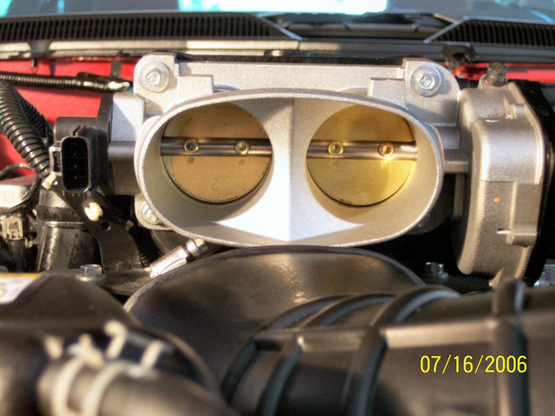

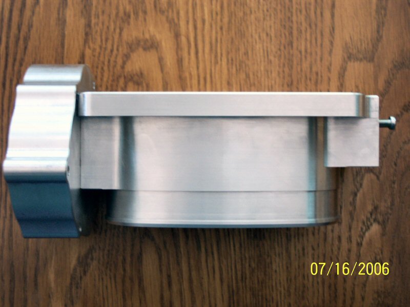

Last of the Pictures of the install.
And the final shots of the install.
1. Front of new TB installed
2. Red tube Gasket.
3. Finished product.
