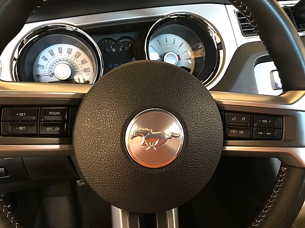

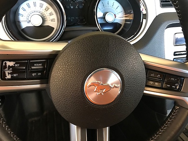

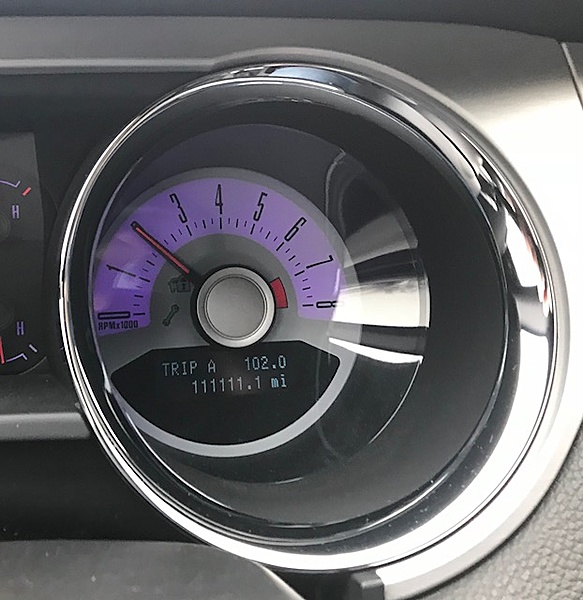

New steering wheel buttons, 111111
Today I put in new steering wheel radio/cruise buttons! Way
better than looking at the old ones ...
pic of old, well used buttons ...
pic of new pretty buttons ...
racking up the miles ...

How hard is it to change out the buttons? I have 1 that is chipped and it has bothered me for some time.

Simple to change the buttons. Check for videos on steering wheel replacement ... This is the
method that seemed the most common:
In short ...
Disconnect negative battery terminal!!!!!
On each side of the back of the wheel, there are circular plastic caps.
These are seated/pressed into the relatively soft foamy stuff of the back of the wheel, and
they pry out easily (maybe blue tape on small screwdriver, and where you will pry ...)
Remove bolts under the caps - one per side - this allows you to pull out airbag module.
Pull out airbag module a little ... I propped mine on a towel, or seems easy to disconnect
the wires.... always handle airbag with extreme care.
Remove radio button module wiring connector.
Push button assembly to center of wheel, snaps out relatively easily.
Push new assembly into place
Check alignment of buttons, reconnect wiring
Put all the rest back.
Two buttons were $110.70, slow shipped.
I did not notice if new/old were any different in color (like, if you just one to replace one
side, and the old side has been out in the air/sun for a while...).
