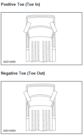

Tomorrow Mike and I are going to install our cam bolts and I'm going to use the digital angle finder to set the camber to the exact "before lowering" settings (-1.0 L and R on both cars). Right now L and R are both around -1.4 degrees (which is actually STILL in range of -.75 +/- .75 degrees).
We will then use some strings on the tires and a little trigonometry to set the toe. From lowering, toe went to about -.50 degrees (toed-out). The range is +.10 +/- .20 degrees. Per the DVD, you don't have to remove the tie-rod end from the spindle to adjust toe... you just loosen the jam nut and turn the inner tie rod. 1 to 2 turns (if that) should do it.
Attachment 1805
Then I'll pop into an alignment shop that offers free alignment checks to see how close we got! I know camber will be dead on... it's so easy to check with the angle finder. Toe should be close, but I'll be curious if we get it in the green.

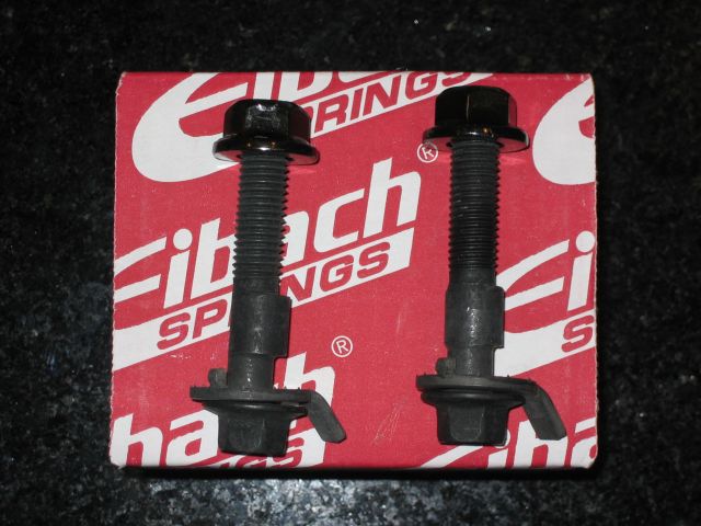

Still have the pic of yours? I'm curious how they compare to mine.
Here's a pic I ripped from the internet. Mine are the same, but in a sealed poly bag in an Eibach box.
Eibach Pro-Alignment Kit for Multiple Fitments 5.81260K
I went to your spring install thread and got the part number. Same part number as mine and they look exactly the same. Mine have the 10.9 marking on the head which is Metric Carbon Steel Quenched & Tempered and the equivalant of an 8.8 hardened SAE bolt (the same as we use at work on our rides). Does yours have the marking, too?
Old Jun 7, 2006 | 09:45 PM
  #1074
Dunno, never looked closely at the bolts. But, being the same PN#, I'd have to say they're the same.
8.8 hardness? Wow, that's stiff.

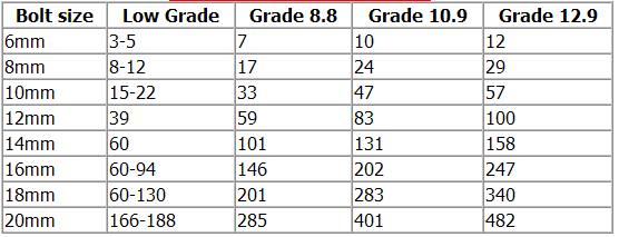

Yeah, I don't know why people worry about going from the 14mm to the 12mm bolt. I'd like to see them break that.
Here are the torques:
Attachment 1807
If the factory 14mm is 10.9, they are over the recommended torque for that bolt (DVD manual says 148 lb/ft - max is 131). So, I can put 83 lb/ft on the 12mm and be safe (cam bolt instructions say 75 lb/ft).
