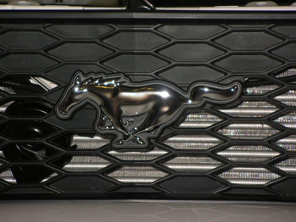

Looks who's back:

What's holding the Pony on? Piece of bubble gum?

The pony is just laying there, waiting for adhesion.
I still have some of the alignment pins left to center it just like stock.

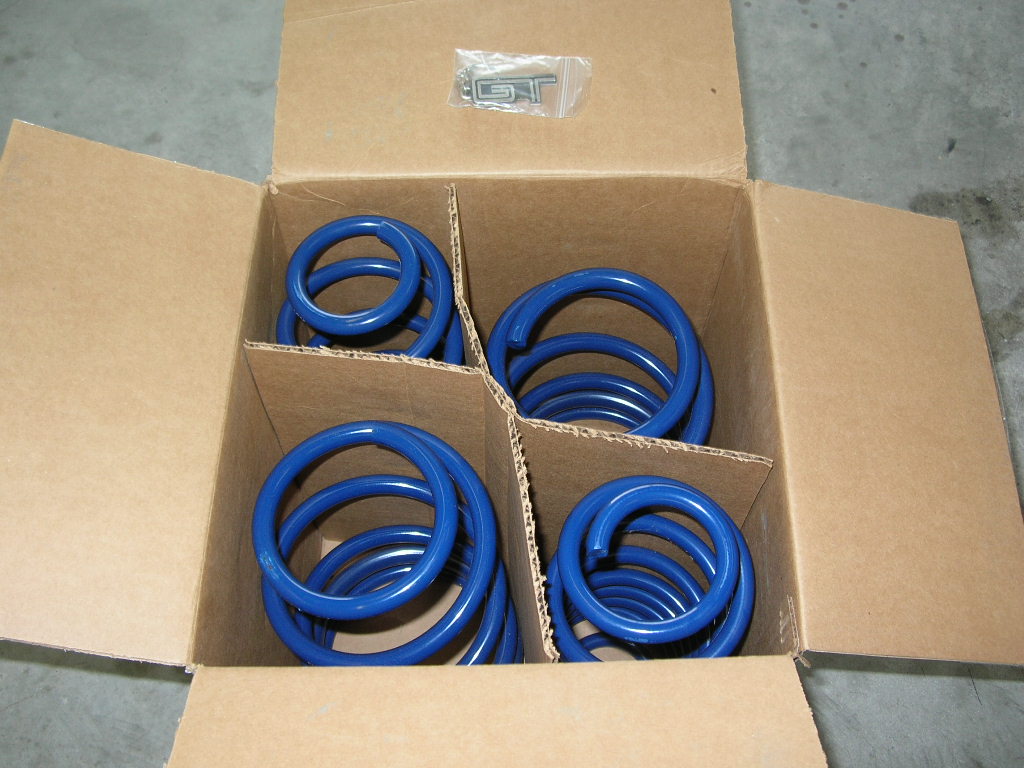

Got a surprise today. And they sent a GT keychain for free (maybe they weren't selling). Did your front springs have a plastic sheathing around one of the coils, Bill?
Do we have a link to your install? Now I just have to figure out how to compress the front springs to remove them. Guess I'll rent the tool from Auto Zone if they have the correct one (it's free).

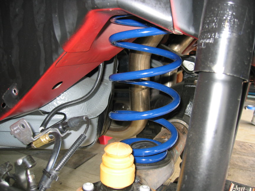

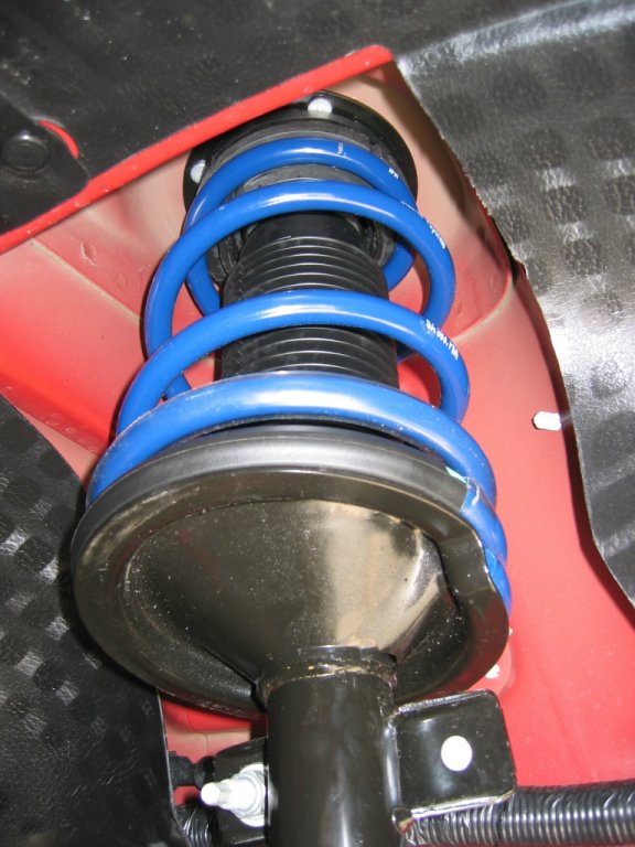

Yes, leave that clear plastic sheathing (insulator) on those front coils. You take off the black ones off the OEM coil and transfer it to the Steeda spring, sort of 'back to back'. (See pic)
Rear spring orientation: Per Steeda Tech, install the TIGHT wound coil UP into the body and the LOOSE wound coil DOWN towards the axle. (See pic)

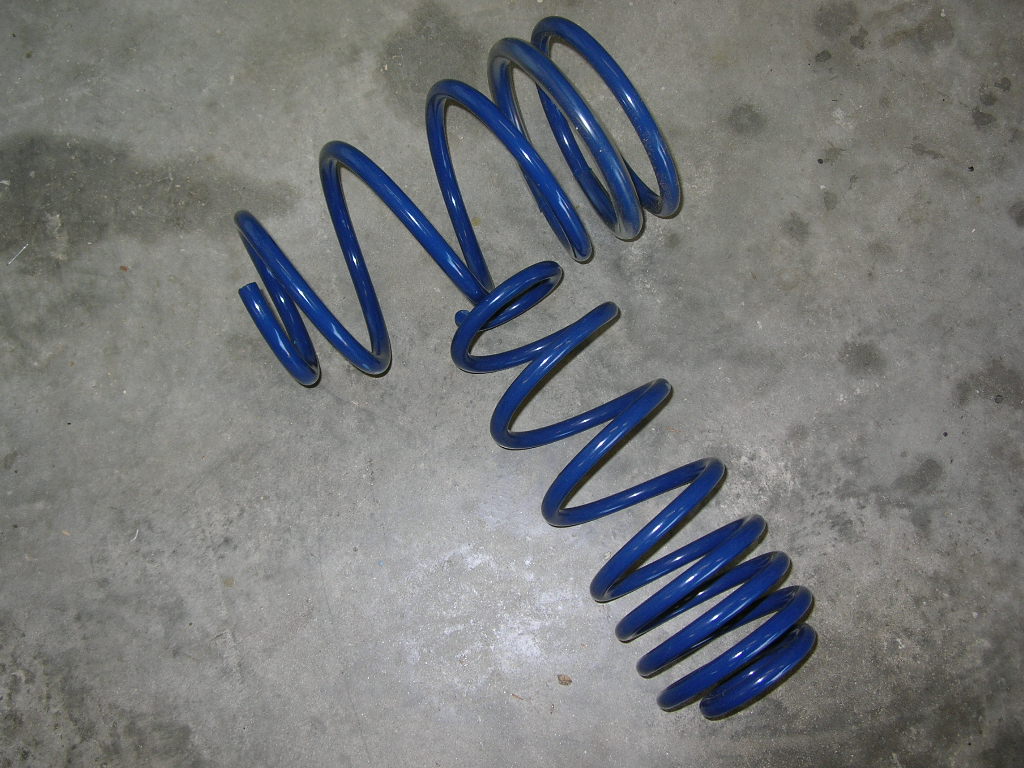

That must be where the coils lay on each other. My box says Steeda Sport Springs, but has part number 555-8206.

That's the correct PN# for the Ultralites.
One sure way of telling you have the correct ones is by looking at the rear springs.
As mentioned, one end has tight wound coils and the other end has loose wound coils. Only the Ultralites are like this.

Still have your instructions that came with the springs? Mine says for part numbers 555-8215, 555-8216. I'm sure it's the same, but the picture of the rear spring has the coils the same all the way from the top to the bottom. If you have it, can you scan and email it? Here is a pic of my springs:
Attachment 255
I emailed steeda just to see what they say.
Thanks for the link to the install. My instructions don't say anything about that black insulator that you swapped from the old springs to the new springs.

Yes, same single piece of B&W copy paper for the installation directions, worthless IMO.
That's why I had you look at your rear springs, the 'Sport' ones are wound even, top to bottom (like illustrated in that paper instruction).
Stuff like the rear spring orientation and transferring of the black insulator, I had to find here in TMS and by calling Steeda Tech Support for verification. So for those two things, it'll be like I said.
If you go by my install link, you'll be fine.
