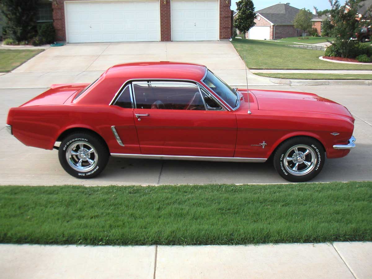

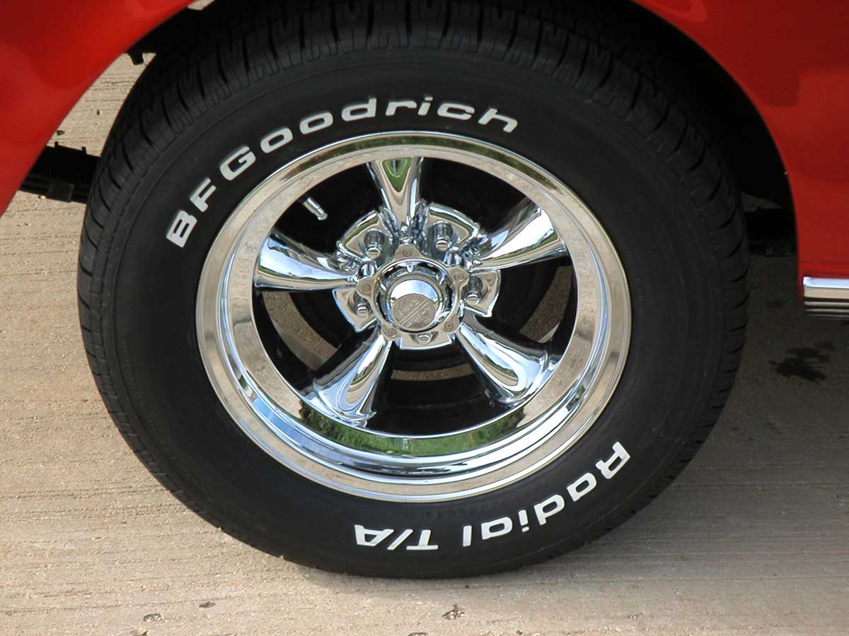

Those both look nice, but if you get custom wheels they will cost!
I have the American Racing Chrome Torque Thust D's in 15 inch.
I got mine at the local Discount Tire. They were able to match the price from the online retailer........
Attached Thumbnails 1966 Ford Mustang Coupe Build Chronicle w Engine Upgrade!-65-mustang-32.jpg   1966 Ford Mustang Coupe Build Chronicle w Engine Upgrade!-65-mustang-31.jpg
