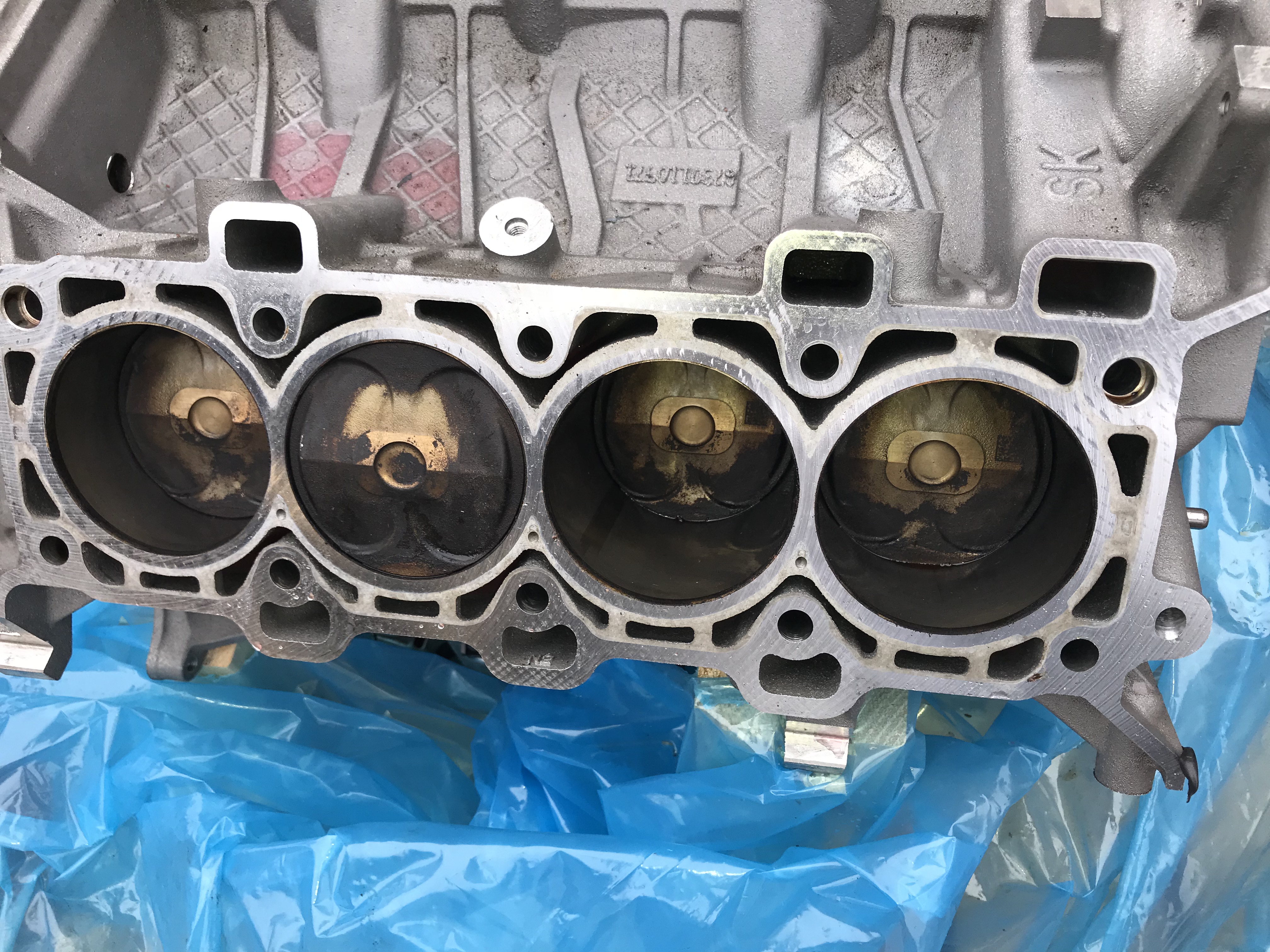

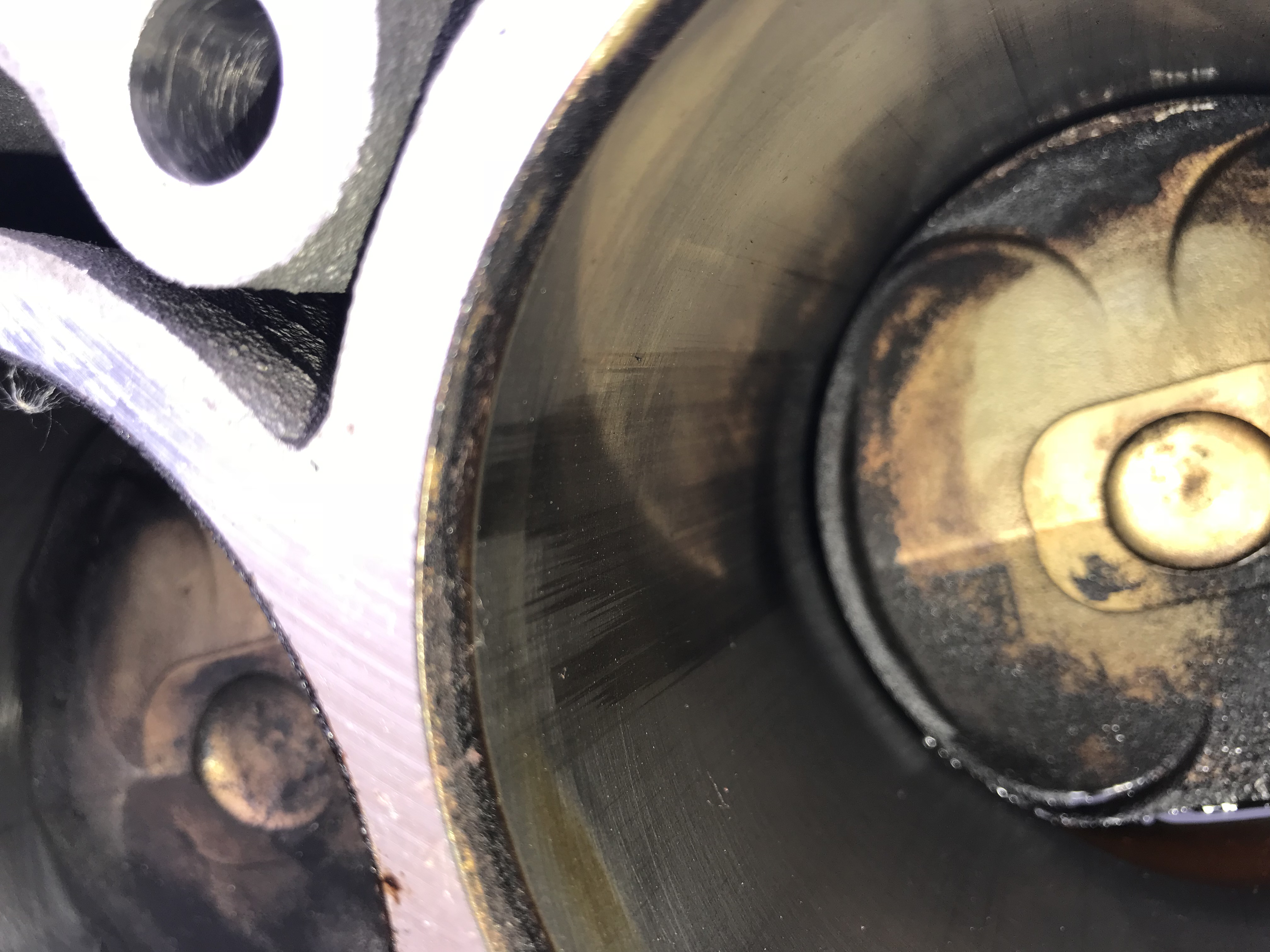

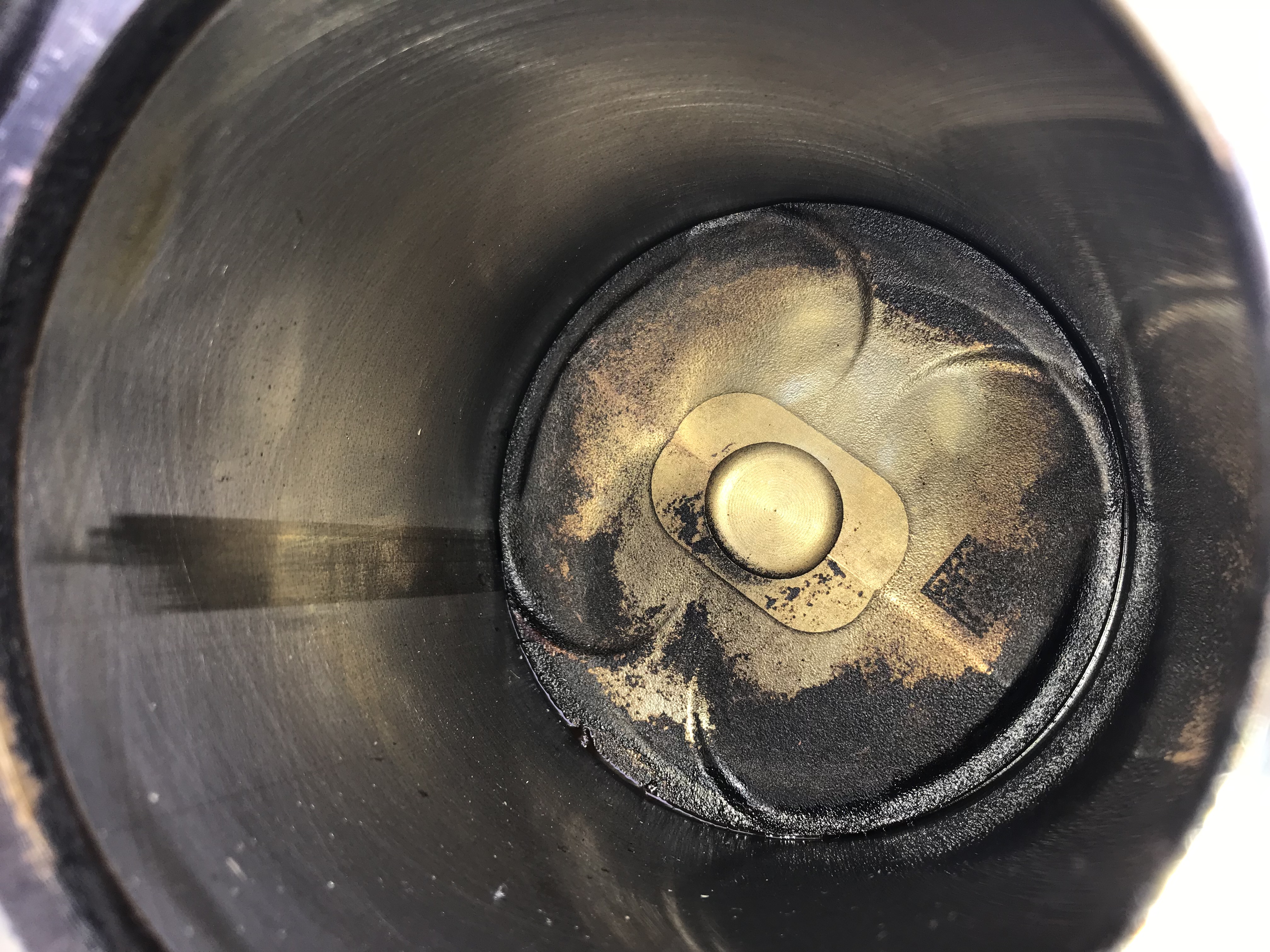

Here are some pics of cylinder #8 and #2. #8 has more scoring. They are in odd locations of the cylinder and no one knows why.

Sad to read about this. I've seen pistons on motors with over 125,000 miles look better than those
