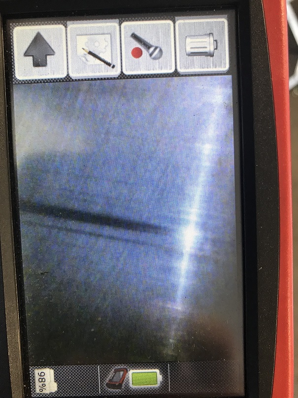

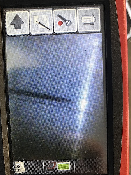

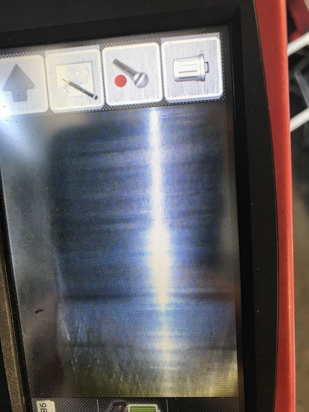

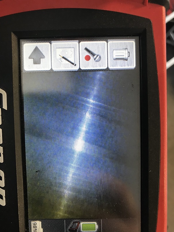

Took my mustang to a different Ford dealer to look at the rattle I'm hearing between 2000-2500 rpm after shifting. If I keep the rpm at a constant 2200 rpm, the rattle stays constant. My original dealer said this was "normal". My vehicle is now at a different dealer who just confirmed that they were able to replicate the rattle and that it seems to be coming from the "right side upper block lower head area" and recommended further inspection by the engine service team. Waiting for an update but at least they confirmed what I am hearing and that it doesn't appear to be normal.
UPDATE: Heavy line tech found damage to cylinders 5-8 from excessive piston slap and recommended a new engine. Ford only approved a new short block. See pics below.

Anyway. Got some bad news. They dropped a scope and found damage to the cylinder walls of 5-8 which looks like excessive piston slap. They will take pics when they open up the passenger side and also will drop the oil pan to see if there are any metal fragments. Saga continues.

The tech submitted his report to Ford and is recommending full engine replacement. No metal in the oil pan. I'll try to find out more on what happened.

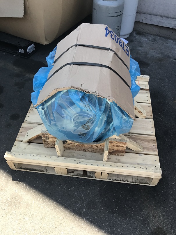

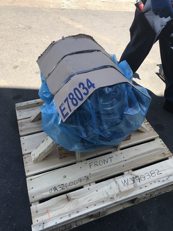

New short block arrived and will be installed next week.

It it is a nightmare dealing with Ford. I ended up buying a 2019 Ram 1500 Laramie and Mopar lifetime warranty which is pretty sweet. I will look at the 2019 Mustang when they start to hit the dealers. I also have better pics of a couple of the cylinders which had scoring in weird spots.
