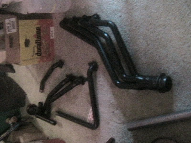

also.. i was going through the garage and the box that the hedman hedders are in. does anyone know if the mustang II headers part 88350 are supposed to be in three peices on the passenger side? bec mine are.There are no cut marks though.. and the pipes slide into flanges (is that the right word?) i dont know how many of you have exposure to hedmans, esp for MIIs but heres some pics

Are those the headers that the shop tried? I thought the problem was the drivers side? Dude, I'd start trying those on your car in a heart beat!! The pipes slip into one another so you can snake them around things in the way. Now, how to connect them, well, you are learning how to weld, right? There should've been some clamps with them too, not sure what kind to use, though, never had those before. Does your distributor have a small module bolted down below the cap? Thats the kind that Ford used for the EFI cars. If yours just has a couple of wires and a vacuum advance module(no wires, just a vacuum line), then thats what u need. A fan clutch is just an attachment that bolts to the fan, then to the pulley, that allows the fan to turn more when its cold, less when its hot. You probably don't have the room for one, though!!! LOL!!! Oh, and yea, the carb could be in need of adjustment.
