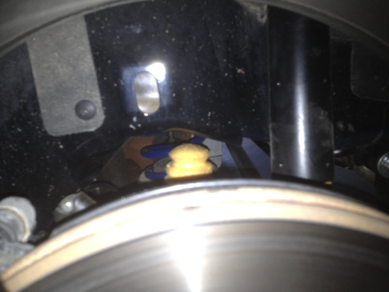

I think mine has way more then 2. Maybe 5 to 6? But the last time I seen it the car was on stands that were on the frame...
Yowzers! After a 230am camera phone light inspection, the bumpstop is less then an inch from the frame!!!! Probably barely enough to get a finger between. Is this normal?!?!?! Maybe that's what my ride is pretty **** harsh too when everyone says theirs is "like stock" lol

Here is a pic through the wheels.
Attached Thumbnails Checklist for Strut/Spring Install...-image-1951627459.jpg

Geez that's ridiculous. I'll bottom out angling up my driveway if that's the clearance. How much can you cut off before anything starts to rub during suspension travel?
