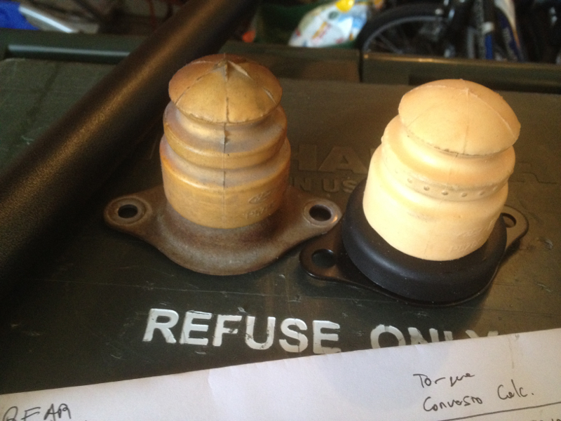

Just finished the install of Koni sports, steed sports and BMR PHB. Took me 4 hours thanks to this thread.
So what is the point of the FRPP bump
Stops? They look identical to the stockers.
They look different too me.
Old Apr 20, 2012 | 06:51 PM
  #132
Hytek's Avatar
Joined: July 9, 2011
Posts: 2,556
From: IL
I believe they're shorter.

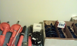

Ready to go for tomorrow!
No, they are the same just different color. Same height and material. Though the FRPP have a rubber base over the metal one. Other than that they are identical.
Lol, that makes them different. Lol
