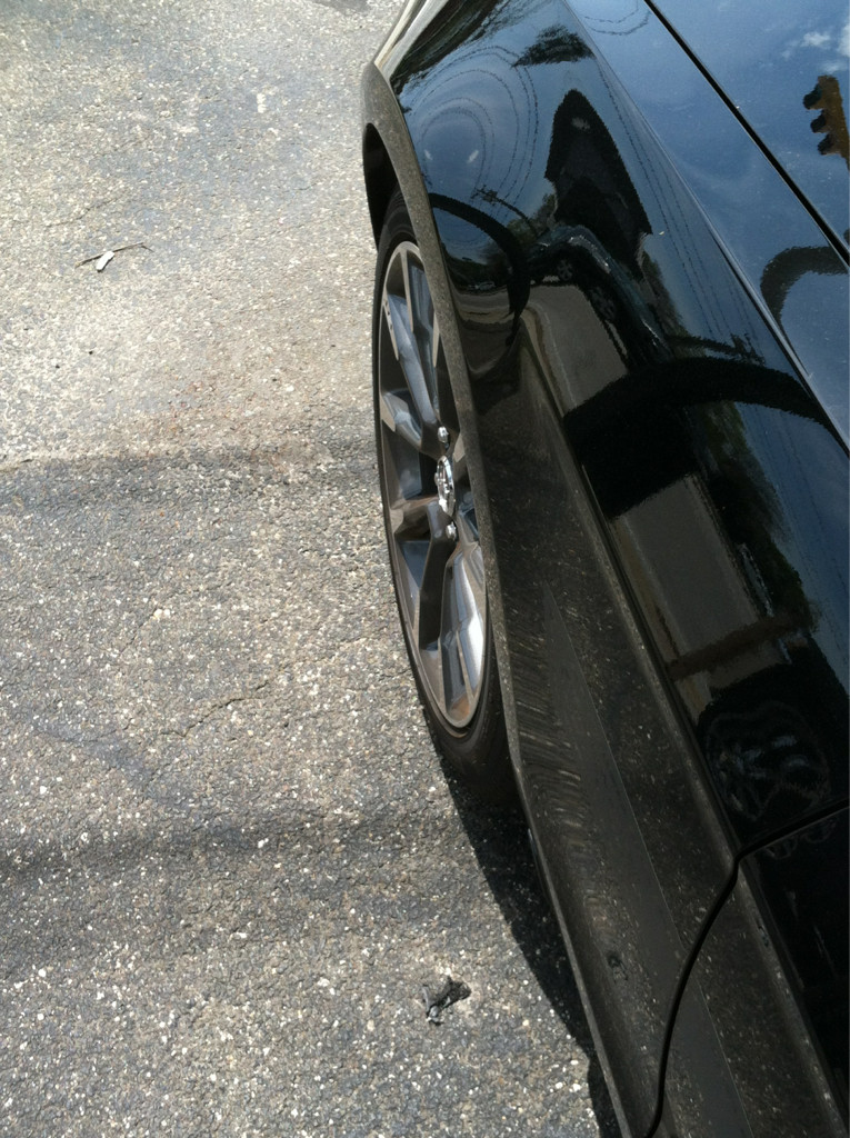

On another note, I put the factory wheels on to bring it in for service and they tuck in very far. Extremely UGLY lol. Also I noticed it to have some serious toe-in it seems. I guess more noticeable with the stockers. Or maybe that's just the way it sits. Check out the pic...
Also what would justify me getting the lifetime alignments vs just one. When would I need to get it aligned again? Is it good for only that car?
If you make another suspension change. Or just whenever as sometimes thing can get out of alignment.
If you plan on keeping the car for a while it's worth it imo for the lifetime alignments, especially with aftermarket suspension and if you have bad roads by you. The last car I had modded the suspension seemed to need alignments once a year. I plan on going this weekend and I'll be getting the lifetime. Besides its like $80 more. And it's only good for one car.
