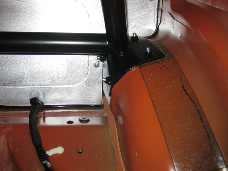

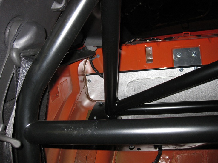

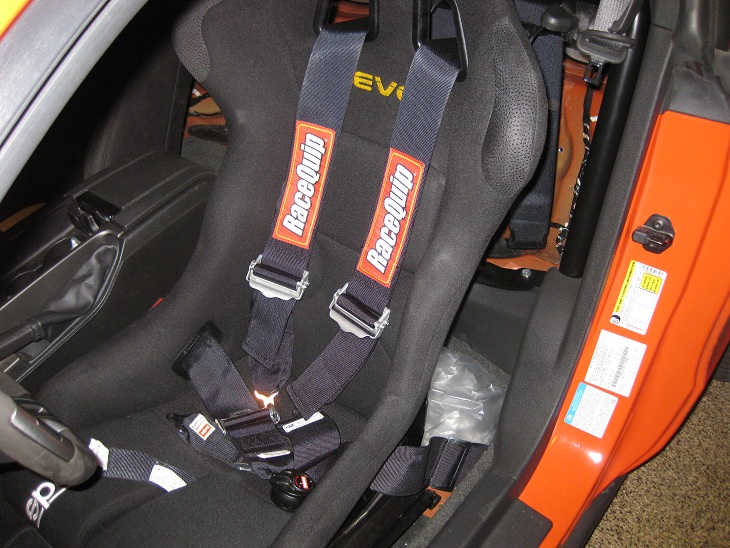

I had my cage installed a couple months ago by my local shop. It started out as a standard Maximum Motorsports 4 point cage
http://www.maximummotorsports.com/store/index.php?main_page=product_info&cPath=309_415_502 &products_id=1289
and then the harness bar and additional bracing were added after the Sparco seat install. Excellent finished product. My fabricator gave the MM cage for quality and design. It saved him time and me some $$. Let me know if you have any questions
John
