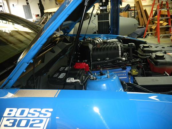

If you dont like the piston slapping sound just put a supercharger on it.

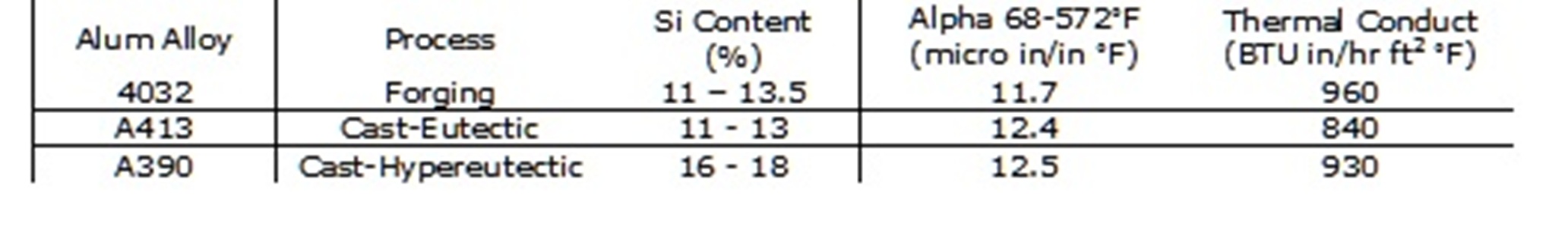

Unfortunately there simply is no technical foundation underlying the observation by some that “forged” pistons make more noise during startup than “cast” pistons. Piston slap, which causes the perceived noise, occurs when excessive clearance exists between the skirt of the aluminum piston and the inner bore of the (usually) iron bore of the engine block. (block sleeves included). Four variables effect this running clearance and thus the production (or not) of piston slap noise-
1. The cold build clearance the manufacturer sets between the piston Outside Diameter (OD) and the cylinder bore Inside Diameter (ID).
2. Piston skirt design and length relative to its diameter.
3. The piston and cylinder bore thermal expansions (material property alpha).
4. The thermal response of the piston and cylinder bore during warm-up (material thermal conductivity).
All of these variables are considered (and tested) by the engine designer when developing an engine. Of primary concern is the piston/bore geometric relationship while at operating temperature. Start-up, as the engine materials go from room temperature to operating temperature and shut-down, as the component materials cool to room temperature are considered but are not as important as the hot running clearance which effects engine efficiency and emissions.
Certainly the designer would insure the piston would not expand too quickly on start-up which could “stick” the piston in the bore if the piston OD grew larger than the bore ID. Same consideration on shut-down. That’s why you start out with a cold build clearance between the two components. The alpha of the aluminum piston is considerably higher (meaning it grows more when heated) than the cylinder bore material. And at colder start-up temperatures, the cold clearance is greater and thus a higher likelihood of piston slap occurring. This cold engine start (at lower ambient temperature conditions found in winter) appears to have the owner’s concern.
Design variables 1 and 2 are solely geometric considerations not tied any casting/forging material characteristic. Variables 3 and 4 DO pertain to material characteristics but the alpha and thermal conductivity differences of our forged piston material and that of a typical cast pistons (either eutectic or hypereutectic cast alloys) are infinitesimally small. See chart below.
In fact, a given aluminum alloy can be either cast to shape or forged to shape. The casting/forging manufacturing operation is a process which can be used to tailor material strength and fatigue properties, but the process does not affect “physical” properties of the underlying aluminum alloy such as alpha and thermal conductivity. Thus there is no underlying tendency for a given piston manufactured by a forging process to be any noisier than the same piston made using a casting process. I would opine the old engine builders who seem to harbor this thought are inadvertently comparing engines which have differences in design variables 1 and 2 and thus not an apples to apples comparison.
I am of the opinion the design cold build clearance we have in our engines is on the order of 0.001” diametrical, loose. This (relatively tight) build clearance would tend to limit or attenuate piston slap during a cold start up. I have been told that during development testing the engine/piston design engineers experienced exactly the same noise phenomenon as reported here by some owners. Post teardown inspection showed this slap noise did not cause any piston/bore durability problems and the noise stopped immediately (as owners have reported) once the engine block coolant got to about 180°F. It was like someone flipped a switch on the noise, just as reported by owners hearing this in their cars.
