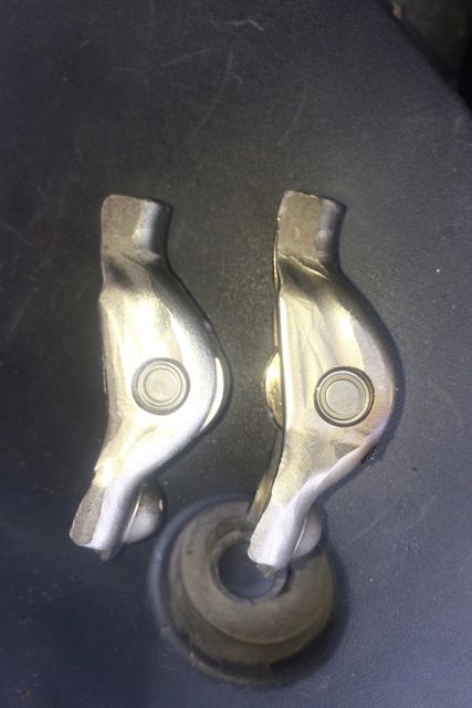

**solved** failed roller rocker
I pulled the valve cover and immediately saw the problem. The front intake roller rocker (#3 cylinder) bearing had failed, causing the roller to come off its axis. I was able to remove the rocker WITHOUT compressing the valve spring. Luckily it had not previously come out, and bounced around the cylinder head causing additional damage. Top side of rocker had grooves cut in it from the cam slamming into it The cam lobe had a little discoloration, but no scarring that I could feel. Compressed the valve spring and slipped another rocker in, problem solved. Soooo glad I didn't run her any more than I did. Many of the so called ford specialist mechanics told me I would not be causing more damage by running another 1000 or so miles with various engine additives to see if they would free up a stuck lifter (lash adjuster). They were WRONG.
Glad to have my baby tip top again, but not exactly filled with confidence about the remaining 23 roller rockers. Might have a few standing by for the future.
Here are a few pics:
You'll see the failed rocker on the bottom/right, with the grooves cut by the cam lobe visible in the pic of failed rocker on bottom.

You mentioned the cam lobe was discolored. Watch it closely for fretting and spauling for a while. There is an outside chance its heat treat and case hardening may have been damaged. I'm not saying it was, but just pay attention to it. If you don't want to pull the rocker box, just keep an ear open, cut your filter to check for steel filings and do oil analysis for a while.

I fully expect to see metal filings in the filter after seeing how the top of the rocker was ground down. Gonna get that oil out of there sooner than later
