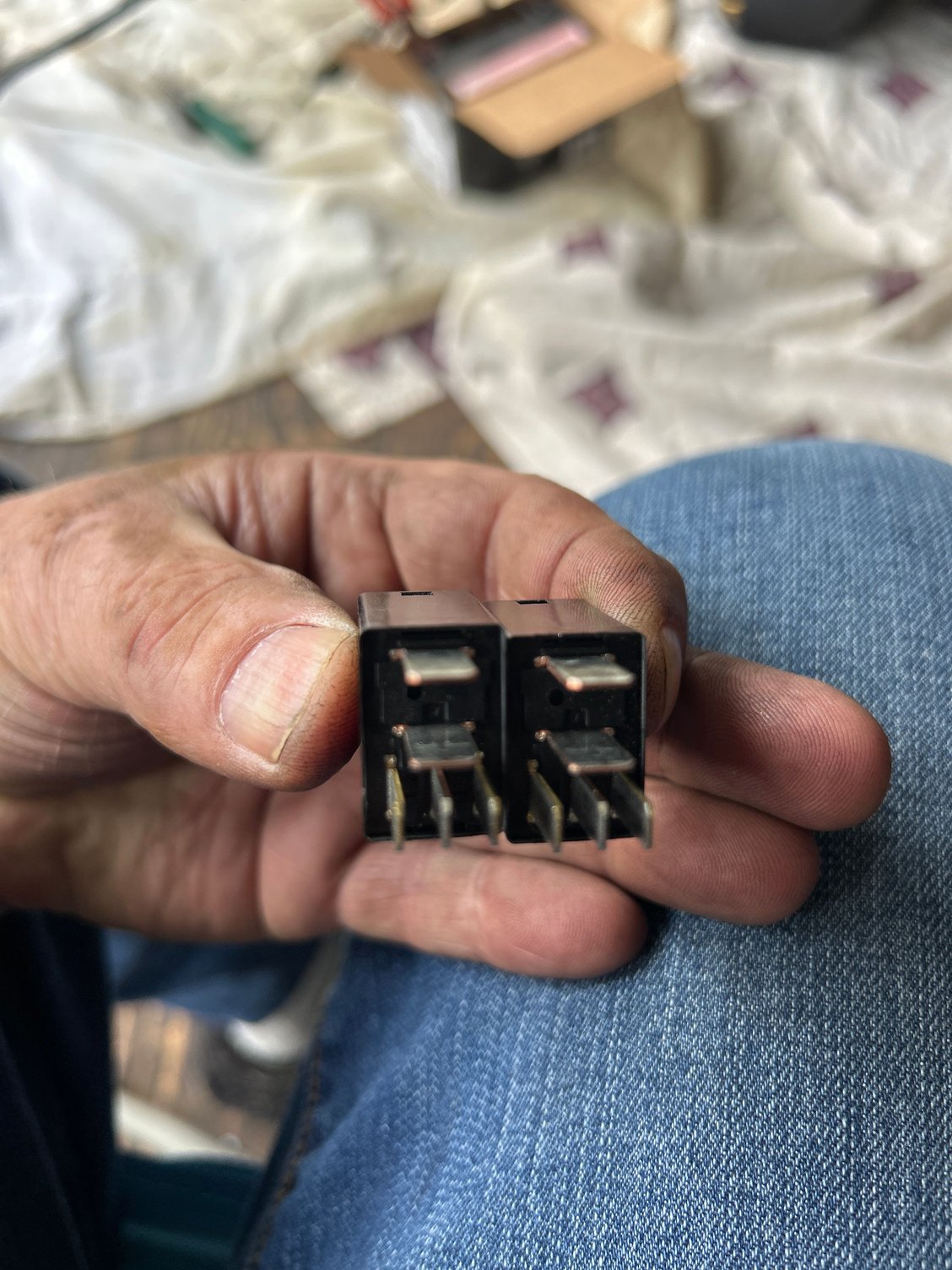

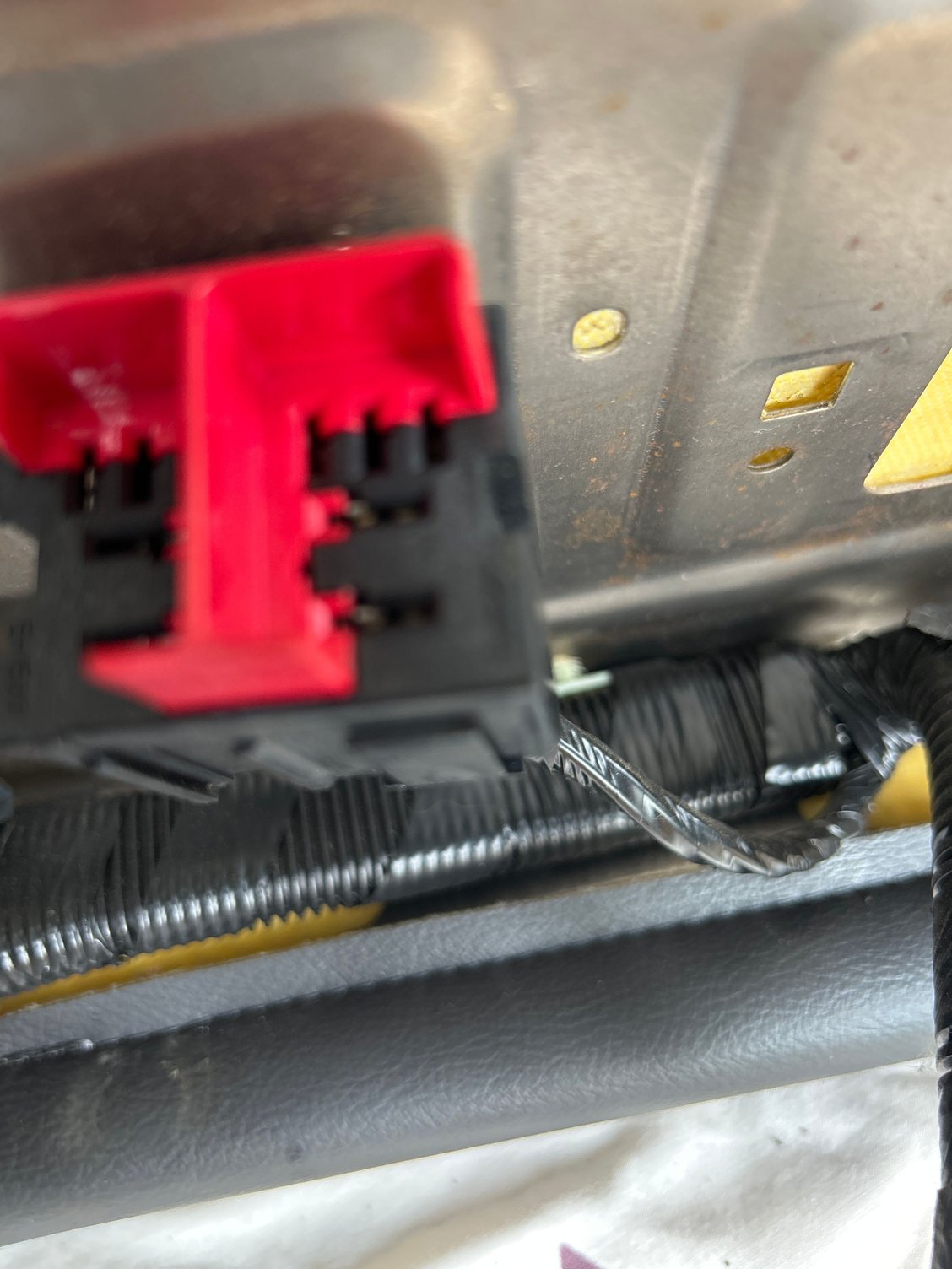

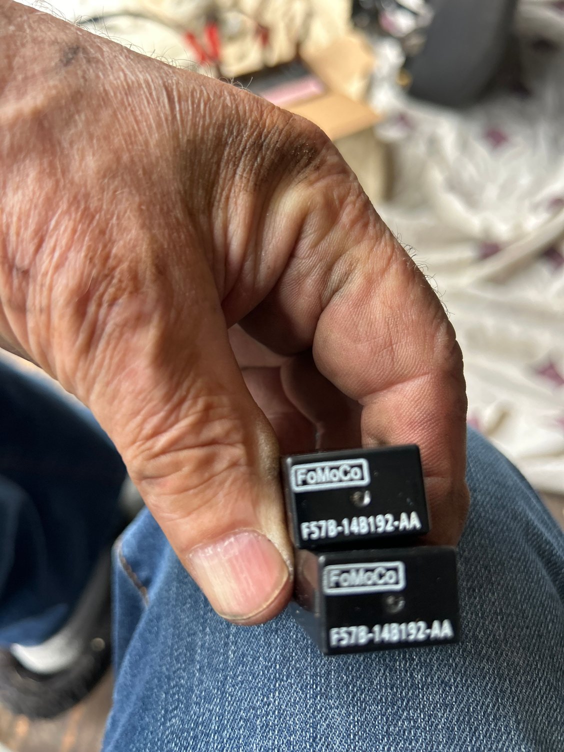

So, apparently my seat slide button somehow got jammed (probably by my leg) in the full rearward position,stuck, would not move. That forward position on the switch is the only action that won’t work. Fast forward to today, I have the seat out and checked the seat motor function at the electrical coupling that goes directly to the seat motor with electrical clips and sure enough, it works as it should. I’ve bypassed all other switches and what appears to be 2 relays side by side under the seat. My question is , can I check these relays before I start buying new ones and throwing parts at it ? WILL these relays fail before a fuse if the switch is jammed in the seat rearward position?

I Believe The {Under the seat} Relays are For The Heated Seat Function Only.
