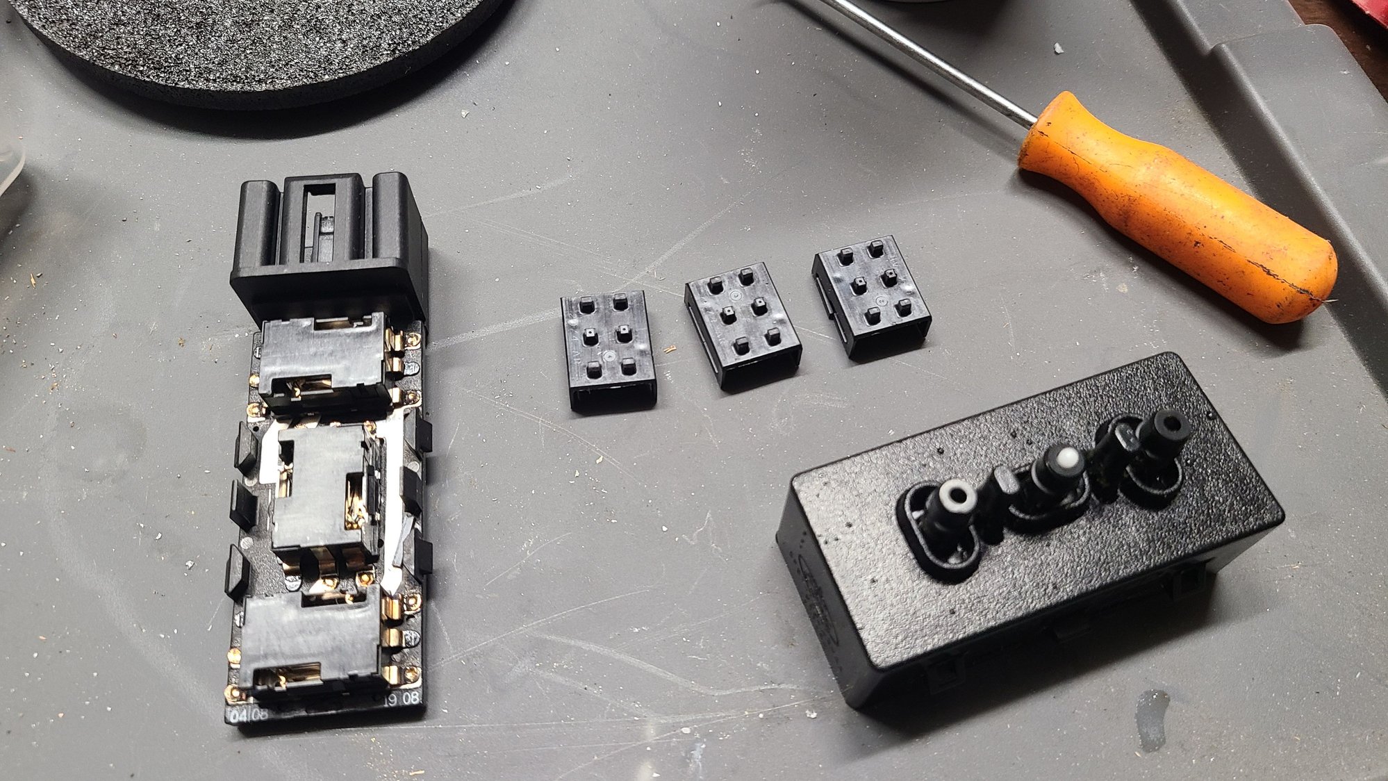

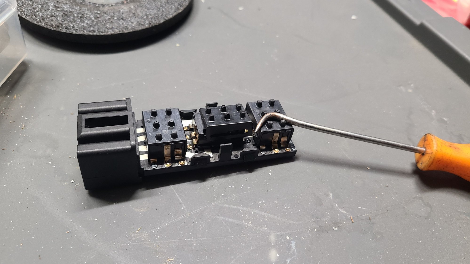

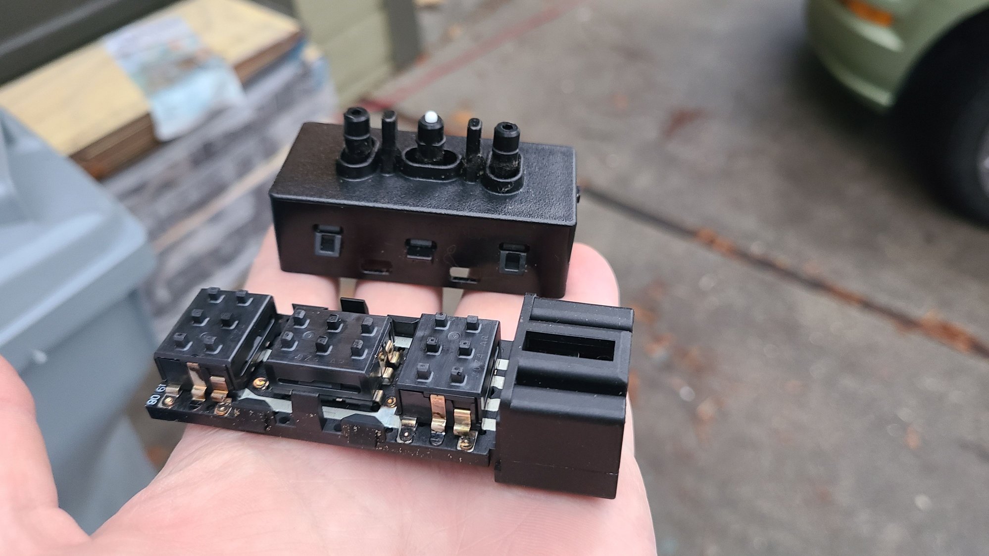

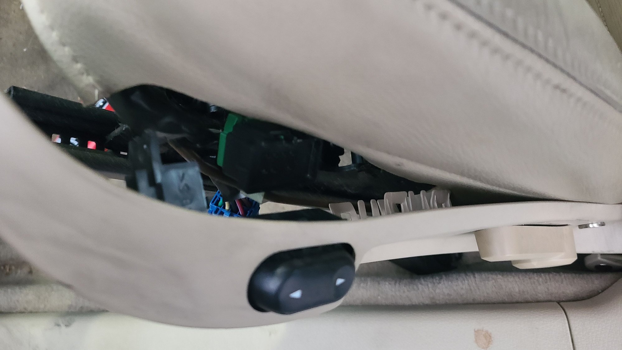

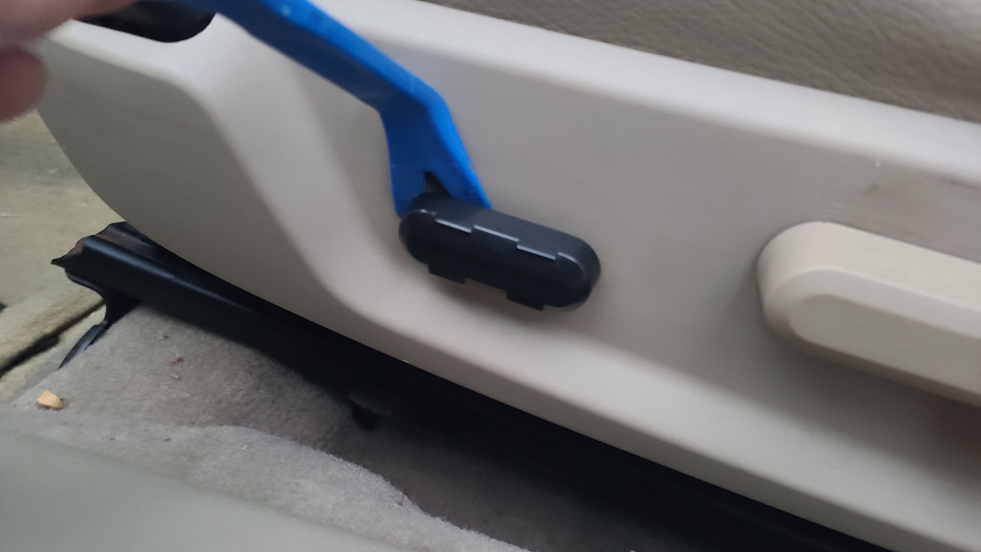

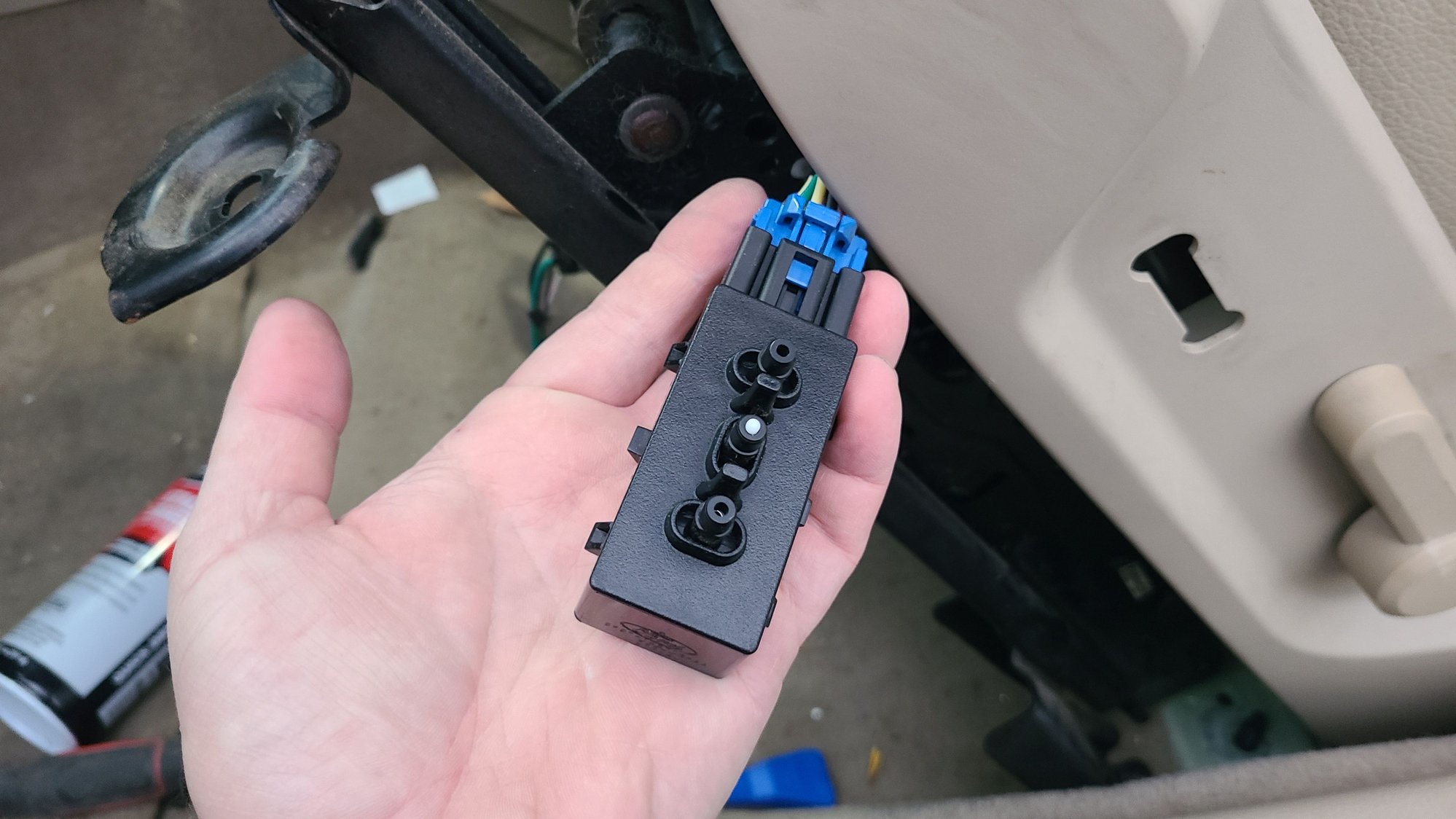

Thanks everyone for all of the help. I was able to get it working again.
Looks like it was simply the switch itself.
The other posts I read, and videos I watched, said to fully remove the side panel. However, that seemed unnecessary.
I was able to just pop off the handle using a trim tool.
Then I only pulled out the front most clip. I could then reach behind it enough to undo the four tabs that were holding the switch in place. I found it easiest to undo the top two tabs, and then push on the switch to keep them from reclipping, while I undid the bottom two.
After that, the switch was very easy to remove.
I undid the clips on the side of the switch to open it up, and then used a pick to undo the switches themselves. They just clip on, so a little prying outward on the sides popped them off.
Sprayed it all throughout with the electronics cleaner, let it dry, and then reassembled and it all worked again!
