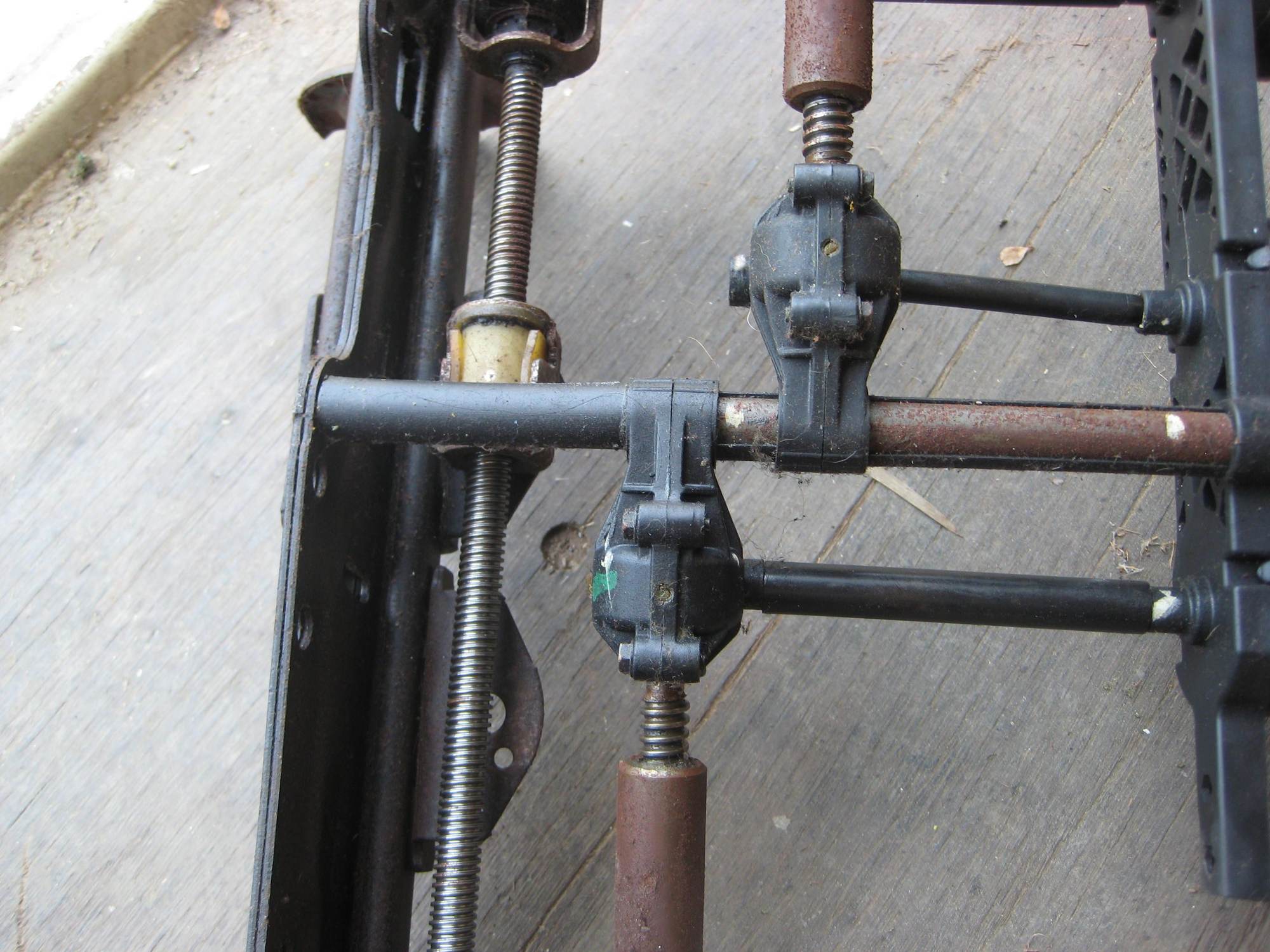

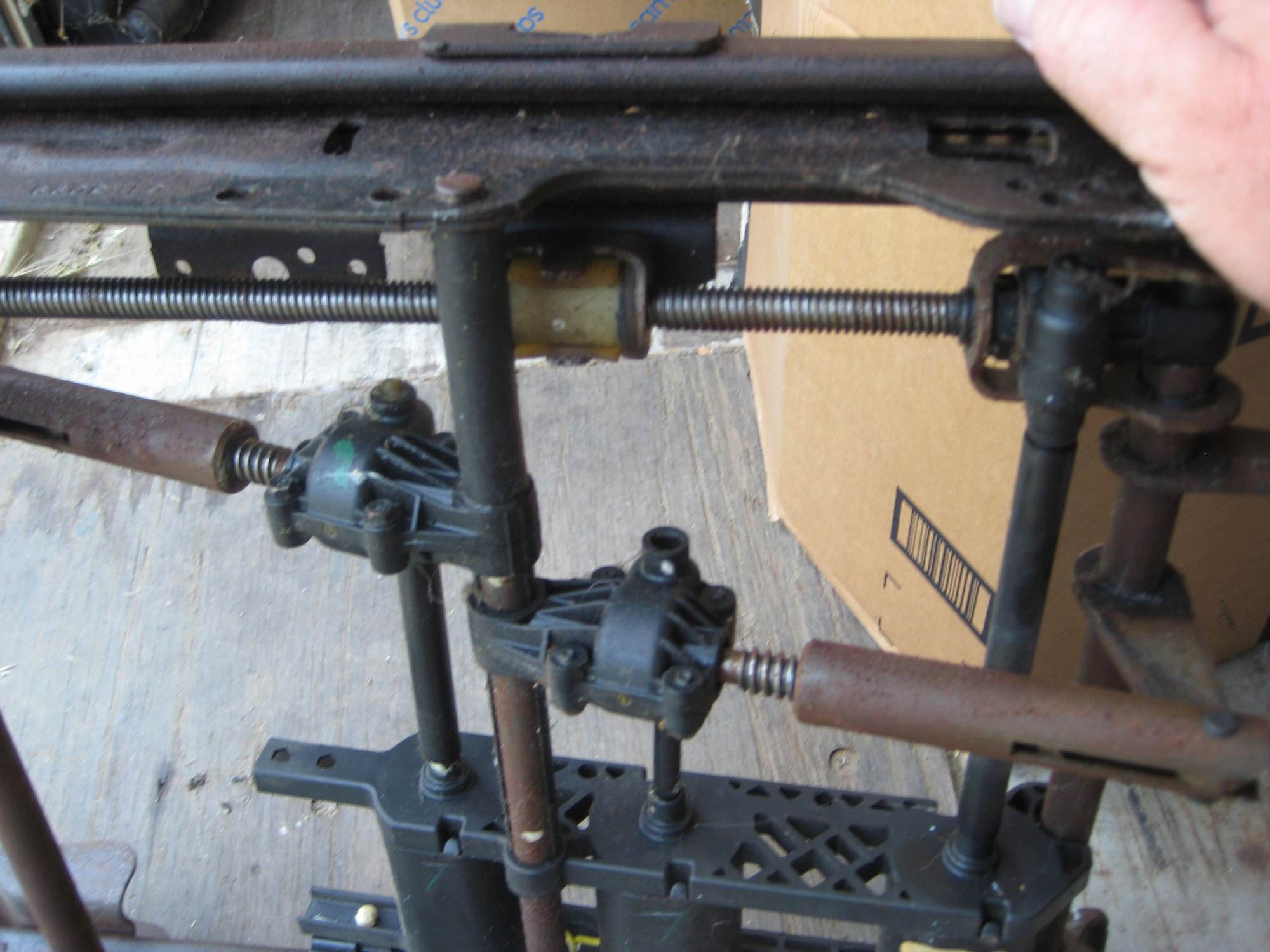

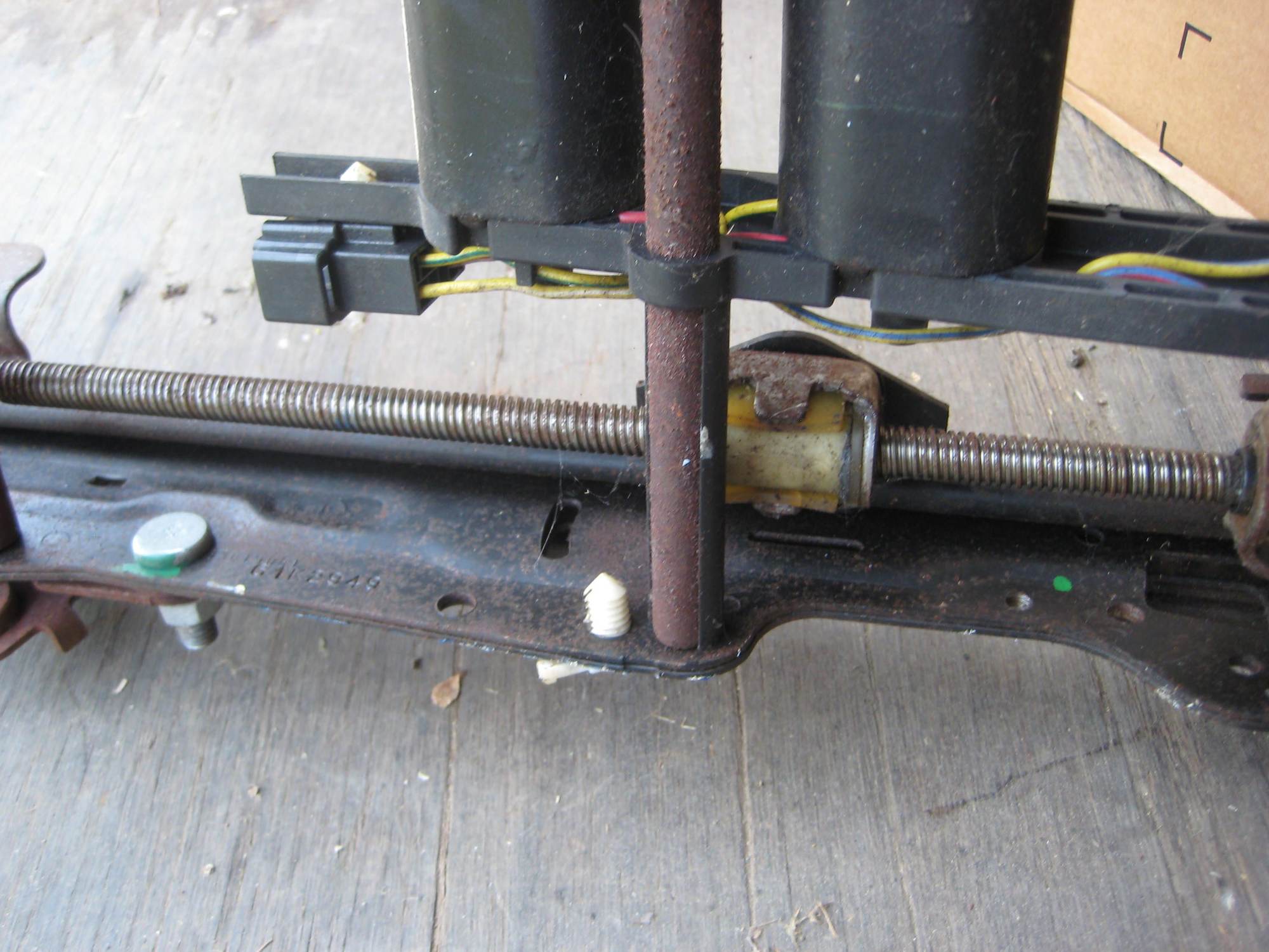

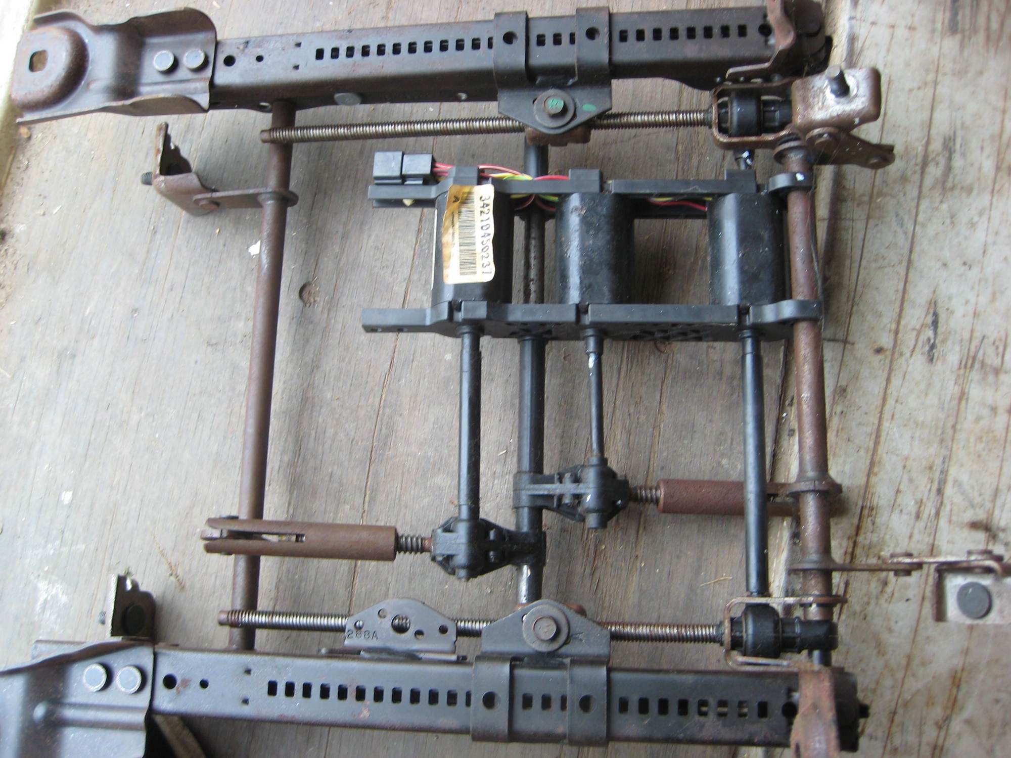

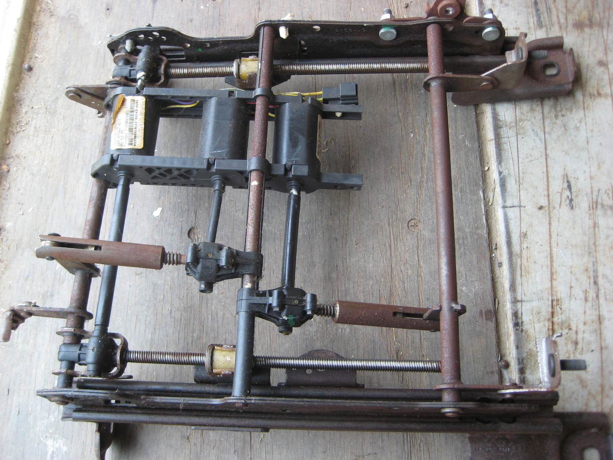

This Maybe Helpful. I Had Forgot I Had a Bad Seat Track Out in Storage. It Was My Intention to Try & Repair & Have as A Spare For My Gt-500 or Sell Down The Road. Anyhow Here Are Some Pics Which Will Show Better What You Have!
I Wish I Had Tore Into as it Likely Has Same Issue as Yours if Track is Bad!
Could Be Handy if You Seek Out a Repair Shop So You Can Show Them Setup.
This is Exact Track You Have!
SEE COMMENTS UNDER EACH PIC!
Kc
TOP VIEW
TOP VIEW Note Three Cable From Motors to Transmissions. Gears in Trans Can Shear! Cables Can Twist & Bind Up!
Transmissions Also See Speedo Type Cables From Motor To Trans.
Bottom View
Bottom View
See Fore & Aft Gear at Top Just Off Center
Fore & Aft Gear Other Side!
