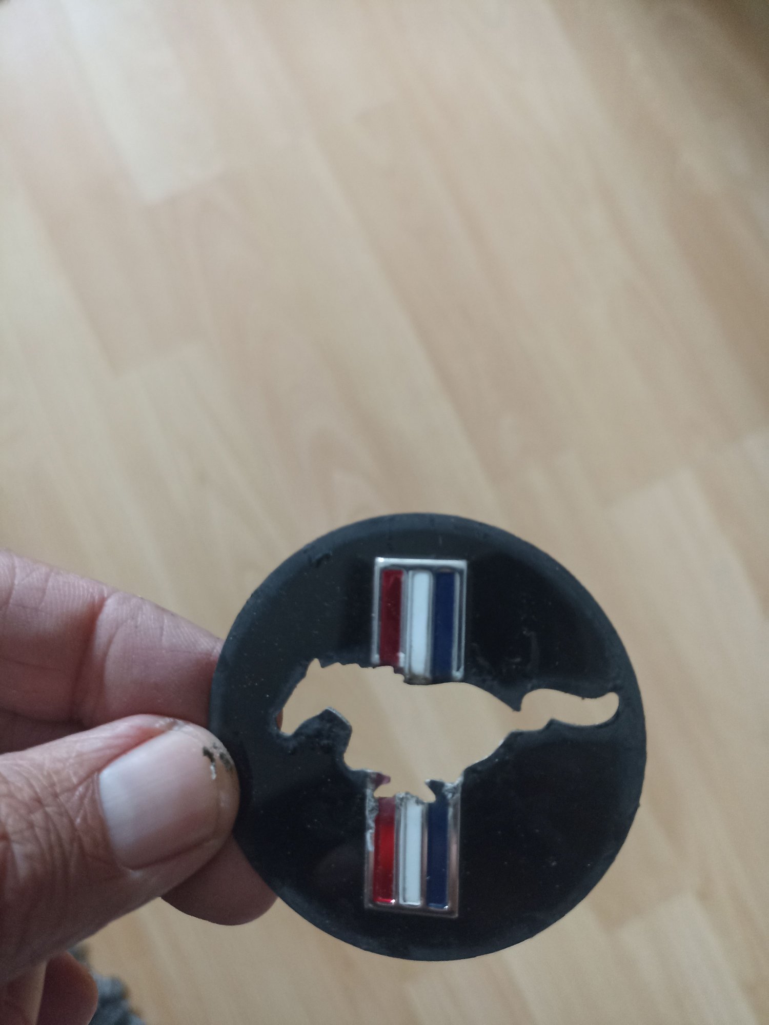

I have the following question: The Pony emblem on one of my wheel hubs came loose and I lost it. The emblem is made of thin sheet metal and is only glued on. I've already searched online for exactly this sheet metal emblem, but I only get stickers shown. My question is: What other possibilities or alternatives are there? Could I use a cap for my rims? I have the original 18-inch Ford Mustang rims from 2011. I just think it looks nicer with the emblems. Of course, it's not absolutely necessary, but it just looks better if I had these emblems.

Now Your Cap Can Be Repaired. Using GOO Gone or Lighter Fluid on the Chrome Cap Will Remove All The Old Adhesive. Now The Insert is Not as Durable as The Cap So Very Gentle Cleaning on That Would Be Necessary or The Paint Will Come Off. Getting All The Adhesive off The Metal Insert Would Be a Real Booger So Basically if You Can Clean Well and Scuff Some of The Area Without Going All The Way To Outer Edge and Also Staying a Bit Away From Center Cutout and it Should Stay Put with Some Good Gorilla All Purpose Adhesive or the Like.

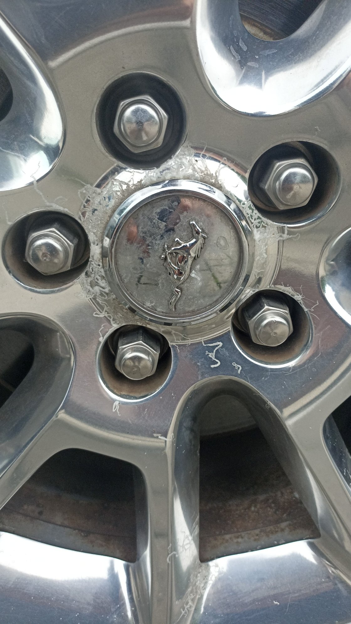

Looking At Your Cap Again Makes Me Think Somebody Glued Actual Cap To Wheel. The White Residue Seems Out of Place.Tire Store Maybe Pulling a Fast One. If Tabs are Busted You Will Need a New Cap. I Would Remove & Inspect All Caps. They are Usually Pretty Snug and They are Best Removed By Pusing From Behind. a Thin & Narrow Paint Scraper Might Work To Pull From Front But Risks Scratching Wheel. Just an FYI!

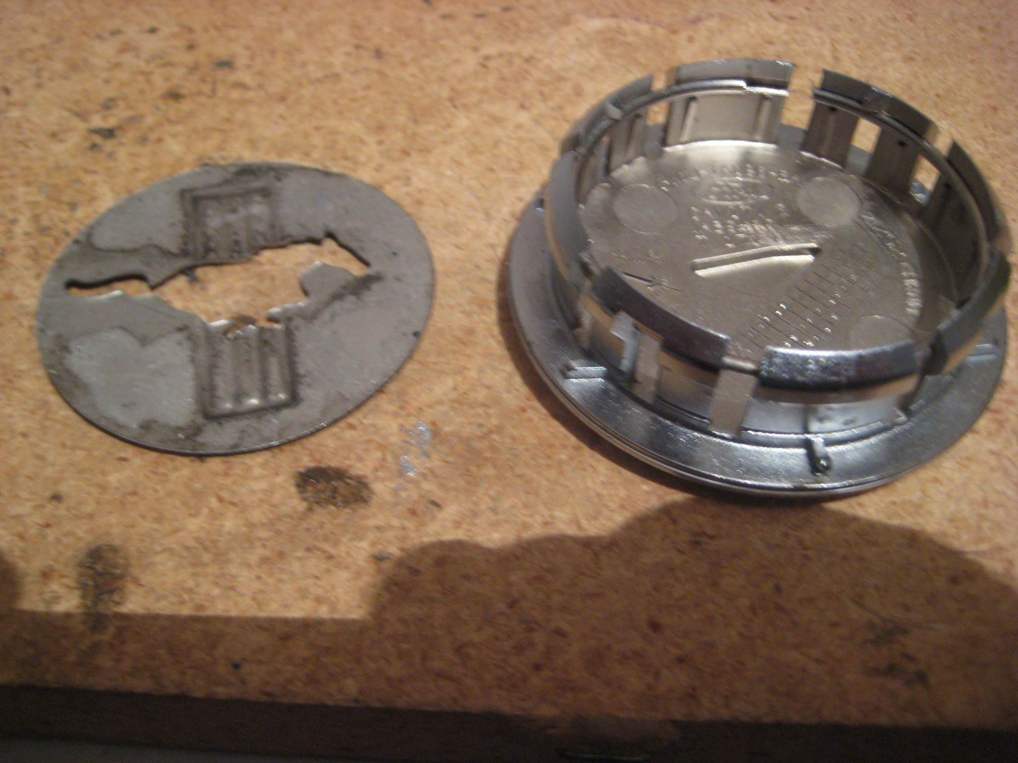

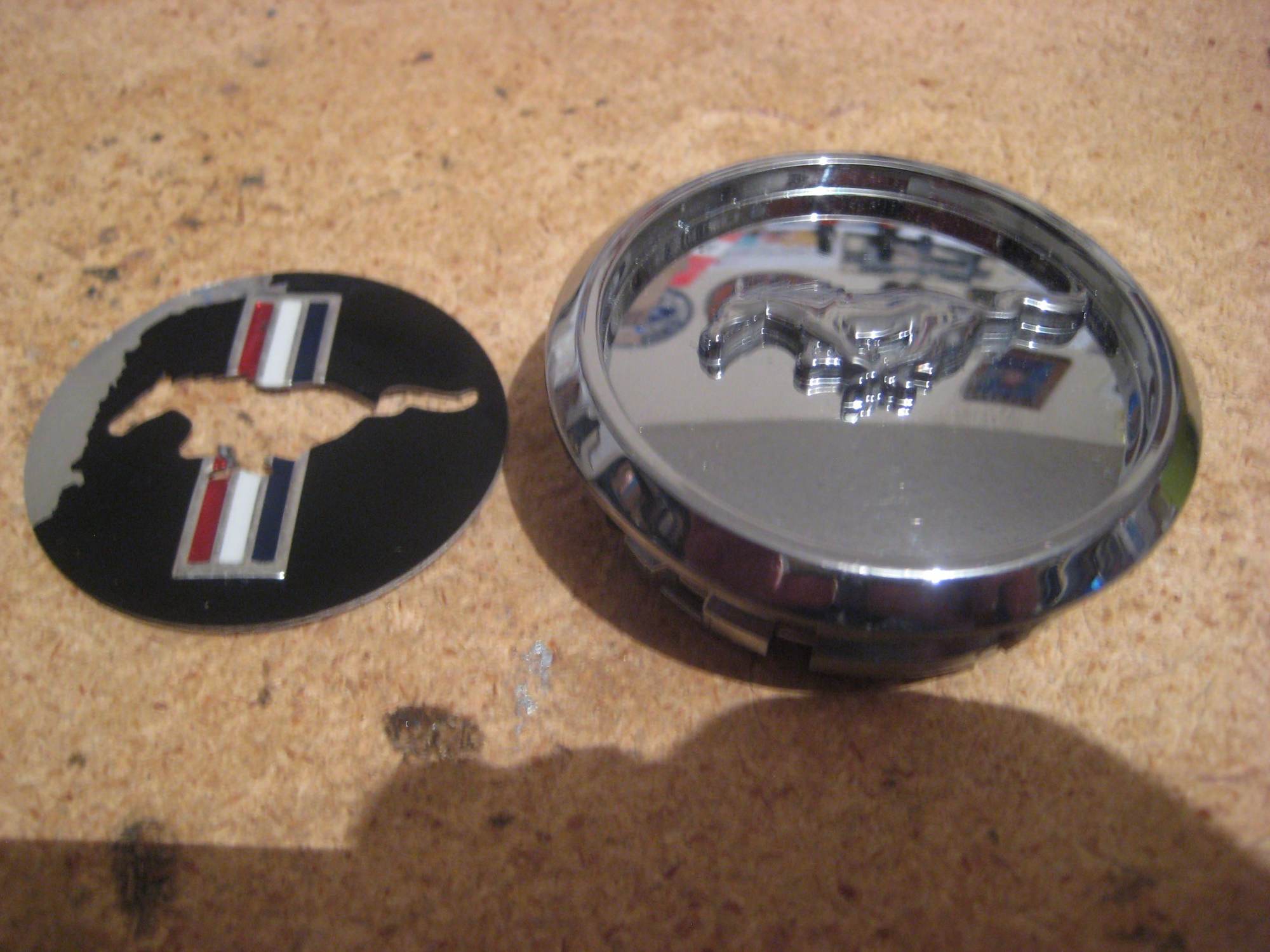

Here is Actual Cap & Insert Style You Have Shown Apart! Just Happen To have!
A Good Clean on The Chrome and They Really Don't Look Bad if You Want to Save The Bucks!
Thanks for all the info, that helped me. The diameter of the emblem is 56 mm. I'll search the internet thoroughly.
A silly question from me, sorry, but is there perhaps another way to glue on a silicone emblem or something similar?

It is Really Up To How Much Effort & Time You Want to Put into it. The Short Answer on Reusing Original Caps Would Be Making a Level Surface By Grinding off Chrome Pony or Filling Inside of Cap with Enough Epoxy To Level and Install a Sticker. The Time & Money Involved as You Exparament Adds Up Kinda Quick. It's Really All About How Nice You Want the Caps. It's Really a Craft Project & Let Your Imagination Be Your Guide!
