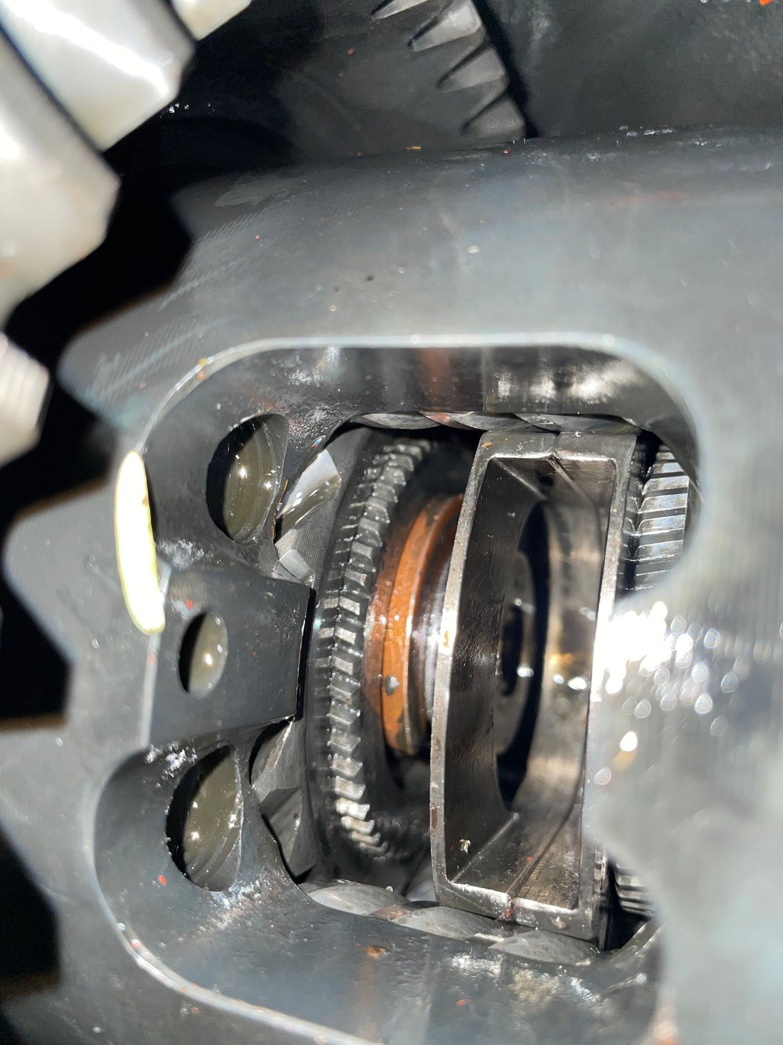

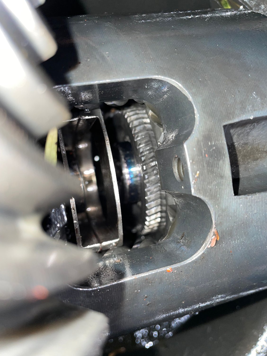

On the Orings...Ford Put those there really just to hold the C clip so it wouldn't move or fall out....I honestly have never found one in any of the probably 200 plus rear ends I have removed axles from and I never put them back because they aren't needed and don't cause any issues without them or make any noise. You can use them if you like...won't make a difference either way.

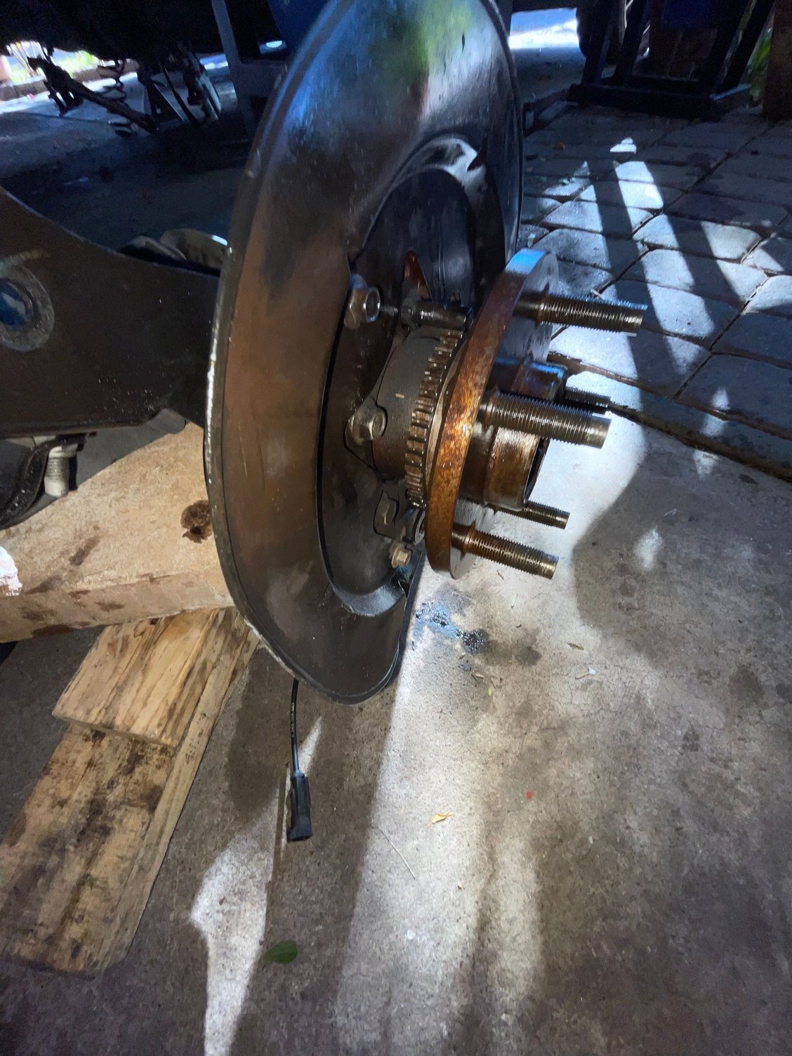

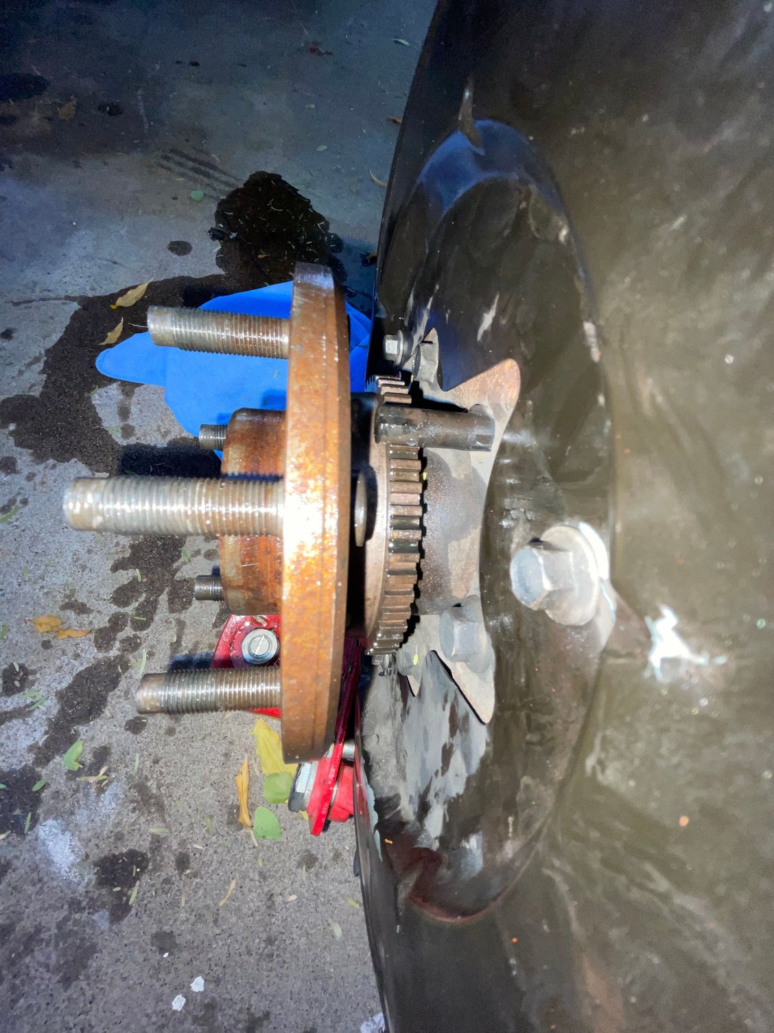

Now as far as your problem.....Did you remove the ABS sensor when you removed the axles? I'm assuming you did because it's nearly impossible to get the axles in far enough to remove the C clips without doing so. Now in the picture above it looks like the axle is still pushed in....if it is not pulled back out where you can no longer see the C clip then the ABS toner ring can catch on the bolts for the caliper mounting bracket and would cause the axle to lock up and not spin.
As far as the noise you were hearing, from what you posted and stating that it would change when you applied the brakes then I would first look into the brake components for the squeak...rather than deeper into the rear end.

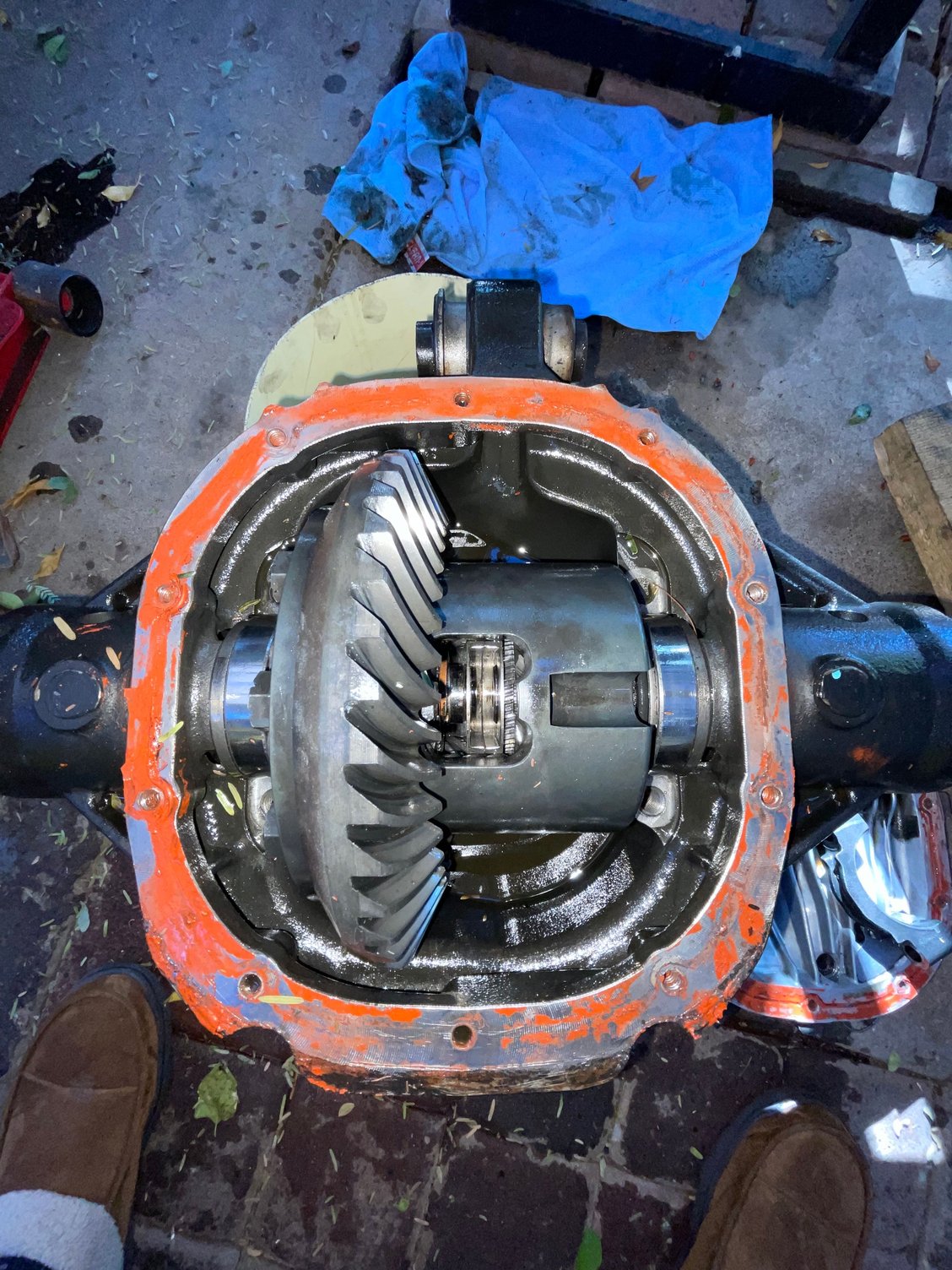

I'm not sure what the 2010 rear end is that you picked up but it looks like this is a Torsen differential rather than the standard traction lock found on the standard GT.
Abs sensor would be the wire right or is it something in the differential that I have to remove too? Only think I took off was the c clips the carrier pin and then I pulled the axles out, but yes picture where you can see it pushed in is the max it goes and the one with the c clip in I kinda had to force it in but still like it won’t spin

I Would Guess Get The Sensors Pulled & See What Happens!
Maybe Some Sensor Damage!

Each axle has an exciter ring pressed on it and in the caliper mounting bracket there is a sensor that is bolted in that reads that exciter ring. This tells the computer what the speed of each wheel is. In order to push the axle all the way in to remove the C clips you have to remove that sensor otherwise it won't go all the way or you crush or break the sensor in order to get it to go that far. I suspect that might be where your binding is. Can you take a picture of the back of the axle where it is against the rear end flange/caliper mounting bracket?
