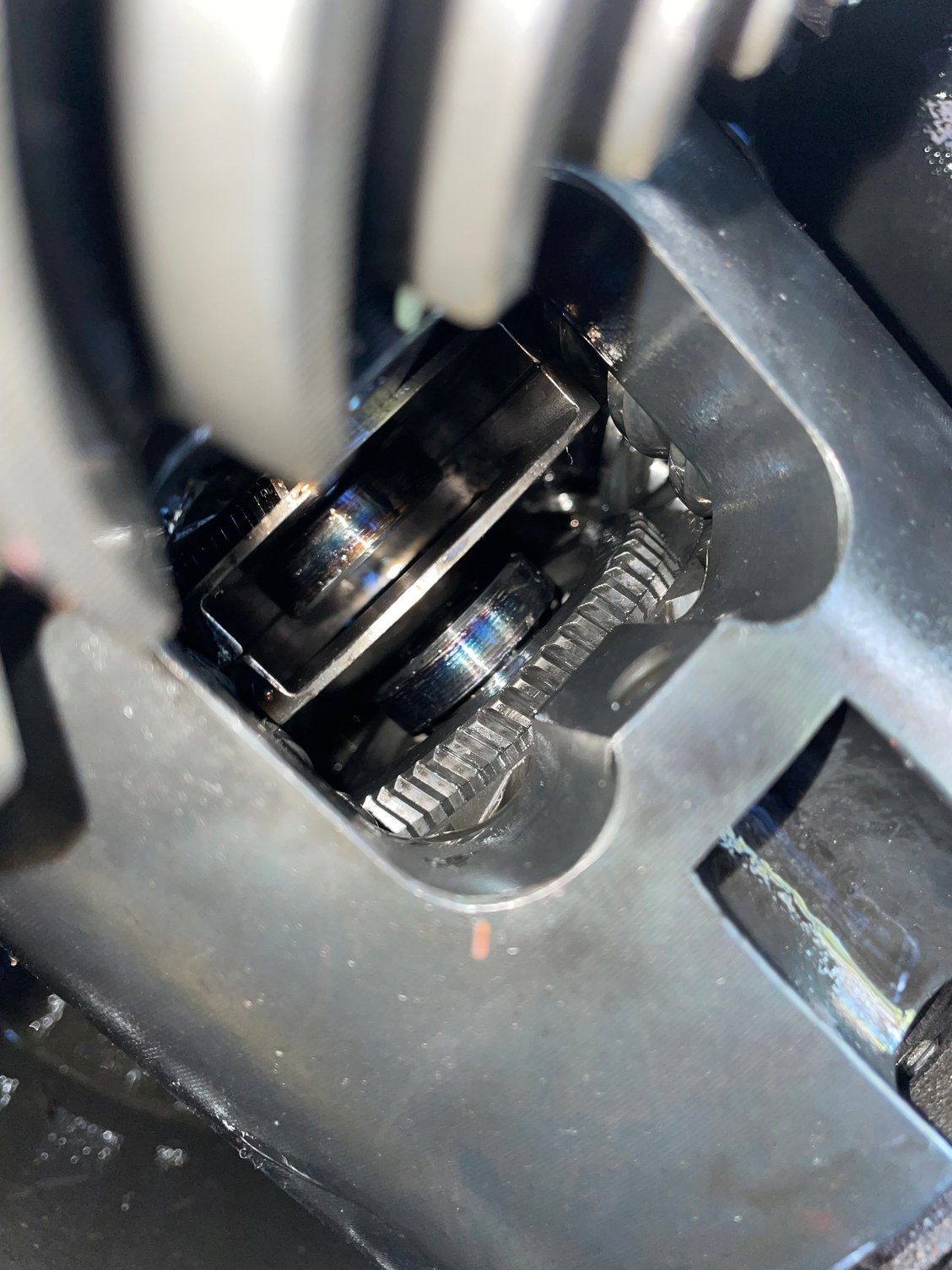

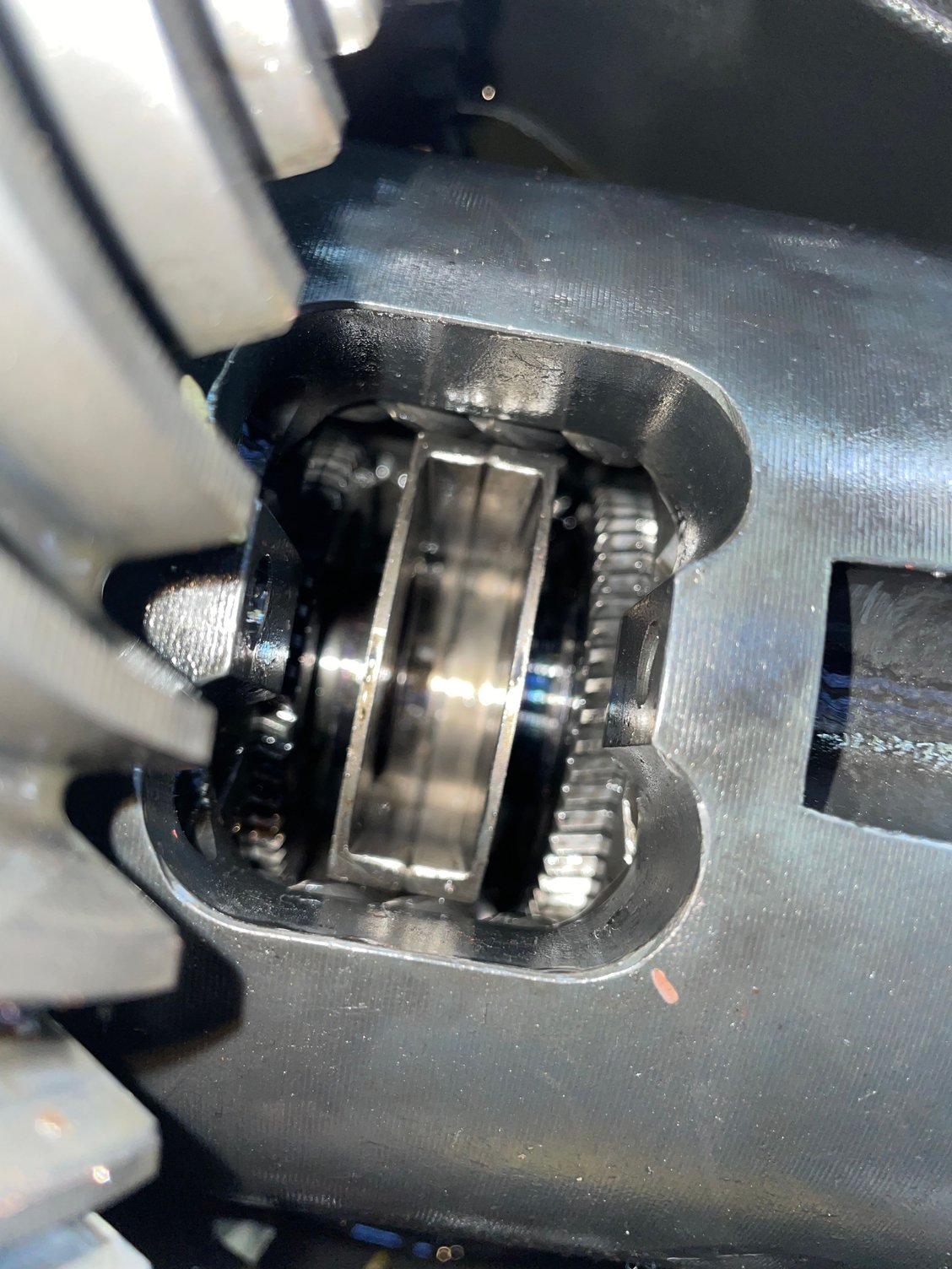

Old Jan 9, 2024 | 10:37 AM
JuanVillanueva1973's Avatar
Joined: January 7, 2024
Posts: 19
That’s about as far as I can get the right rear axle and the left axle barely too I have to force the c clip on the left jjst so it can go in but even then no spinning
Old Jan 9, 2024 | 11:02 AM
svopaul's Avatar
Service Manager
Joined: June 29, 2004
Likes: 626
From: Odenville, AL
Originally Posted by JuanVillanueva1973
No before I had everything inside with the axles and it wouldn’t turn in just taking the carrier out so I can see if anything’s messed up
Do you have any experience with taking apart rear differentials? There are specific shims on each side.
Old Jan 9, 2024 | 11:04 AM
Posts: 19
Yea I’ve took it apart and I’ve always kept the shims on the side that they were on before
Old Jan 9, 2024 | 11:12 AM
svopaul's Avatar
Service Manager
Likes: 626
From: Odenville, AL
OK, you just need to back step what you did and at each point you reassemble you need to test and make sure there is no bind. Something somewhere in there is binding...if you check with each step you should find it fairly easily.
Old Jan 9, 2024 | 11:46 AM
05stangkc's Avatar
Joined: November 27, 2004
Posts: 12,596
Likes: 4,347
From: Visalia Ca.
I Found This Read Carefully. Not Sure if This is Same Style Torsen!
I believe You Have Type Two Which is What I Am Seeing For Track Pak Cars.
Information is Just So Sketchy and Varies! I Tried to Zero In as Best I Could.
Seems Like The Side Gears are Popping Out and Have To Be Deflected One Side To The Other During Axle Install.
Installation Instructions for Torsen® Differential 8.8” Solid Axle Rear Suspension Applications – Ford Mustang, Crown Victoria, Ranger, F-150, and Explorer NOTE Take care to keep right and left bearing cups, shims, and bearing journal caps separated! 1. Install ring gear on Torsen differential. Torque bolts as specified in the Ford Service Manual. 2. Install two new journal bearings on Torsen differential. 3. Mount differential assembly into axle by following the procedure given in the Ford Service Manual.
4. Remove retaining pin holding the thrust block from the Torsen differential and slide the thrust block from the differential.
5. Insert the left axle shaft as far as possible. Place C-clip axle retainer into groove in the end of the shaft. Do this by sliding the two center washers up tight against the right hand side gear, putting the C-clip in place and pulling the axle shaft back out until it stops (approximately ½ inch).
6. Slide the center washers to the left and repeat the previous step for the right hand C-clip.
7. Slide both center washers to respective sides.
8. Holding the center washers apart, insert the thrust block between the washers.
9. Reinstall the thrust block retaining pin and torque to 25 ft/lbs.
10.Reattach axle cover and fill carrier. Consult owner’s manual for fluid and capacity. For questions concerning the installation of the Torsen differential, call (585) 464-5000. Torsen® is a registered trademark of JTEKT Torsen North America, Inc
See Pdf For Diagram. Does Your Have Washers as Spoke About??
