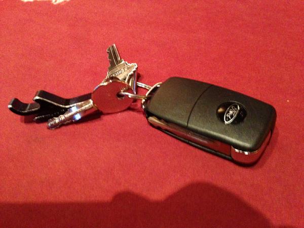

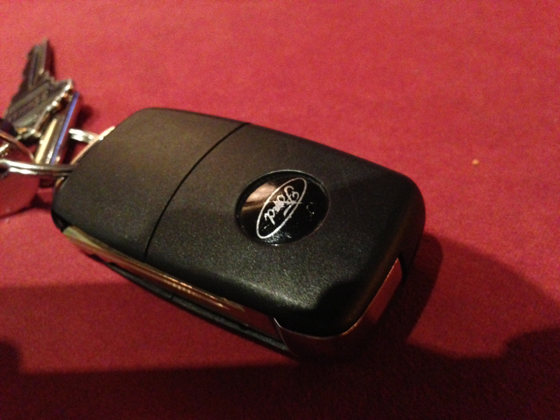

I've had my flip keys for about two months now. The only complaint I have is the Ford emblem is all scratched from normal wear and tear. Anyone have same problems? If so what are some solutions?

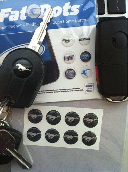

I ordered my key tonight and some logos I found at http://www.fathead.com/automotive/fo...ts/?src=search
They are a tad smaller than 14mm but will see how they work out once I get them.

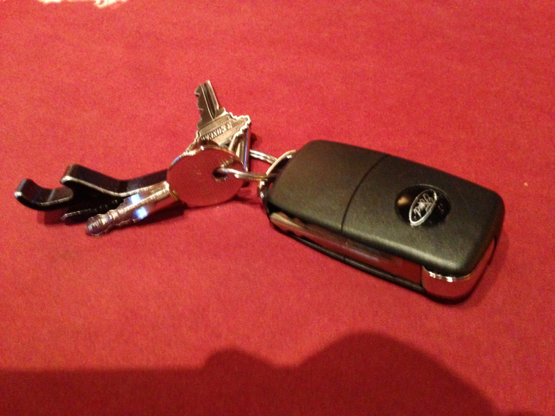

So I got my key and the fathead stickers. They are way to small but I managed to contact the seller on eBay who sells the 5.0 stickers and they made me a set of running pony stickers. They are not exactly what the factory oem key sticker looks like but they will do the trick.
