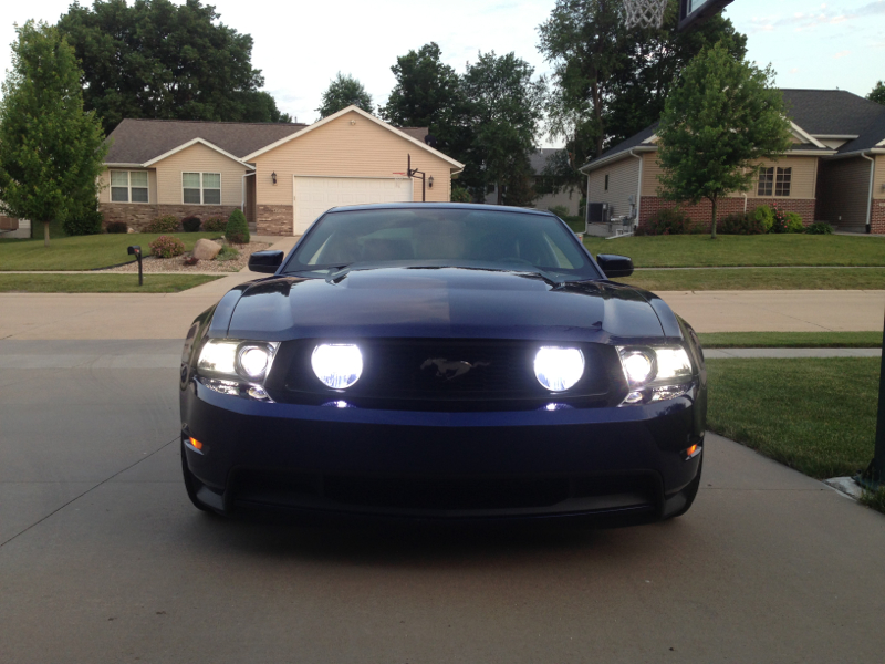

I went for another drive in early dusk. Just the perfect time to turn on the lights...man, I just love these new lights. They're all perfect now. It attracts a few stares on the road
