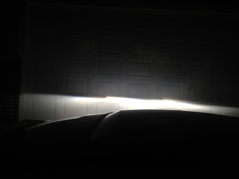

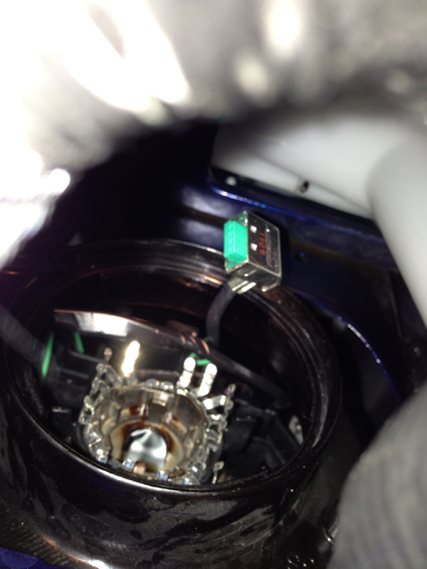

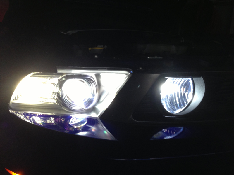

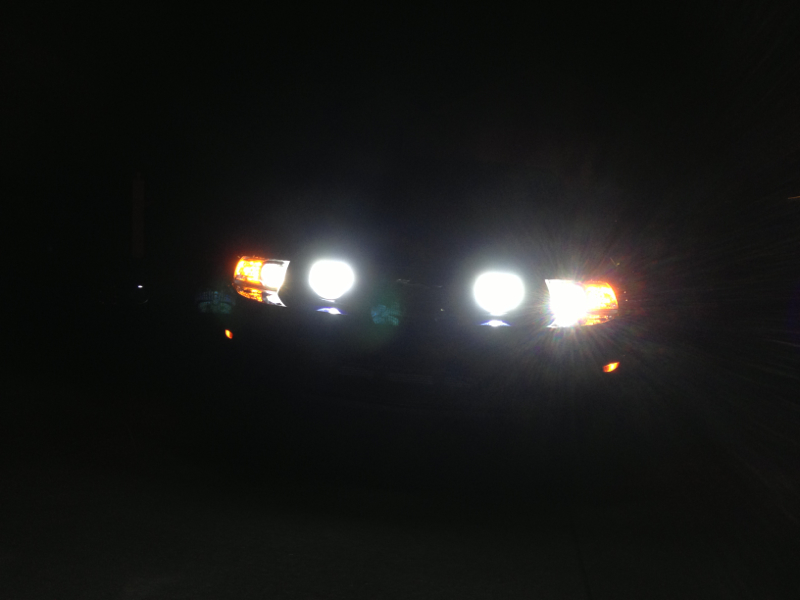

Install complete. What a royal pain in the you know what. Wow. My biggest heartaches were removing that stupid connector.... Then putting it back in those metal fingers so that you can lock the rotating tab clockwise again. Wow, just a royal pain. What should have been a 15 minute job took an hour. The concept of it is easy, but wiggling in that tight space is a pain. My wife oils have sworn there was a drunken sailor in our garage. Plus my fingers and hands are all raw from scraping and prying at all those connectors there
I love the new lights tho... They are a perfect white.
Some night shots... Loving these new bulbs. Hopefully they last a long time. I don't drive that frequently at night, so hopefully that should help make them last longer lol
For those of you with stock HIDs, have any of you upgraded the bulbs to something of a better quality/output than the stock bulbs? I know the bulb size is D3S, and if it's worth the upgrade, I'd spring for it. Reason for this is I recently upgraded to HIDs in the wife's car, since it had stock projector housing halogens. I merely upgraded the bulbs (with ballast), and it's the best looking HID I've seen.
I have no interest in anything beyond 5k color temps. I just want a 4300 to 5000 temp, but a BETTER version than stock. Thoughts?

I'm more than happy with my headlights and foglights. Same color now. Light output on the headlights just shifted in color not output. Foglights obviously went from 800 lumen candles to around 3200 lumen lasers.
Here's two recent pics.
Old Jun 1, 2013 | 07:53 PM
Likes: 173
Now those headlights look truly white! Much whiter than oem ones. So do you have a link for which ones you got and where? And was it a simple swap out of just bulbs? Remove plastic cover then turn bulb and remove, then repeat opposite for install?
