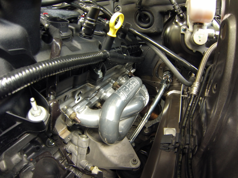

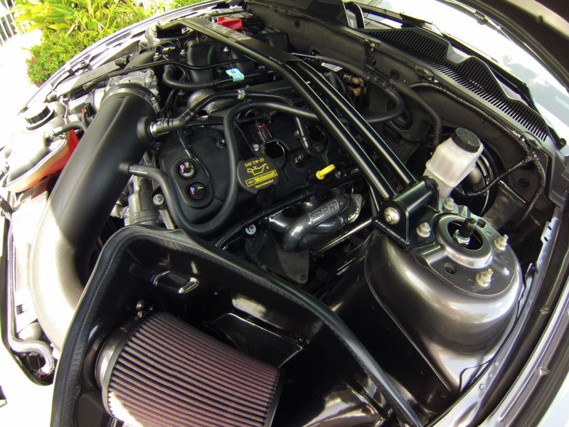

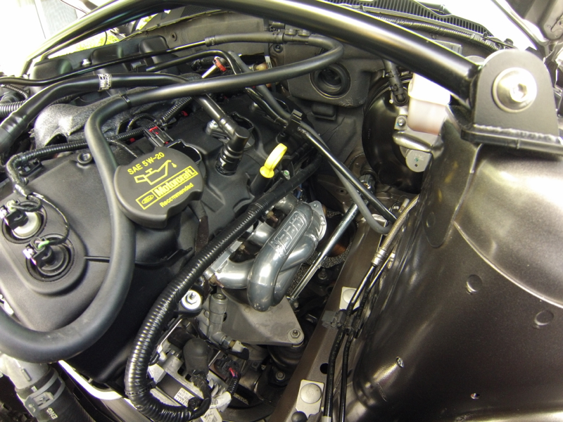

Just took some goPro shots of the headers.
Attached Thumbnails BBK shorty tuned ceramic headers-image-2604149882.jpg   BBK shorty tuned ceramic headers-image-1638197783.jpg   BBK shorty tuned ceramic headers-image-2979553029.jpg

The stock manifolds come off, no prob. If you have the right tools, sockets, extensions, etc.
The BBK headers are a ***** to get on. Even with a surplus of tools, I had a very hard time to get the correct torque on the bolts. 3 on top, 3 on bottom.
I was almost going to throw in the wrench and have someone else do the 2 bolts I could not get to from the bottom, but it turns out through the engine bay was the only way to get to the bolts.
My arms were bruised and sore. Ford wanted 5hrs for the install.
I took it to Ford a couple of days later after driving for them to re-torque the bolts and inspect for leaks.
They charged me 1.5 hours for this service, and said they had to take the starter off to get to one of the bolts. Something I did not do on the install
A very worthy upgrade. I notice a huge difference now after driving for a week or so.
Xpipe on the way!

6 per side and the 2 on each Mid pipe
It will take patients, all but the bottom bolt on #6 (Back on drivers side) can be tightened up from the top. The bottom nut on #3 (back on Passenger side) I tightened with an open end wrench flipping it around to get it on the nut, the other 10 were a box end.
Using a 13 MM to tighten makes it a little easier to get the wrench on but they are 1/2 inch so have one handy for the final torquing.
Remove all the studs from the nuts, there are a few that the stud will not go through the hole of the headers. Removal of the stock manifold can be done with a ratchet and socket also.
Tools required
18 inches of 1/2 inch Extensions
1/2 inch breaker bar
1/2 inch ratchet
15 mm socket
17 mm socket
3/8's inch ratchet
10 mm socket
1/2 inch socket
5 mm socket or wrench
I think that is it
