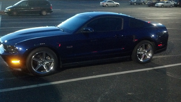

Installed Steeda 93 tune & CAI at 1,000 miles. I just rolled over 40,000 miles on the way back from their Valdosta shop finishing up my suspension and a few other goodies. That being said, I've had 39,000 miles with their tune and not a hiccup/ check engine light etc. You can't go wrong with Steeda. Matt, Randy and Jamie are the epitomy of customer service and true professionals promoting the Steeda brand at it's finest.
