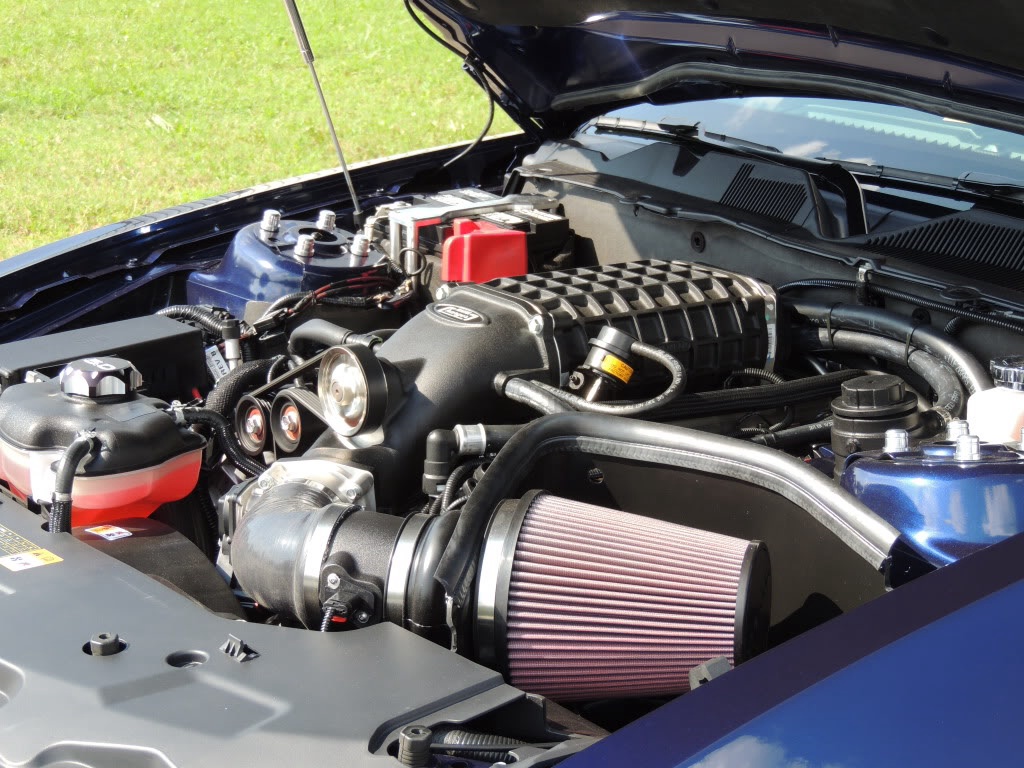

Yea I forgot to mention the whole coolant hose thing. We were confused at first too. Since I bought my kit used I ended up making my own pathway with new hoses how I wanted it installed. Looks good my man!

That setup does look extremely good! The blue looks exactly like the coil covers and it's all a great contrast to kona when you pop the hood.
Thanks man... Yeah powder blue or bust!!!

So storm, more seriously, did you route yours like mine? Driver side coolant hose from sc manifold goes to reservoir, while passenger side coolant hose from sc manifold goes to front inter cooler passenger hose via coupling.
Also what'd you do with your evap solenoid extension harness??? Same issue as mine???

My pass side manifold goes to reservoir. That's all I can really see under my hood and don't really rember the rest haha. I could send you some pictures if you want to pm me your number

Oh and the harness. I just plugged it in and left it. The evap system is pretty much useless anyways. If it unplugs oh well I'll tape it or zip tie it

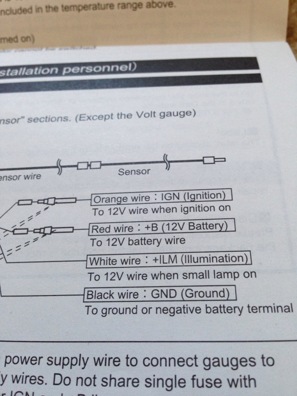

Thanks tony. I have to do the boost gauge power next but I don't know which wire is the dimmer...

Guys... I need help with how to wire up the electrical portion of the boost gauge. I don't know where to start. Not many helpful threads out there at all. Can anyone help?
I sent you a PM before reading the latest, I did not hook up the dimmer so I can't help you there.

Just run a fuse tap from a fuse in the fuse box. Use a fuse from a power source that turns off when you turn the key off

When you say fuse box which one? Is there one inside the interior rather than the main fuse block? I think I read somewhere that it's on the passenger side... But I don't think I'll have enough wire to get there fuse tap I can buy I assume. Another question I had is where does the white wire go? This pic is from my boost gauge instructions.
If your don't have a fuse tap like I showed you in the PM go to a local auto shop and get at least two along with an "eyelet" type butt connector for ground. Also get enough 18 ~ 20 gauge wire to go from the gauge to the passenger side x 3 (one for ignition which I discussed in my PM, one for the constant 12V in your diagram and one for ground) and at least 6 (more would be better incase you screw one up) 18~ 20 gauge butt connectors. Also if you setup didn't come with fuses you'll want to get a couple of those also (if you don't know the amps get 10 to 15 Amp for the gauge). If you don't have a crimping tool for the butt connectors get that also. If you don't have a multi-meter get good or cheap one (as long as it can display 12V). Every guy should have one LOL.
As I told you in the PM do the ignition (orange) but you'll also want to find a fuse that is constant hot (with ignition off) for your red wire in the diagram. Use your two fuse taps for these two and ground (black wire) using the eyelet butt connector to a factory ground (there's one if you pop down the glove box on the glove box frame).

Thanks mark. But what's the white wire in my diagram for?
The white wire is if you want the gauge to react to the dimmer switch which I've never used. You don't have to hook that one up for the gauge to work and light up on ignition. If you want to use it just follow the same wiring procedures but it would tap into the dimmer wire with a "vampire type connector" (see below). To find that wire unless someone chimes in you would have to probe for it with you multi-meter.
