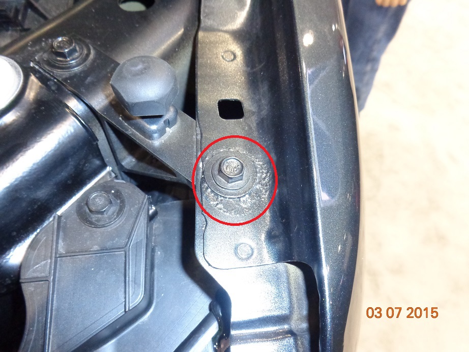

this was one of many pics of 2015 F150 at this years Cleveland auto show- two of six had similar bubbling at this same spot...sure looks like the paint is bubbling up under that bolt dont it? the Ford folks I showed/asked said they thought it was galvanic corrosion- I didnt really care what they called it, It didnt look too impresssive on a $60,000.00 vehicle
Kudos to ford for leading the way with aluminum- but from what I saw on 2015's and their horrid track record on aluminum mustang hoods, I'm afraid the old windstar recalls will be looking cheap in a few years...and if/when F150 paint starts failing like mustang hood paint, Ford will be in for their biggest battle ever... if F150 confidence goes the way of mustang hood confidence, they will be in deep deep trouble.

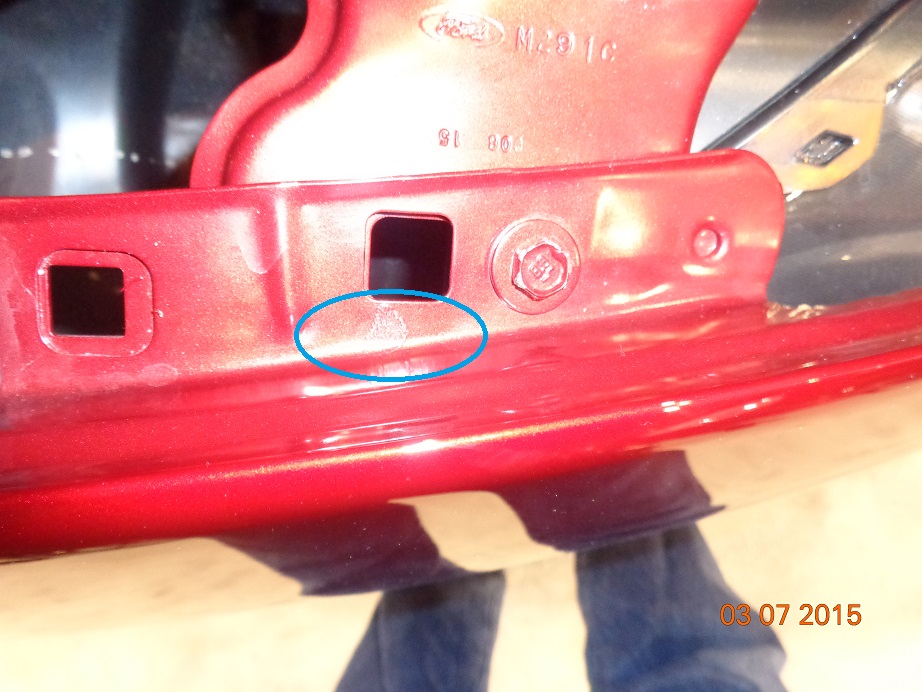

something I thought was interesting- note on F150, the aluminum fender uses a double washer- I'd read something about special fasteners to prevent galvanic corrosion under steel bolts... but look at a 2015 mustang aluminum fender bolt- same old single washers- maybe nothing, but the F150 has a 5 yr paint adhesion warranty, mustang still only three.
hmm...
this was the only mustang aluminum fender paint bubble I saw at the auto show- not by a bolt, but looked like it started at the square punchout...bubble was small- maybe 1/4" but paint was definitely lifted/loose...didnt feel like the crunchy corrosion typical, so maybe it was just painted over oil or something- tons of pics of dirt under paint on all ford models displayed at the show, except a F350 that looked as good as any other brand out there... but the other Ford products had paint work that wouldnt fly in a backyard paintjob...really was depressing to see- its not rocket science to smooth seam sealer and wipe down before paint- a 5 yr old could do it... with all the cool gadgets/tech on all the new fords, its just silly they are still dropping the ball on the most visible billboards carrying their emblem. do they really think all the mustangs/explorers/expeditions going down the road with 'hood herpes' arent costing them sales- its really insane how they are continuing to ignore such a SIMPLE prep problem.
Attached Thumbnails bubbling hood paint... UGH!!-mustang-fender-bubblingsmall.jpg

It's simple if you don't use a whole body dipping solution type ecoat. That's where the whole thing fails. Since the steel AND the aluminum are dipped into the tank... there's no hope.
At least, that's all I can really figure out on that part.
If they're using *steel* bolts on an aluminum part?
Galvanic corrosion is what'll happen. Either *ALL FREAKING ALUMINUM* or nothing... or no paint, which might be ok...
