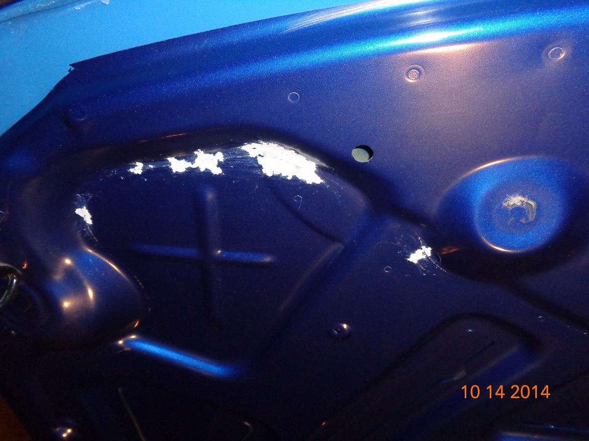

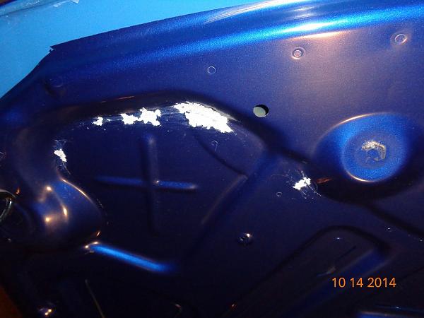

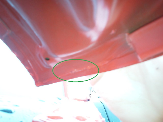

bigger problems guys... suggest everyone think about pulling your hood insulation down
was hoping tonight to pull the hoods off the wifes 07 (20,000 miles) and my 09 (still undriven- 4 miles), to tip them nose-down, slosh some paint inside between the front layers to seal it up... her car first, had to pop the liner for access to the holes- the freaking liner is abrasive, has rubbed thru the paint all over the place, and quite a few big paint blisters UNDERNEATH the insulation... couldnt see any of them till it was removed. used one of those bent/fork christmastree plug pulling things for door panels, gotta be really careful with the insulation, made a couple dents in it they seem to not show, dont think anyone would ever notice them...
think the liner edges need a 'cushion' of some sort, might spray the underside of the fiberglass looking insulation with some plastidip spray- the rubber should soak in ok, and be soft enough it dont keep wearing thru the paint... will tear a couple little bits off somewhere to compare how easy it might burn compared to plastidipped... dont think it will be a issue though.
anyways, scraped all those blisters too, acid etched with ospho, coated with rustoleum... will recoat tomorrow and hopefully pour some inside to seal that, then a couple days to dry, and repaint the vistablue over it to hide the ugly... then on to the 09- if its blistered under the insulation i will be shocked as never had any vibration/never been wet... but the lip on that virgin 4 mile car bubbled up too, so who knows.
man ford did a ****ty job on these hoods. such a shame as they are otherwise such well built cars.
anyone into their mustang for the long haul probably should at least pop the liner to take a look before it bubbles up there too. I'll edit some pics in here in a bit. the light blue is just rustoleum- will overcoat it in basecoat/clear before its done, so it shouldnt be quite as ugly.

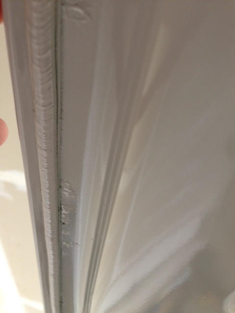

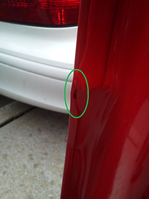

Reviving one of my old posts from July. What a sad week this has been.
The pic on the left is definitely suspicious for corrosion. However the pic on the right looks very much like e-coat blow out. I have that in several places on my hood. Been there since new and in 3 years has not changed.
it will.
I popped one of the tiny bubbles on my 09 when it was new, got a pic somewhere, was crunchy white powder(aluminum oxidation), put a dab of vaseline over the little hole, it never changed- but this summer 3 other areas bubbled up- and the car has sat inside under a shelby cover since new- has 4.9 miles on it, was washed at the dealer one time the day it came in and I washed it two years ago. its possible it might have got rained on at AAI's holding lot, but basically it is likely the only base mustang gt anywhere thats never been driven. when it started bubbling up it really really frosted me at ford- the paintjob/evcuses is simply pathetic- they or anyone can make all the excuses they want, but I dare anyone to look at the underhood seams on a hyundai and explain how they ALWAYS put out perfection and ford always puts out subpar work on the mustang. it would be inexcusable on a yugo, ford ought to be ashamed of the work being done at AAI on these hoods. the cheapest cars on the planet have great hood prep and paint, why cant a Mustang?

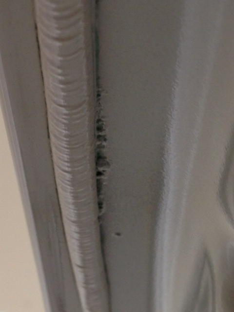

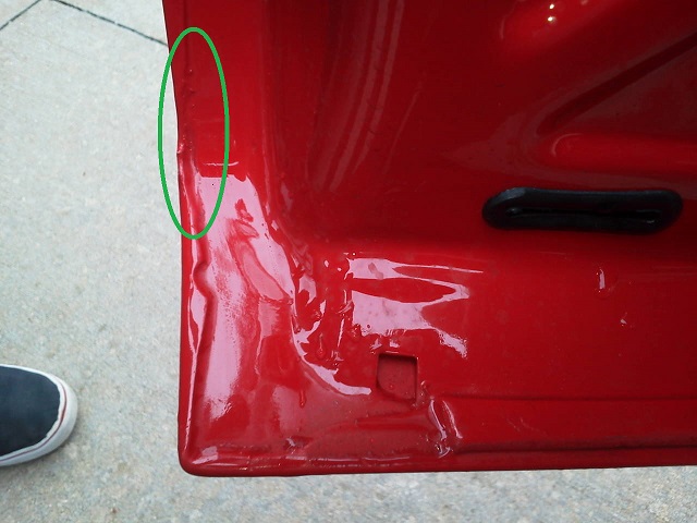

finally got to see a 2015 F150- as one might expect from me after suffering three mustang aluminum hood paint failures, I'm unimpressed- and not surprised...
what do you guys think of these pics? anything look familiar to the areas under your mustang hoods where corrosion initiated?
on the flipside, perhaps the little flaws are nothing, and the fact opposite sides didnt have them just means someone did 'too good' on the other sides.
maybe.
sorry but I see bad things coming 2~3 yrs down the road with these trucks. in my opinion, this is complete **** quality control compared to some other brands out there. put this on aluminum- I will be staying far, far away from the aluminum truck. it looks great, ought to be a great vehicle- but in my opinion the panel hem/sealing/paint on the underbody areas where corrosion always starts is simply pathetic. Perhaps Ford should contract Hyundai to put panels together for them.
Attached Thumbnails bubbling hood paint... UGH!!-drivers-door-stuff-under-paint.jpg   bubbling hood paint... UGH!!-drivers-front-door.jpg   bubbling hood paint... UGH!!-drivers-rear-door-bottom.jpg   bubbling hood paint... UGH!!-drivers-rear-door-front-edge.jpg   bubbling hood paint... UGH!!-passenger-quarter-lip-behind-tire.jpg

The F150 photos seem to picture sealant beads. On my 2010, I did not see a similar surfacing, just the edges and small bubbles. If the metal is different ("aircraft grade aluminum"), I don't necessarily conclude there will be issues.

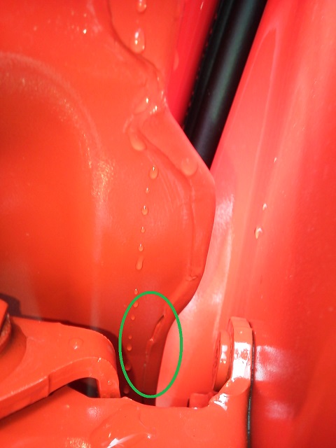

maybe not- I just hate the sloppy look compared to others. there were two spots that looked like the tiny bubbles, but were bad pics- youll need to zoom in a bit, but the area towards the windshield/side edge on drivers side had the tiny bubbles that looked just like my mustang hoods had- the ones that eventually strawberried. I did NOT see the cobwebbing like areas under the paint like early bubbling started out, and like seen on the orange and blue auto show mustangs...the drivers door bottom edge sloppy as it is, did appear to have a lot of paint on it- the bubblegum looking crooked strip over the mismatched quarter panel had mostly nothing- and if you look close at the top edge in that pic, notice how jagged that edge is- i didnt notice that until i downloaded the pics...
the thing that just bugs the crap out of me, obviously they applied sealant for a reason, and obviously areas were missed on one side or the other...every single hyundai i checked at the auto show was perfect, 90% of the toyota seams looked as good as hyundais, just saw a couple that were a little bit sloppy around tailgates or doors- every Ford I looked at had seam sealer that looked like a roll of hardware store bathtub caulk if any, and even in sealed areas there were spots where the sealer completely missed the seam- just shoddy work.
heres the best hood bubbled edge pic- was only maybe a inch, but sure looked like the mustangs early on...only time will tell. sorry pic is so bad, was overcast and my phone has a crap camera, contrast when looking upwards with sky in background washed pic out pretty bad.
as for the alloy, if they knew 6061T6 or something with similar corrosion resistance, or maybe just a different type of Ecoat, why are mustangs ten years later still getting a lesser material after all the documented issues? I'm pretty darn sure this trucks design was tested/finalized years ago, it couldnt have been tooled up for in a year... the 'stuff inthe paint' pic of the drivers door bottom looked like good old dirt, also if yo look close at that pic, the panel edge is crooked- it looked a lot worse in real life...most of the other pics i got were just holes/missed areas
