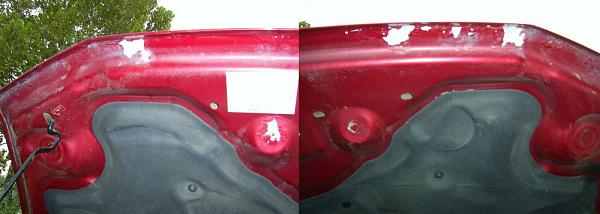

rusting hood 06 Mustang
On the lip now and passed warranty, is the TSB of any count after that ?
Mine is the same. I just touched it up as best I could for now. Probably get a new hood in the future.
Cleaning and touching up IMO won't work UNLESS the cleaned up metal is treated with a proper prep...I'm not sure, but think phosphoric acid also works for aluminum- read up on it, the stuff is cheap and pretty safe to work with, but if the acid isn't applied to convert any microscopic oxides into something inert, it will usually return, unless painted in zero humidity, which is impossible...
On rusty steel, phosphoric acid converts iron oxide into iron phosphate, and seals the surface with a oxidation-proof coating, but not waterproof-still needs painted...pick up a small bottle of ospho from Ace hardware for about 8 bucks, sand a piece of scrap metal, brush some ospho on half and sit it out overnight...in a day the untreated side will be rusting, by 3 days will be completely orange...the ospho side won't show rust for a couple weeks. If you ospho, clean, paint, the steel won't rust for decades...if you paint over "just cleaned" pitted steel, usually blisters will appear within a couple years tops-faster on aluminum.
Acid prep IMO won't save paint over a razor edge piece of metal, the sharp edge invites breaks in the paint, once ANY moisture can get in, oxidation will creep under...in my opinion "iron contamination" excuse Ford offered is wrong-I think the problem is they painted over a edge that wasn't deburred before crimping, and even the slightest panel shift(heat/vibration-it IS a hood...) will break the paint at the sharp edge, and its gone from there.
I really think scotch brite buffing of the edge of the crimped edge(not the edge of the hood) and acid etching, then seam sealing/painting would be the only hope of stopping the return, but odds of fully cleaning the edge are slim...the panel laps are slightly uneven, making even seeing it difficult...if they would have only deburred the top panel stamping(easy before crimp) they would never have had this issue... It's also one of the few areas that a "open hem" crimp like on GM door bottoms would be nice- the edges could be exposed where seam sealer could be accurately applied after cleaning up the panel edge...but extra labor for deburring, extra step of seam sealing, would mean a few dollars a car extra...would that be better than hoping they all make it out of warranty before upsetting the owners? Even impeccably cared for mustangs will suffer this failure, to me that's just being too cheep on Fords part...ford fan or not, their lack of correcting this problem so many years after first appearing is pathetic. If (big IF) I go to look at a 2015 when they hit the dealers, if I see a unimproved, unsealed sharp crimped hood edge, I'll have to walk away...sorry, but cars are getting too expensive to accept this type of 'normal'.
LOOK AT THAT FORD! Does that look like we neglect our cars? NO. This IS a problem that should have a recall. This pisses me off SO much. I would bet that this happens on more Mustangs than not.
