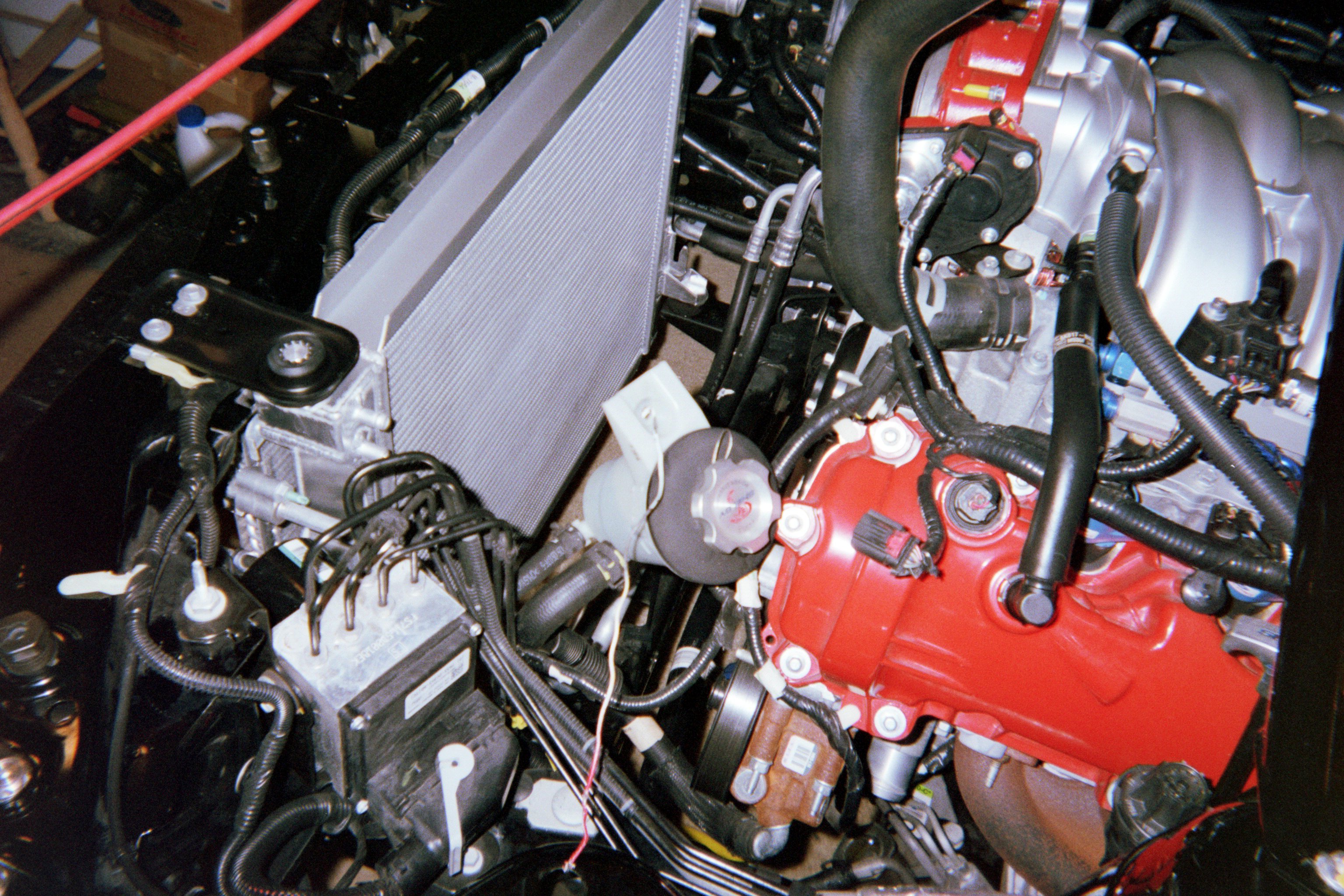

Hello All ,,
YES its me again ,,
Just a few pictures here to show you what I have been up to on my 2007 GT/CS mustang ,, I changed out the stock radiator and hose's plus upgraded to the new better stock Ford A/C coil now , yes you can no longer get the same one that came with your car ,, Ford has upgraded to a better one,, has the look of a water radiator across it ,, I added the Shelby touch to mine before install ,, and I moved the stock Ford horns to the drive side behind the front bumper ,, thanks for looking in ,,

Here are a few more pictures ,,taken of the work I did ,,
YES the car is not a daily driver ,, so I was able to take my time ,
thanks again for looking in ,, everyone take care ,,and stay safe .

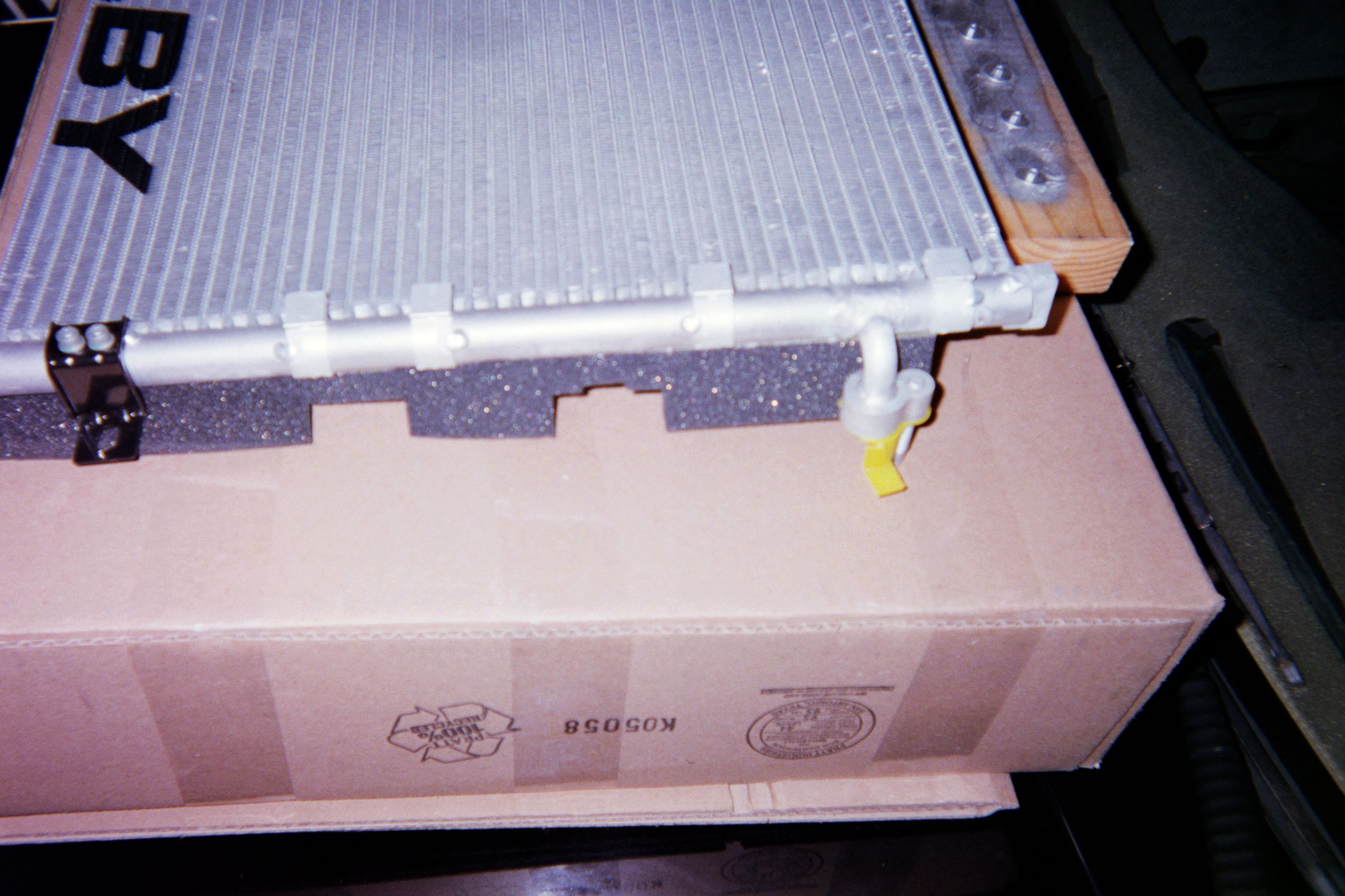

Here is the Ford part number for the newer style A/C coil that fits all 2005-09 Mustangs ,it has a radiator look ,the fins don't bend so easy as the old style one did ,,please take the time to look close ,
part # 6R3Z*19712*AC ,,,,cost is around $174.52 at Ford parts department . " Ford dealership "...

YES ,,to change the radiator and the A/C coil you will have to remove the front bumper ,, and the A/C coil does bolt to the radiator from the front side , much easy with the bumper off the car .

can anyone see the difference between the two Ford stock A/C coils ,, ??? ,,yet .

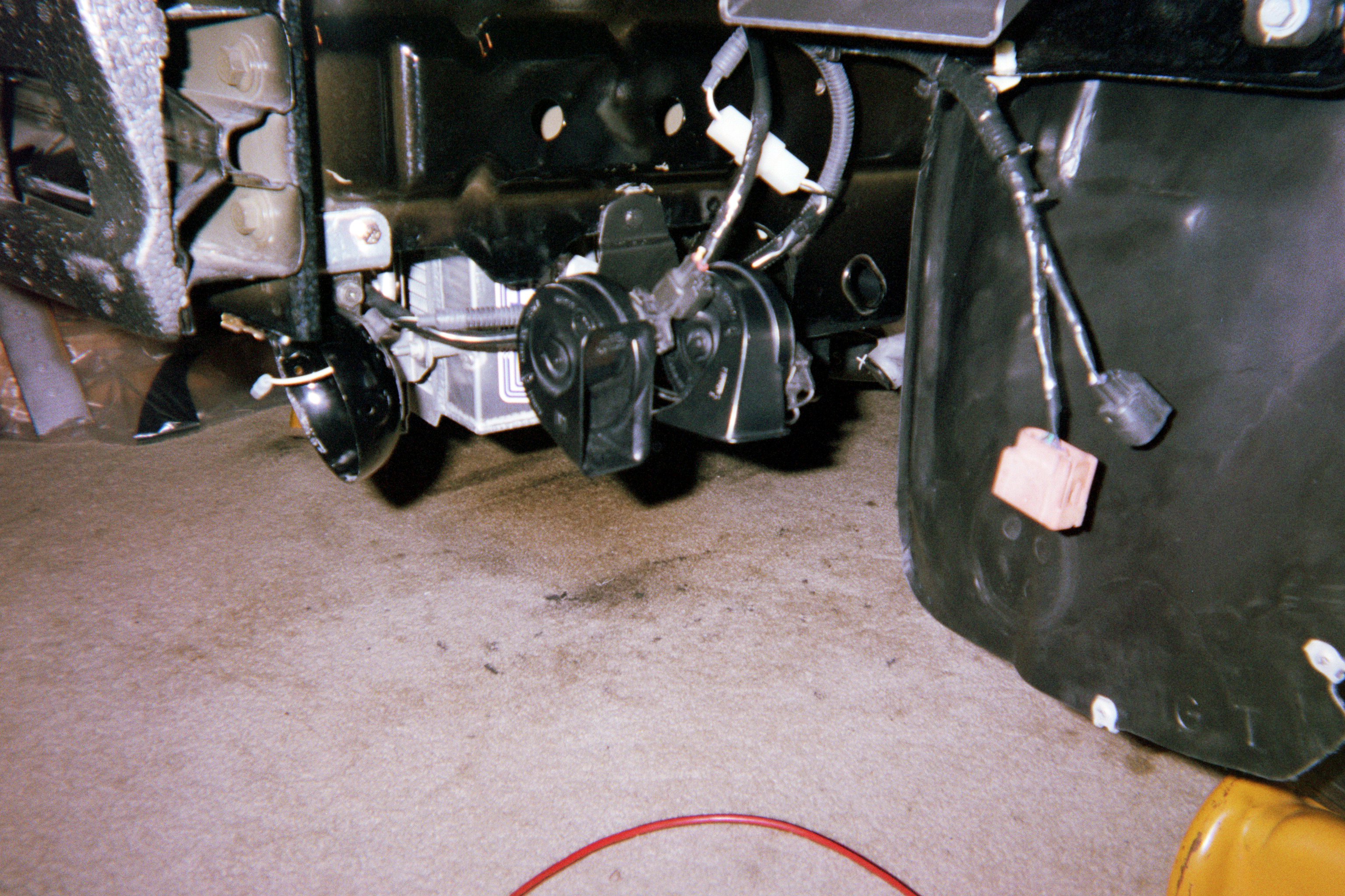

Moving the Ford stock horn is easy ,,
there is already a bolt hole on the driver side ,behind the front bumper ,,
you just have the cut and add about 3 feet of wire and move it to the other side ,
be sure to save your factory horn plug ,, cut back about 6 inches from the horn plug , then add the wire needed to move it over the top by the radiator support .
here are a few pictures of the horn replacement ,,,,
Attached Thumbnails 2007 GT/CS new rediator ,A/C coil ,hose-011_15a.jpg   2007 GT/CS new rediator ,A/C coil ,hose-010_16a.jpg
The " before and after " look ,,
to me its a lot better ,, and looks better too .
