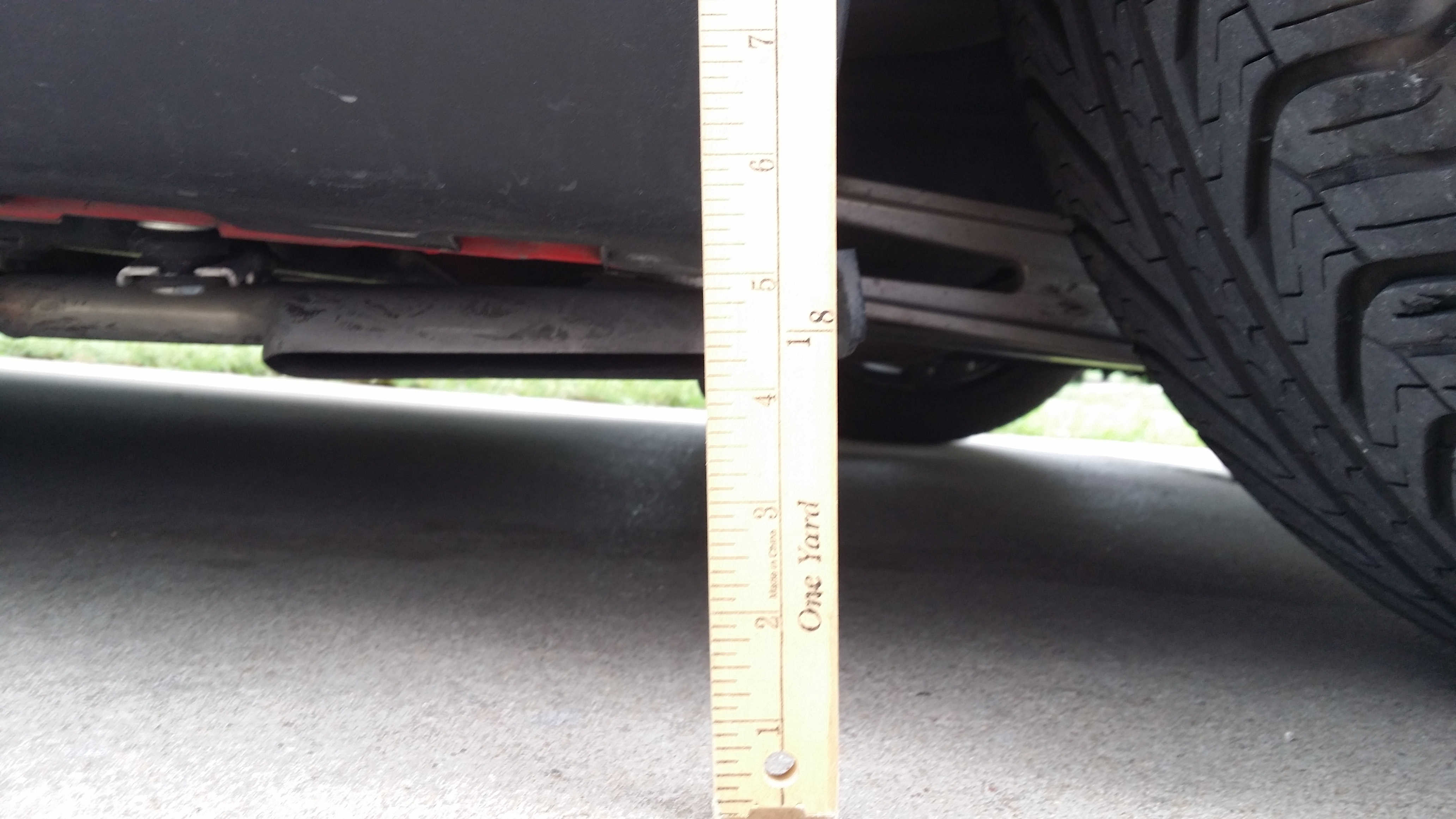

gMan--any chance of getting you to post pics of yours, showing the ground clearance. I have virtually the same 'vert/suspension setup as you. I've been reluctant to pull the trigger on the Boss setup because of the lower mounting. TIA
smike, I can take some pics a little later today. Not sure why I haven't already, lol!

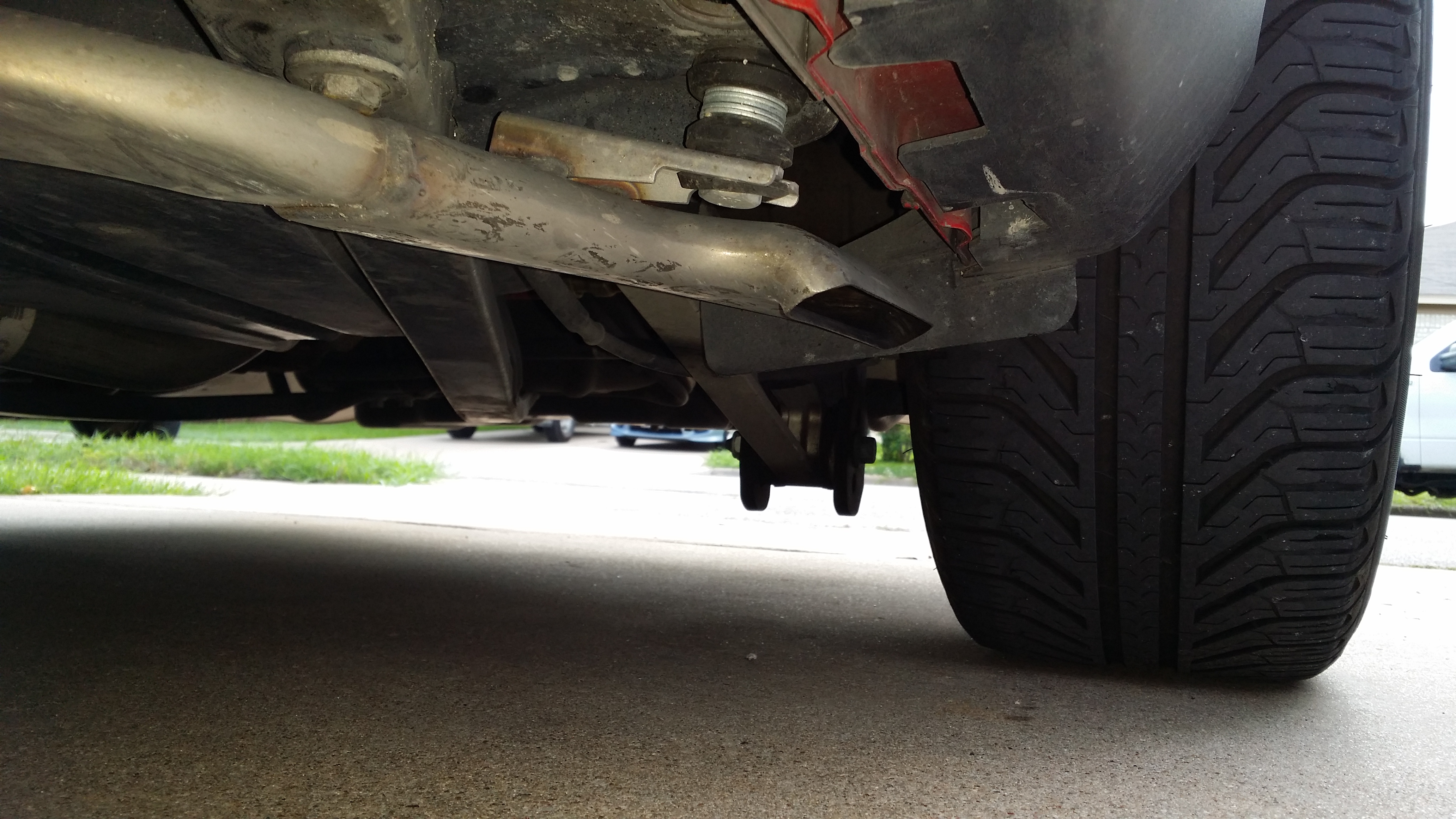

Here's a couple of photos. The pipe tips sit around 4 inches from the ground. Things can get a little ugly on speed bumps and steep driveways. For the most part they are okay.
You can see in the second photo, the convertible brace bolt head the is hitting. I didn't want to remove the bolt, so I snagged the pipe as best I could.

gMan-- thanks for posting the pictures. It looks like those wind deflectors in front of the rear tire are about the same height from the ground as the outlet. I'm going to have to measure clearance at the end of my driveway to see just how much wiggle room I have. One more ?, could you use another washer or two in your spacers to eliminate the contact with that bolt head? Thanks again!
I tried adding washers, but the flexible accordion tube section of the side pipe just flexes and the pipe still hits, but the outlet twists more. There may be a better way to bolt it up if you experiment with it.
