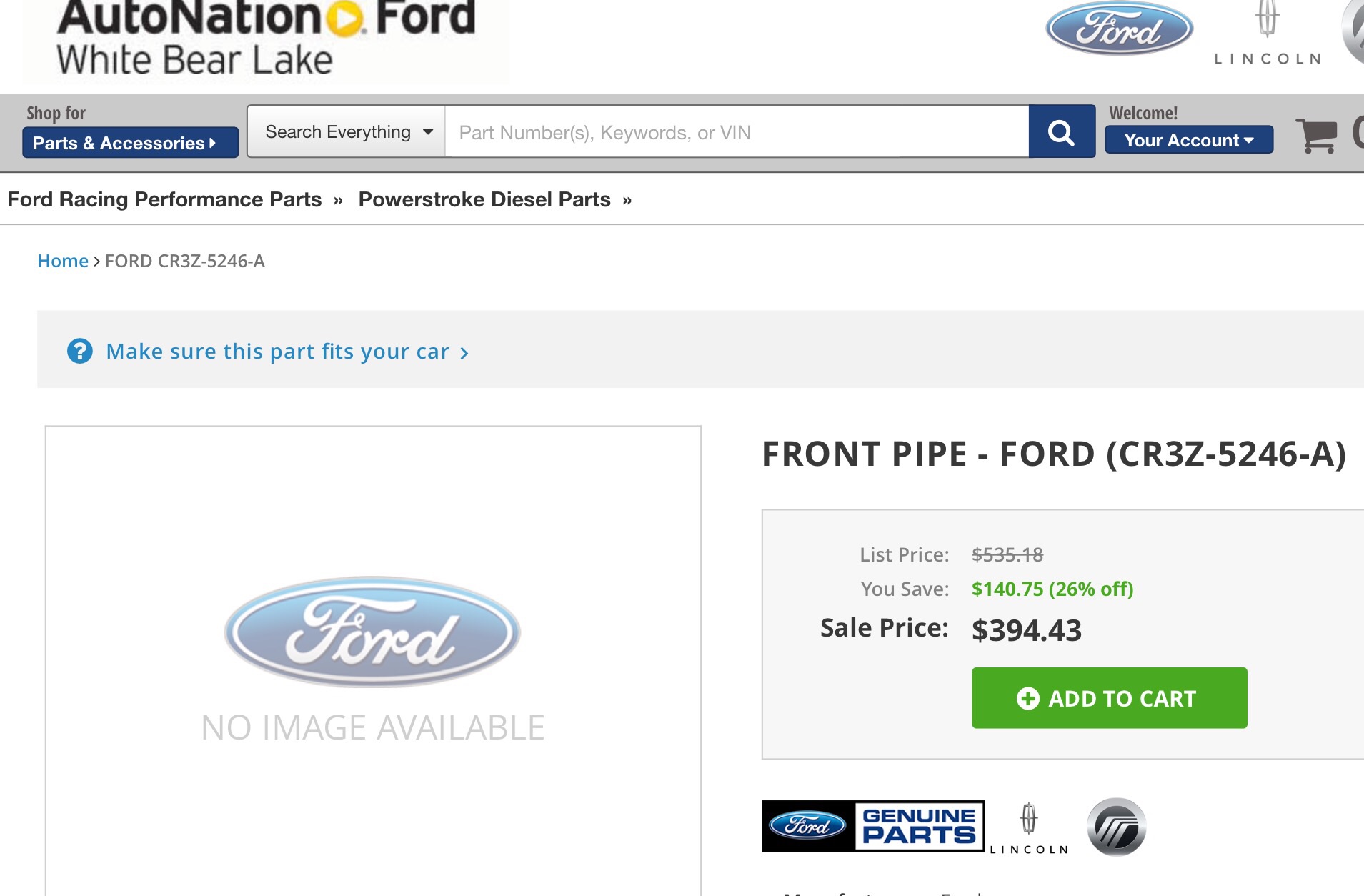

You can get new for about that same price...
