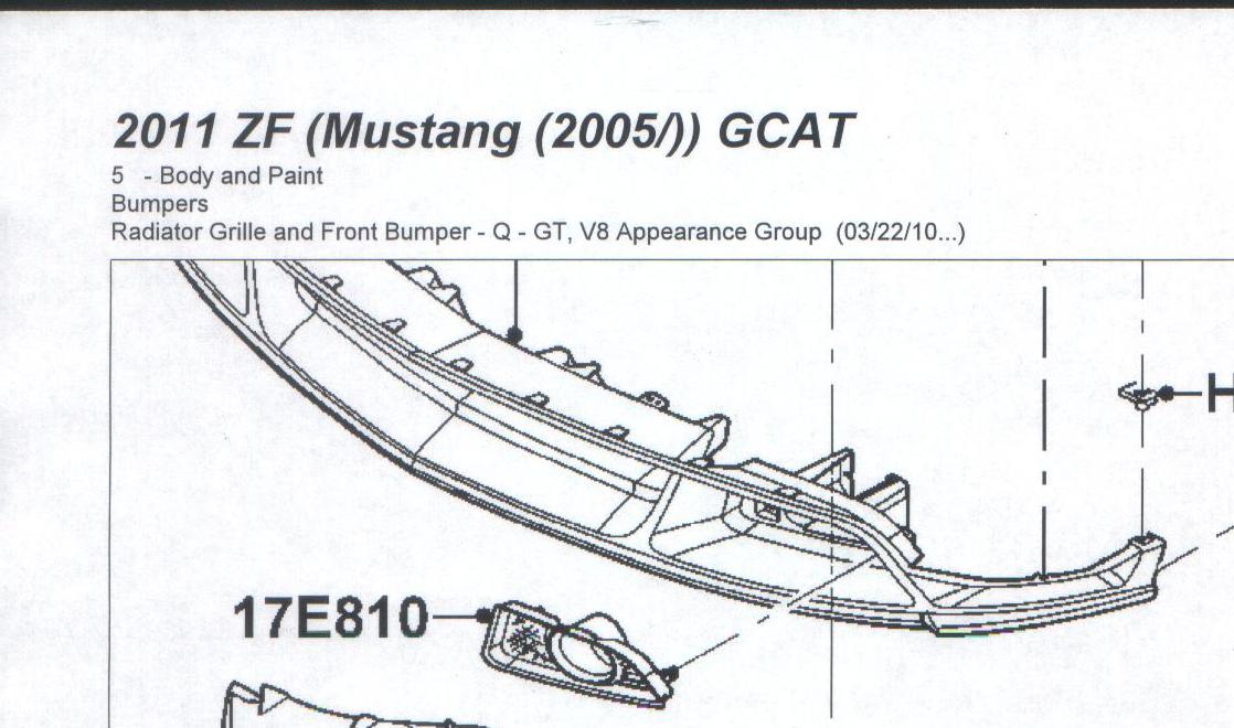

KC, any info on whether or not Ford has the CS fascia, but without the fogs and appropriate hardware, but includes brake cooling?
I think in that Case I would just get the Lower Valance & The Fog Bezels. They Look to me like a hose could be hooked up easily!
KC
https://themustangsource.com/f700/20...og-pdf-485453/
You Can Pull up the Install Instuctions for Any Ford Accessory Here. Might be helpful! Look for TECH SPECS
Attached Thumbnails 2011 CS front Valance install done ... with Part numbers ...-cs.jpg
