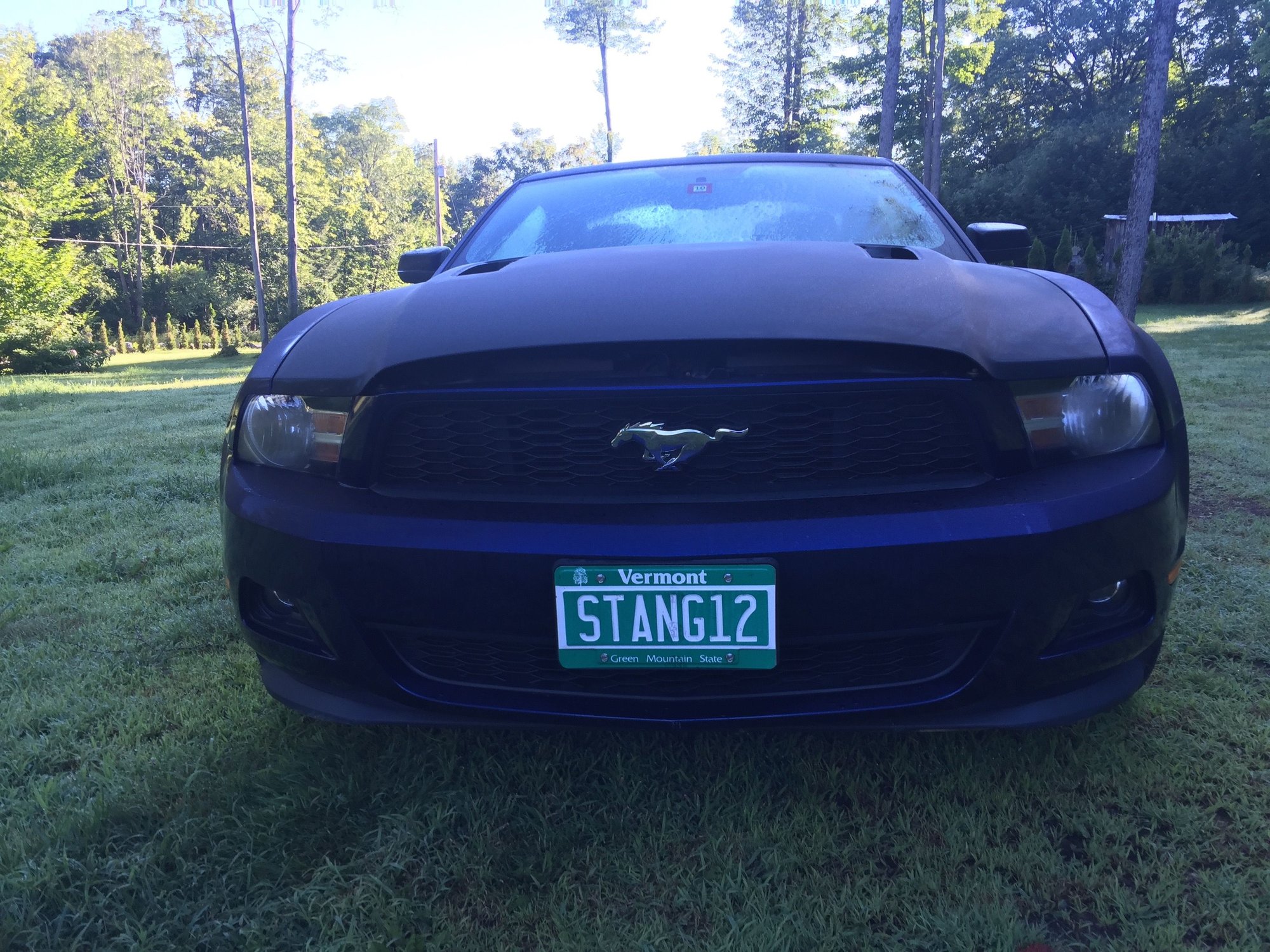

Hey Guys now that I have my interior completly finished I'm about to start the task of replacing my front end of that of a 2013 GT but I need a Complete Parts list of what is needed I am already good to go with the hood I have a 2013 GT hood with Vents, and Insulator that I'm hopefully picking up from a craigslist listing I found there my first $500 dollars down the drain so now I'm just going to order the front bumper components new from Tasca but I want a complete parts list be for I do it so far the parts I have found are:
Color Code:
Purchased
Front Bumper
Bumper Cover: DR3Z-17D957-ABPTM
Valance Panel: DR3Z-17D957-AA
Lower Shield: DR3Z-17626-B
Closure Panel: DR3Z-8C371-A
End Cover Right: DR3Z-8C391-B
End Cover Left: DR3Z-8C391-A
Upper Shield: BR3Z-8C291-AA
Grille: DR3Z-8200-BC
Molding: DR3Z-8419-BA
Grille Surround: DR3Z-8A200-AA
Lower Grille: DR3Z-17K945-BA
Bezel Right: DR3Z-17E810-AA
Bezel Left: DR3Z-17E811-AA
Starky Fog lamp Conversion Harness:http://www.starkey-products.com/must...11-led-GT-2013 (10-12 GT owners will also need a H10 to H11 Converter)
Fog Lamps: DR33-15A254-AE(RH)|DR33-15A255-AE(LH)
Hood Assembly:
Hood: DR3Z-16612-A
Insulator: DR3Z-16738-B
Vents: DR3Z-16C630-ABPTM(RH)|DR3Z-16C629-ABPTM(LH)
I don't know if that covers it or not but if anyone has anything to add to the list I will update this I hope this will be an offical 2013 GT front end swap parts list but **** its a bunch of to do but I wanted a 2013 GT but instead I went with a 2012 v6 at the time it was a better saultion but now I dont have the heart to part with the car so im doing the next best thing, and I know alot of you are not fans of the "Catfish" bumper but I just really like the hood and I get the bonus of the gt fogs so thats my main reason for doing this. But please if anyone has any info that can contribute to this it will be greatly appreciated! My goal is to have a 2012 V6 that looks like a 2013 GT and this is the final step but I should have the first 2013 Kona blue Mustang Stick around or sub to the thread if you wish in a few weeks I will be test fitting the 2013 GT hood on my car hopefully I'm going to try with the bumper on first just to see if it fit then if it does not I will remove the bumper but hopefully I will have this done by the time winter is over

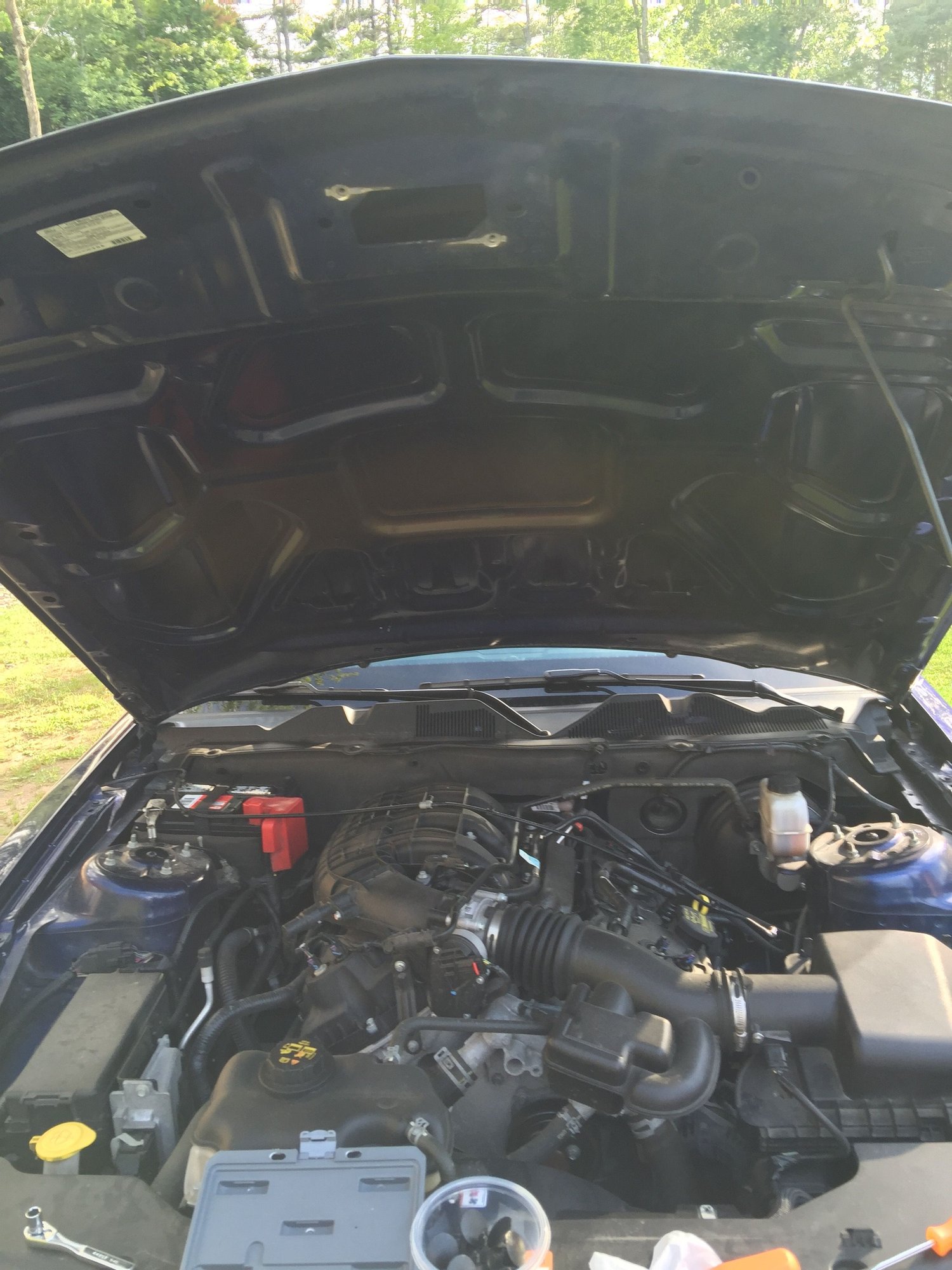

Here is a small write up on how to remove your old hood and put the new one on.
Here is the hood coming of the truck.
Hood
Now you want to strip off the hood latch which is 2 10mm bolts from the hood.
Then you want to remove your hood insulator.
next pull the windshield fluid hose and disconnect the c-clips
remove the hood water shielding
next grab a friend and un-bolt the 4 10mm bolts holding the hood on and remove the hood
Next put the new hood on and bolt it on. and attach the washer nozzles and other stuff and done.

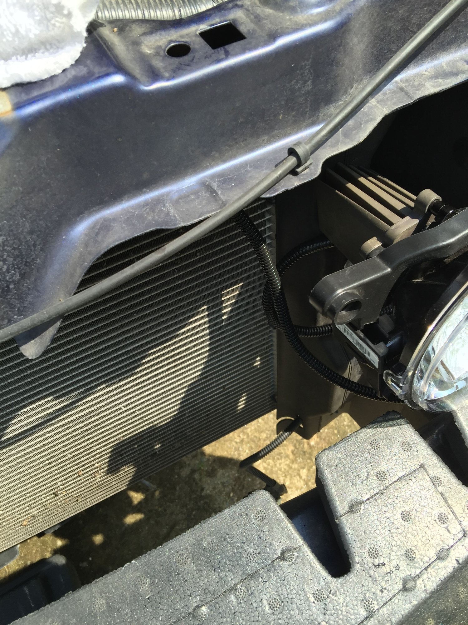

Fog Lamps:
Out of the box
The Connector:
Plugs into h11 connector and LED Fogs<br/>
Fogs Tested okay:
Off
On
How I ran the connectors:
Driver side.
Passenger Side
Below the closure panel
