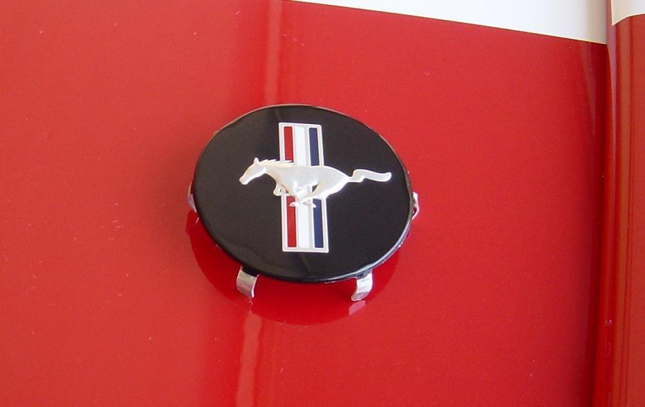

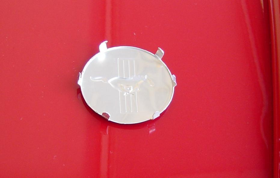

Originally Posted by Willie
The center cap emblem is made of nothing but thin tin metal. It can be pryed off with a couple of small screwdrivers. It's held in place with six thin tabs, nothing more. It took me about two minutes to remove it. Here are some pics.
Willie
Willie

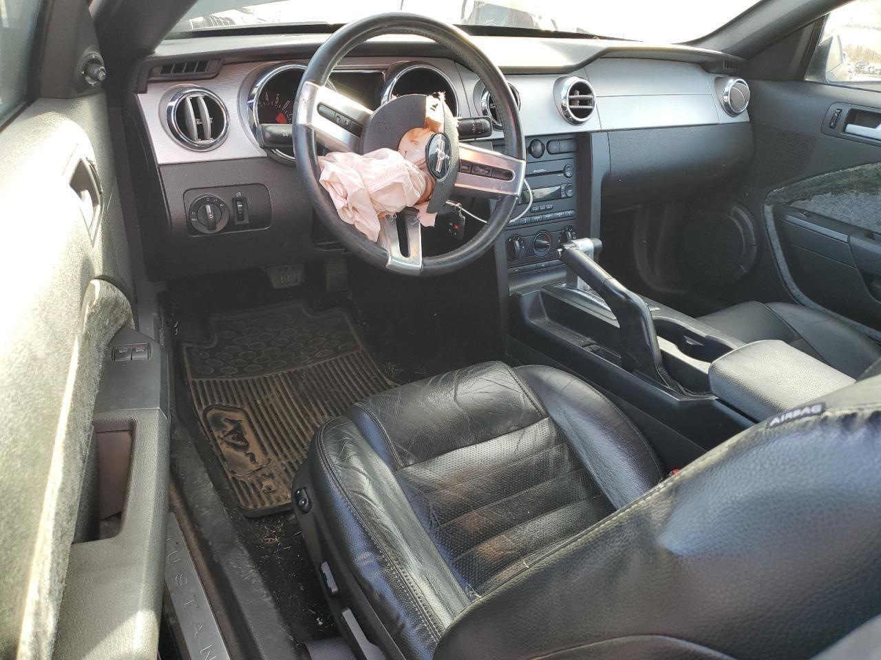

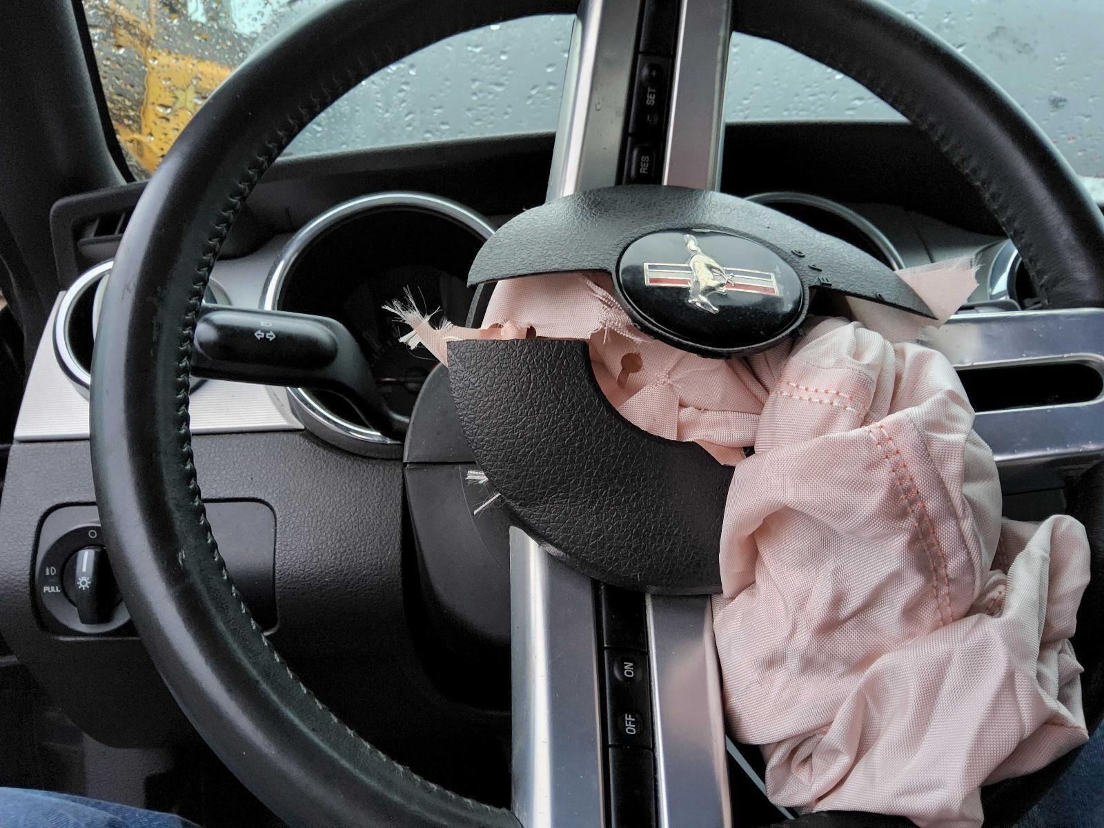

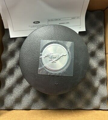

I Came Across Some Deployed Airbag Pics & Thought I Would Post Along With Other Earlier Pics From Thread To Give a Better Look at What You Are Dealing With in Regards To This Old Question!
These Days its About Scratched Up Emblems Vs Just a Cosmetic Change. They Have a Much More Durable Setup on the 2010-2014's Just Plain Silver Setup.

As an Fyi Here is The Airbag Recall Information. If You Get a Used Airbag To Get a Better Emblem and Want to Install as a Unit Make Sure it is the Updated Inflator Which Has a White Sticker. From What I See You Could Use a 2010-2012 Driver Airbag To Replace a 2005-2009 or Vice Versa. Anyhoo That's What I am Seeing. Do Your Own Research and Proceed At Your Own Risk. I Would Surmise If Yours Has Been Updated with The New Inflator You Could Swap The Inflator. If You Have Not Had Recall Done I Would Highly Advise You Do! A Vin Check At The Dealer Will Tell if they Have Been Completed.
