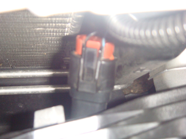

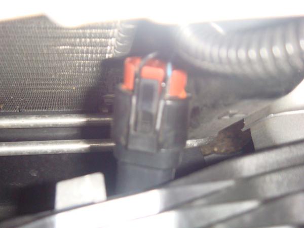

I had to flip the harness around. If you went color to color it will not work, at least on mine it didn't. Flip the harness that goes into the lamps around. Also I noticed that they would not work unless the car was running.
Good luck

I got everything working and not before I cleaned off the bulbs with a quick swab of rubbing alcohol. Thanks for all the help guys!
