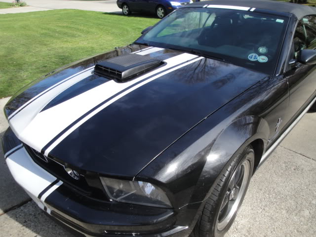

i love the look of the shaker scoop, its the coolest there is. but i hate the engine cover that goes with it so i opted for the roush scoop. even it has a nice look and feel from the drivers seat

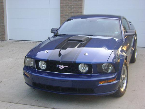

My solution for the shaker look without the shaker price...

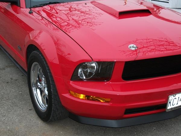

I got the Fang/Aeroform fiberglass hood and shaker- but I bolted the shaker to the hood (dont like engine covers much either) using their blockoff plate...had to fabricate a steel ring to sandwich a gasket to the scoop, had to make a gasket out of a sheet of 5/16 rubber, and mill about 1/2" off the aluminum front scoop mounting bosses... looks like a shaker, with Fang's hollow hood duct/airbox its functional, just doesnt shake (and hood is heavy- guessing plate, scoop, ring, gasket probably adds 15#, plus the 'glass hoods are very heavy compared to the factory aluminum...
my OEM hood suddenly suffered the bubbling paint(went from a few blisters to inches up over the front lip in a few months time) so I had to do something...due to not wanting the engine cover parts, the guy at Aeroform even knocked the price way down- want to say it was like 850 for everything I got, and a few evenings making parts.
Anyways, performance-wise, I'd say negative in my case- the engine sounds meaner, you definitely hear a big difference, but seat of the pants feel is the same...I'm sure the extra 50#(guess) of the 'glass hood over stock would eat up any minor gains, with the restrictive looking airbox mod and hood ducting, It sure dont look to be freeflowing- but by the sound of it, it must be getting freshair. a possible drawback to Fang's kit also is their duct kit is made to mod a OEM airbox...with a CAI the airbox parts wont fit- HOWEVER, I'm 99% sure the hood hole/duct would blow right over most CAI heatshields, and eliminate most of the restriction, and a lot of the work needed to install...It took me a couple evenings just to cutup the airbox, I split their duct in half to make filter replacement easier, just took a lot longer to cut/fit than I thought it would.

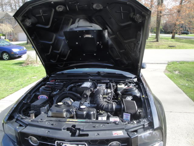

I did the same thing as you on my old car, using the Foose hood from CDC. With the Xcharger I didn't want to put that cover over top to trap heat on the blower, but wanted the look of the shaker along with an open scoop to pull cooling air on top of the blower.
