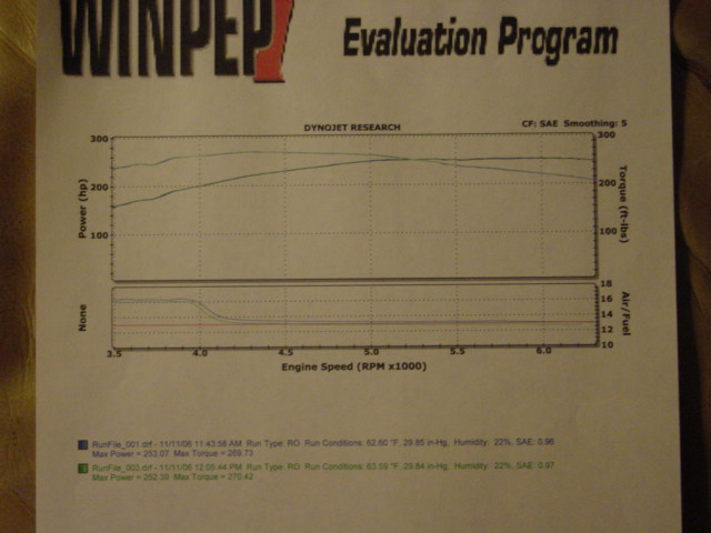

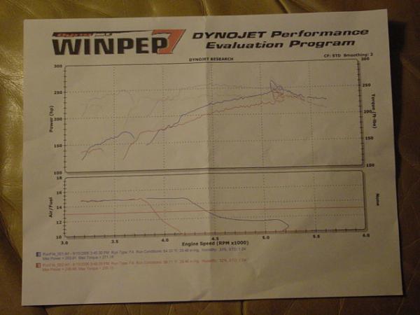

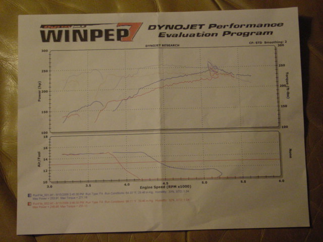

Here is my sheet from the dyno day, the first one is stock and was done in August at another dyno. There were no adjustments done just dynoed.
The second one is the final one that Doug did. It also has the FRPP stingers and K&N intake on it.
The first guy inflated the HP by running the dyno in STD mode and not in SAE.
Thanks Doug from the other Doug.

Wow, looks good, nice outcome there, that first graph was scary.

YEA! I agree, that is what we all get out of Detroit , total stock. That is why so many of us think a tune is almost required Even more if we have mods. ( and not the ones that are stolen from others.) sorry my shot.

And since we're on the subject, no, that is not a normal looking first dyno pull. If that dyno page had been used with regard to a GMS intake everyone would have been screaming bloody murder, but when it comes to someone else's no one says anything, so I'll say it. There was something wrong with either their setup or your car, that is not what we "all get out of Detroit".

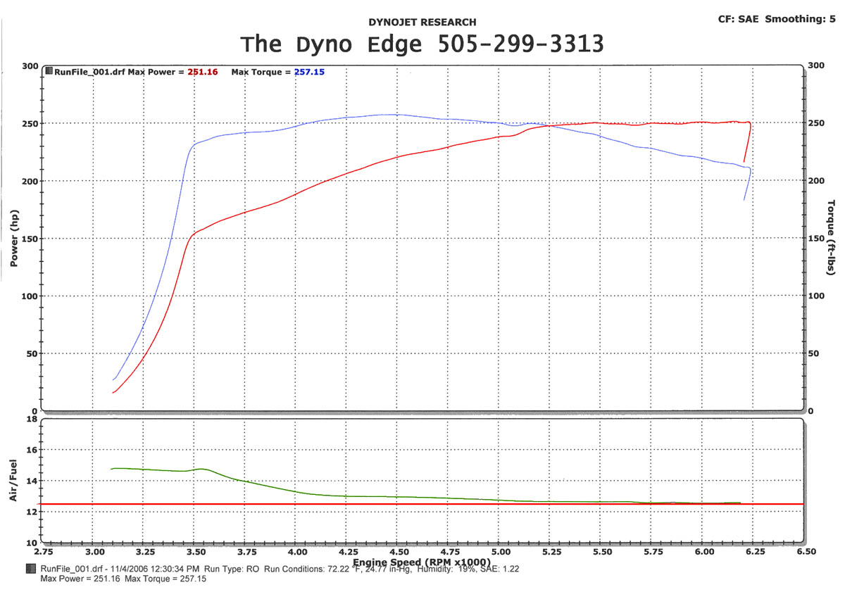

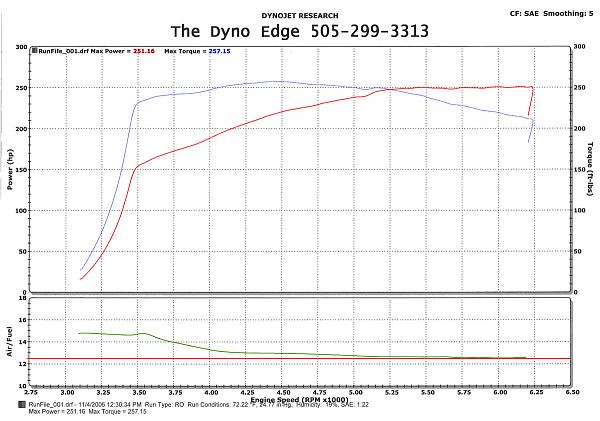

Oh, and for the umpteenth time, here is my dyno, GMS CAI, installed as directed, using their TUNED MAF. /wink
