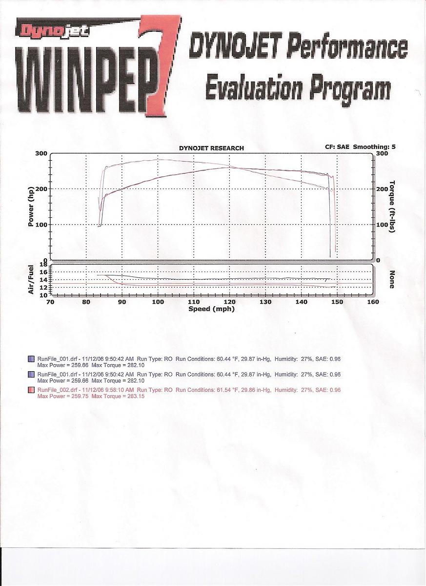

dyno sheet
Here is a scan of my dyno sheet with the granatelli intake. If you cant read, which I cant pm me and I will send you a legible copy. Thanks again doug, great shifts etc.
Thanks for posting your info, on the first dyno run was that with the GMS CAI and its MAF and harness assy? I do see that the first run was a little lean, what other mods were done to your car? Aside from the a/f, so you went from 259HP with the GMS CAI and MAF, to GMS CAI and stock MAF with a custom tune, and you ended up with 259HP?

Joined: November 12, 2004
Posts: 1,914
No I think this was the last runs done on the car with the regular maf I believe when he had adj the a/f for my final tune. I am waiting on my other ones to be emailed to me. This was the only print out I actually took, which was the last ones done. I will post my one with the granatelli maf as soon as I get it. I thought this might have had that info on it.

Just trying to understand your sheet data.
Run 1 was the GMS intake with the stock Ford MAF sensor (not GMS)
Run 2 was the same set up but with Doug's tune.
RUN 1 and Run 2 show no difference even though Doug radically corrected the A/F ratio?
More confused than ever.....

Doug@C&L's Avatar
Joined: July 28, 2004
Posts: 848
That was his emailed tune file and then I corrected the a/f and this is the same tune with the a/f better.
Actually, from that sheet that is two of the same runs, run 1, and then run 2.
That isn't the stock run with the GMS intake. I'm working on getting the dynofiles as we speak, Andy went by and got them.

Doug,
I'm still suprised that after correcting the A/F ratio there was no HP or torque change across the whole range.
