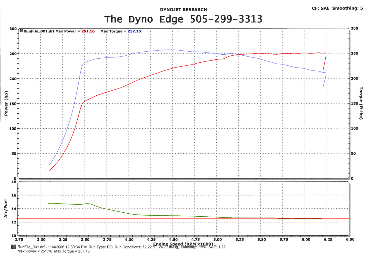

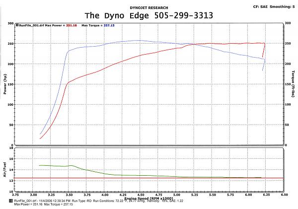

Well here is eci's dyno, on his second run his a/f jumped up to almost 16 it looks like, and that is with a tuner. http://forums.bradbarnett.net/showpo...&postcount=123
And here is mine, jumped up upon initial WOT, as expected, and then adjusted and compensated, and leveled out at 12.5. And like I said earlier, around same peak hp and torque as #10. I haven't done a stock base run yet so have no idea how much of an increase, but I will soon.

Cleaned up 05GTRedfire's plot and converted to jpg.
Attached Thumbnails Fantastic Dyno Weekend in St. Louis, MO-05gtredfire-dyno.jpg
