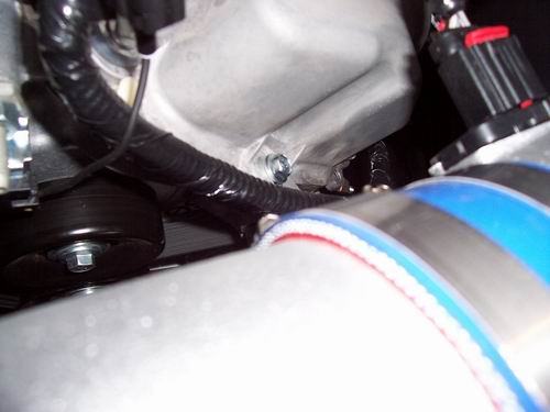

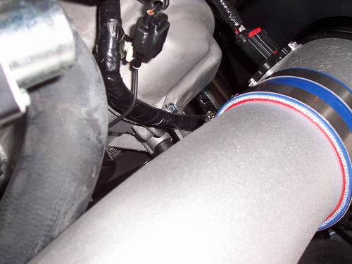

Hopefully these pictures work.
Attached Thumbnails Did anyone use the "MAF mount" on the C&L kit?-cl-intake3.jpg

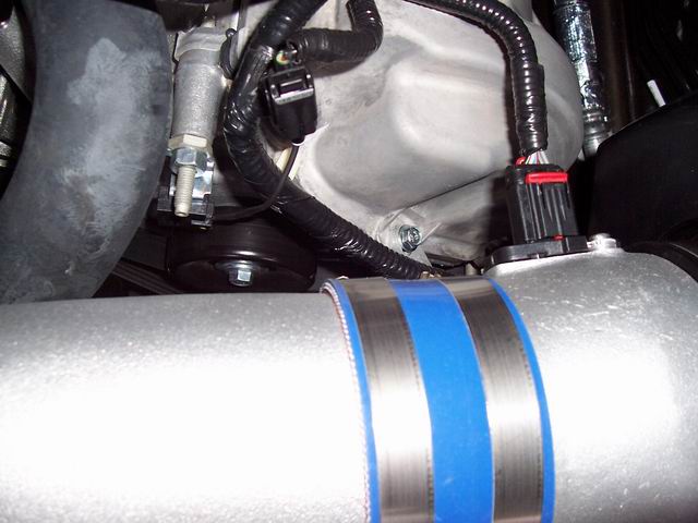

Wow, my valve covers clearly have much larger ribs.
Nice, two different types of valve covers for the 07 year. They probably changed suppliers and I got the newer one.

My car was built week of August 7. If you look at the pic of mine, do the ribs appear larger than on yours? Our pics aren't at the same angles.

Chris, the ribs on our valve covers do not appear to be as prominent as those in your picture. They also seem to be wider apart. I can say that the C&L bracket on our car fit with room to spare.
I am sure this caught C&L by surprise. It must be a different supplier or something or maybe our car being such an early 07 had a valve cover from the 06 inventory.
