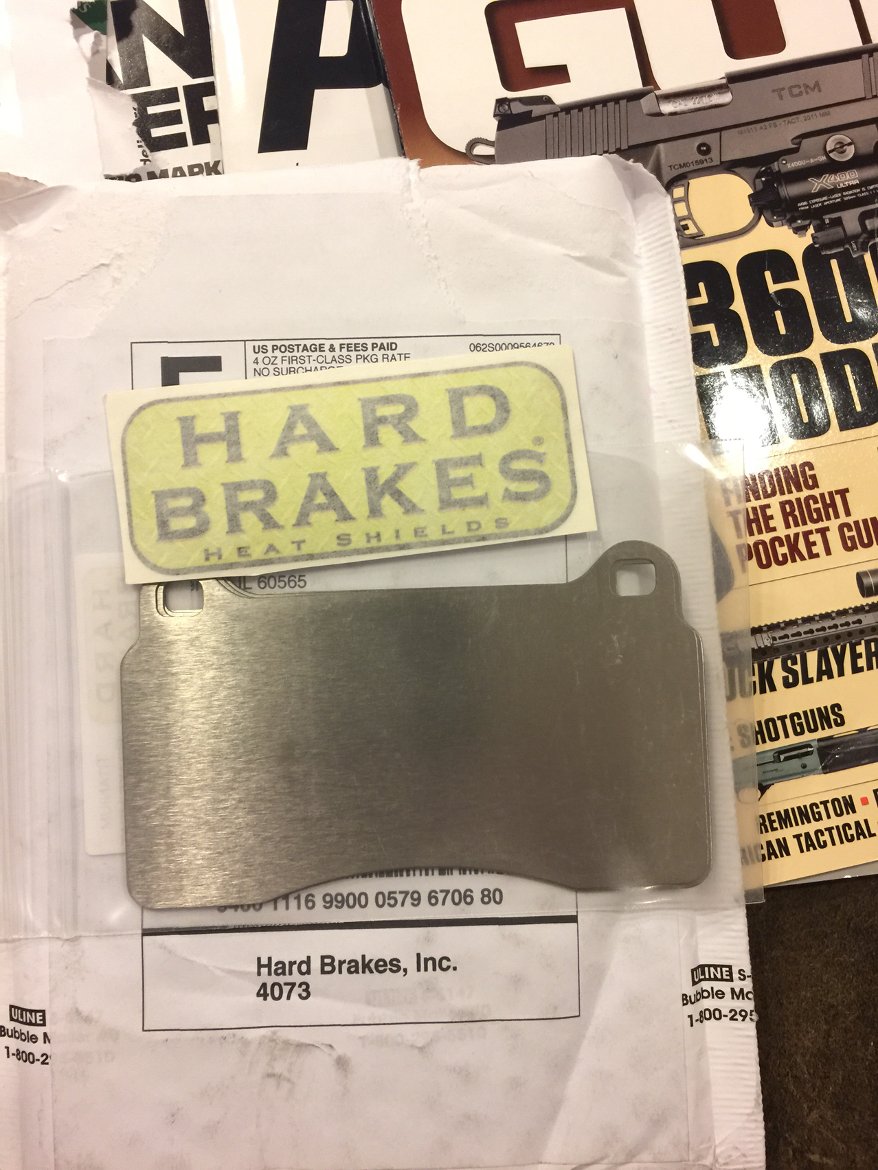

My ti shields came in, thanks dmichaels/5.monster for the discussion. I'm learning from this group all the time :-)

Nice! You'll like them. I still have a hard time wrapping my head around this working but I have had great results. Consider 2-piece rotors too... they run so much cooler as well.

I have been looking at the TI shields as well. I see that Hard Brakes sells 2 different thickness's. Are you guys running the .5mm or the 1 mm? I am curious if there is enough room to run the thicker shields with new pads or not.

I read from the TMO forum to go with the .5 because of fitment that's why I bought .5 but I'd recommend you search/read too

Agreed. The thicker ones can be too much for new pads. But slightlybeien pads would would just fine. I've been using the 0.5 ones for a couple seasons now with no issues.

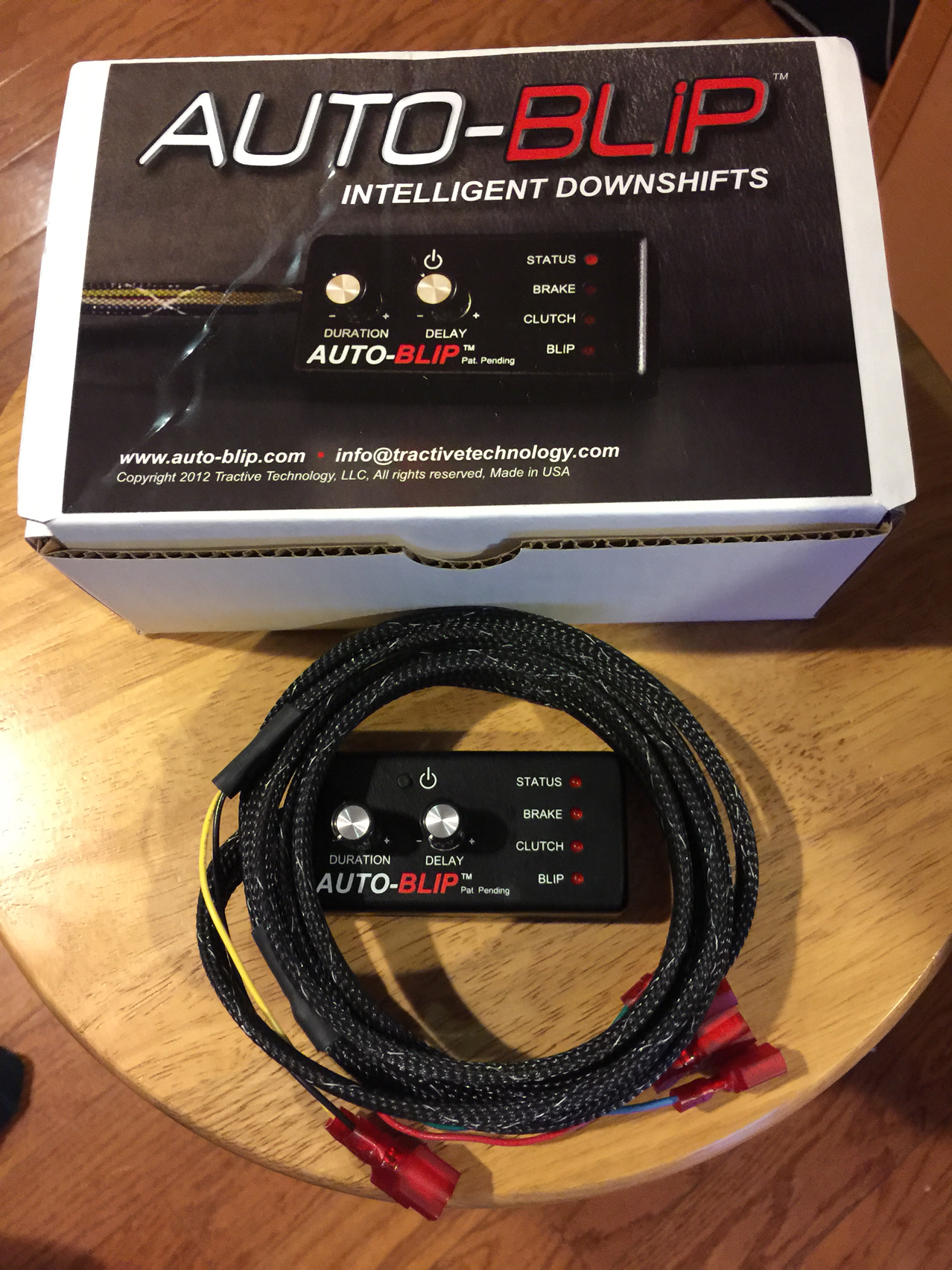

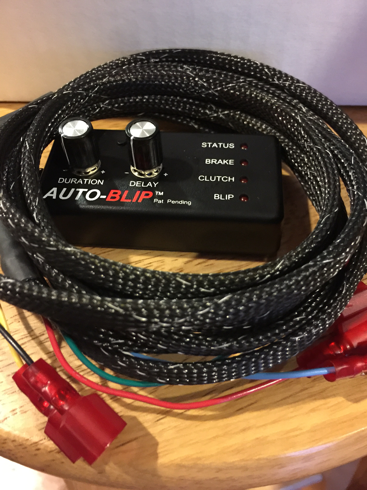

Just got my AutoBlip, this season should be interesting starting with COTA next month :-)

I've heard good things about the auto blip!

At the risk of sounding stupid, what is an Auto Blip?

It automatically blips the throttle when you downshift (similar to heel/toe)

interesting since I haven't mastered heal toe shifting yet.

sounds like cheating to me!
I wonder how it copes with the throttle lag, I haven't mastered the downshift yet either and the lag does not help.
By the way, for my feet on this car, it is more of a left side / right side of foot thing, not really heal/toe

I bet you Auto Blip does it better than me though, so that should be fun!
