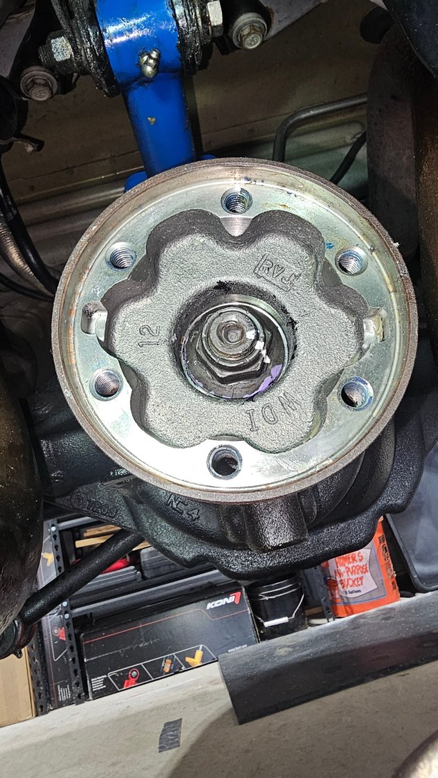

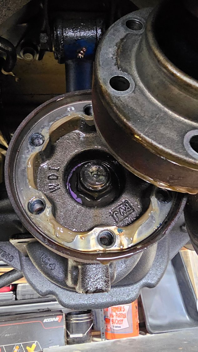

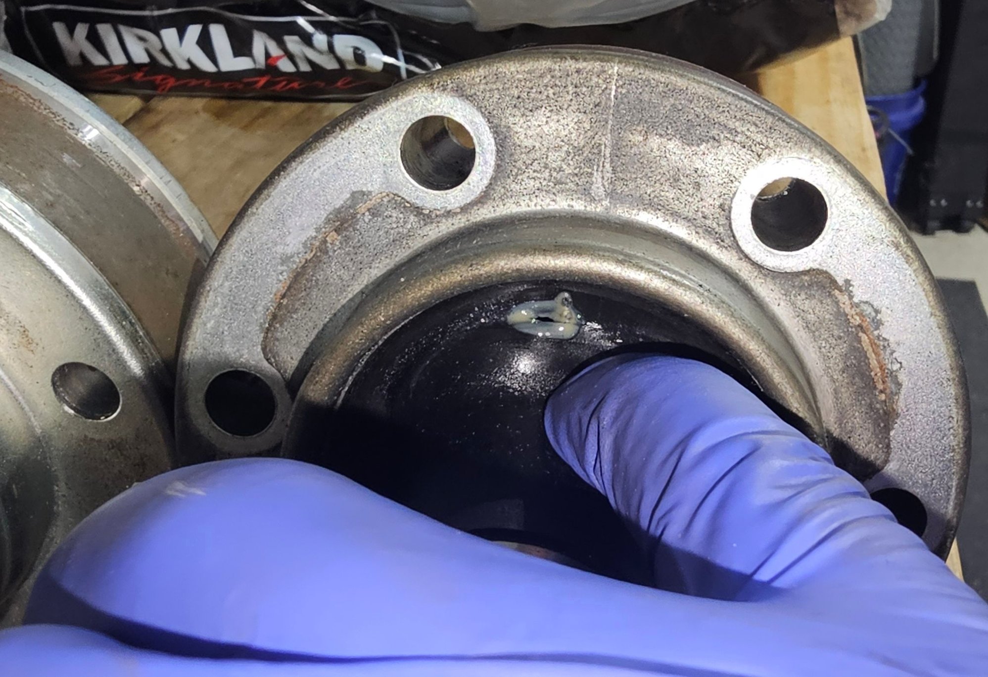

Replaced the factory driveshaft which had developed a leak in the rear CV boot with another factory driveshaft that came off a car that was bought and immediately sent off to Shelby American for the Super Snake package to be installed. The car had 8.3 miles on it when it was sent off, according to the owner. Part of the package was apparently a 1-piece Dynatech driveshaft.
Also fixed a diff fluid leak which had developed over time, seeping through the pinion nut. Took the nut off, cleaned it, put RTV sealant on the back side and put it back on with some Loctite on it. This was as recommended to me from a good friend of mine who works on these cars all the time and has seen this a bunch of times.
While I was under there, I also installed a new axle vent and topped off the diff fluid.Planning on a finned aluminum cover soon along with fresh fluid of course.

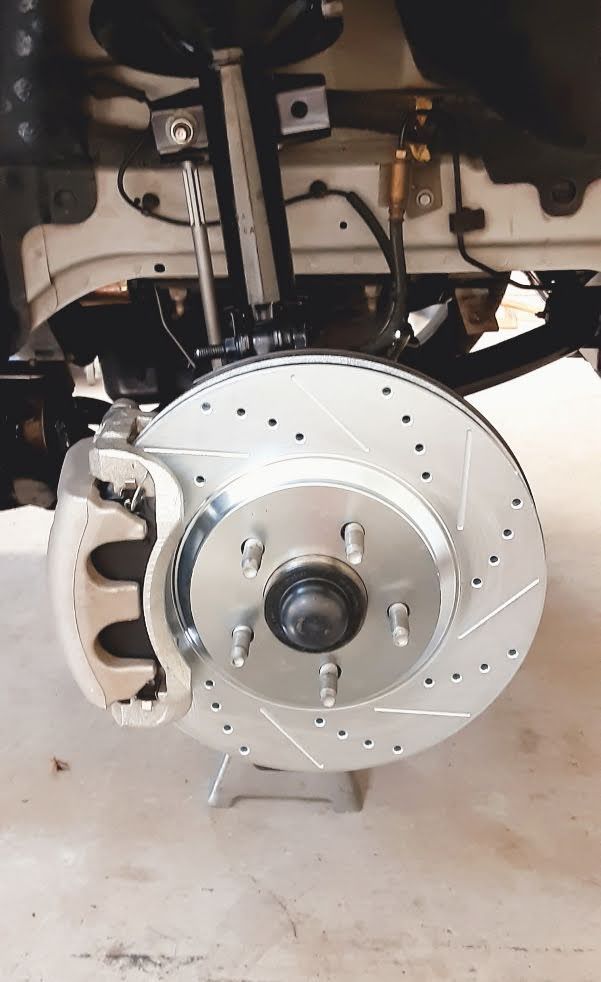

Changing out the rotors and pads.

So Clean it Looks Like a Factory Component Detail Picture!
Are Those Colors on The Tips of The Wheel Studs Something Added?

No they weren't, I was going to ask you why they are there? On the rear studs only also.

My Guess Would be To Identify For Assembly At Factory Or They are Clocked Somehow For Assembly. Maybe a Balance Thing as Well! Now I'm Gonna Wonder for Sure! Also thinking Maybe They are Tested in Specific Areas and Those Indicate They Were Tested For Specs in 3 Areas.
If Nobody Else has Seen These I Would Say Previous Owner Was Doing Something!
I Will See What My Gt-500 Has on The Rear as The Wheels Have Only Been Off Once in The Back & Should Still Have Marks if Factory. That is When I Ever Get Around To Installing My 2015 Take Offs! If Not My Tires Are Way Aged Out & Gonna Have To Be Replaced soon Enough!

Got the front brakes done. Now for the rears maybe tomorrow.
