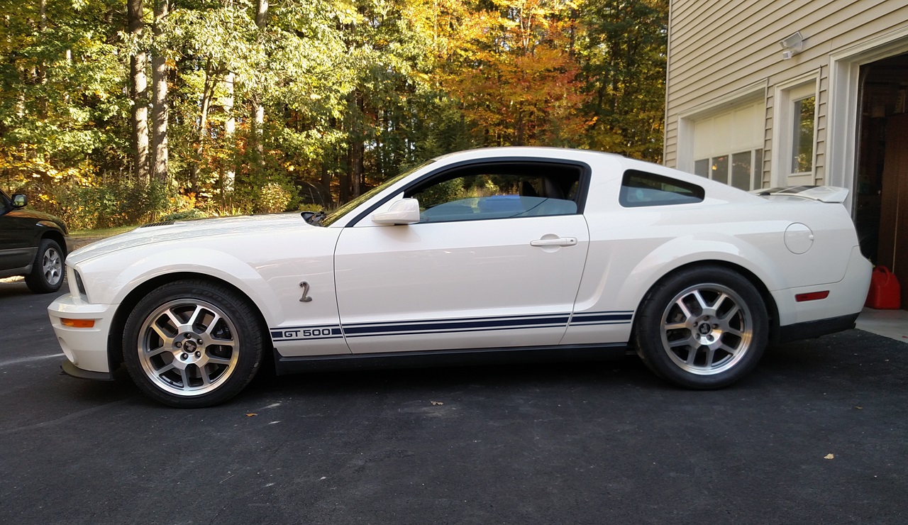

Brought the girlfriend's Shelby from this:

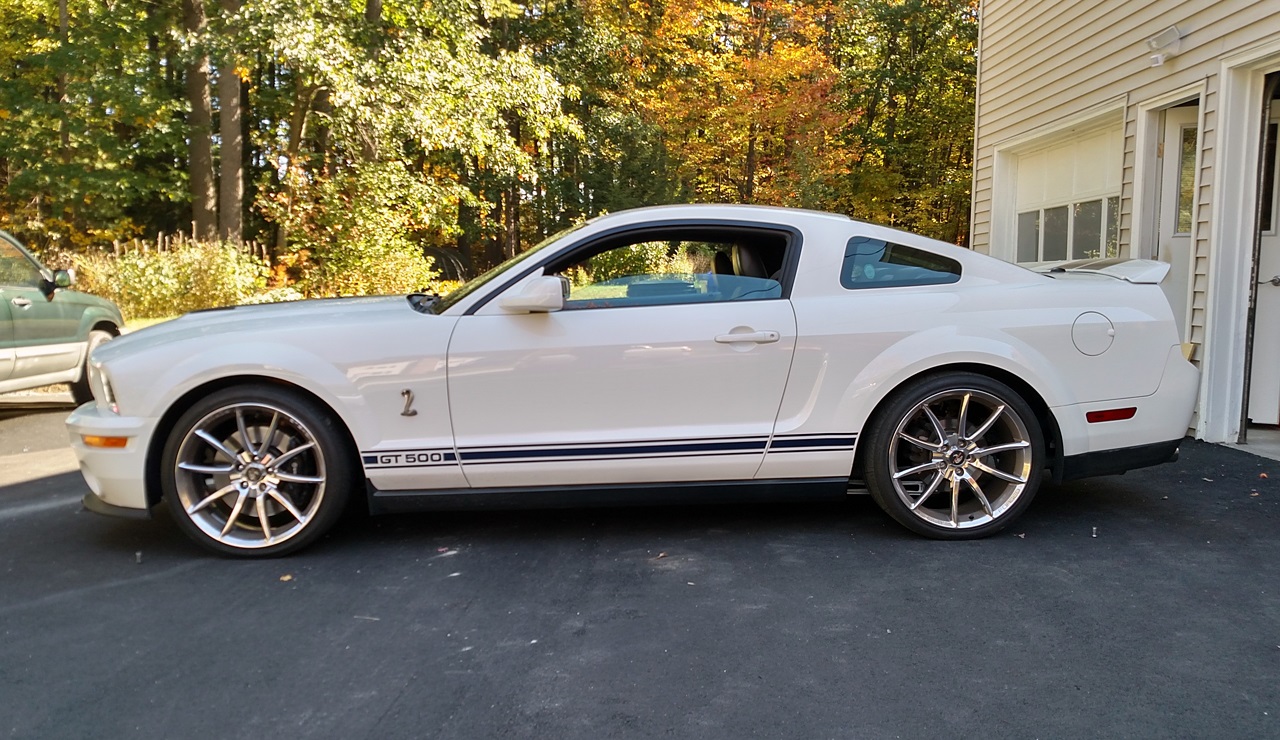

To this:
Since the Alcoas are for sale

Looks good Burton!!
Originally Posted by Stage_3
Looking good!
Thanks Tony.
I polished the crap out of every one of them.
They had scratches and brake dust all over them.
They look almost new now
Tomorrow she's getting a 2013-2014 GT500 2.3 blower installed, along with '13-'14 GT500 56lb injectors, new NGK TR6 spark plugs, and a new CAI.
She's gonna need the traction of those DR's even more than she needs it now.

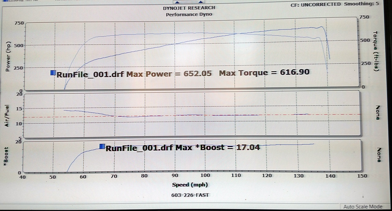

Got the girlfriend's new '13-'14 TVS blower installed today, with the new '13-'14 GT500 injectors, new JLT 123mm CAI, and the FRPP twin 65mm TB ... 17 psi, 20 deg timing, SAE-corrected 643 rwhp, 608 rwtq, uncorrected 652/617.
She's happy

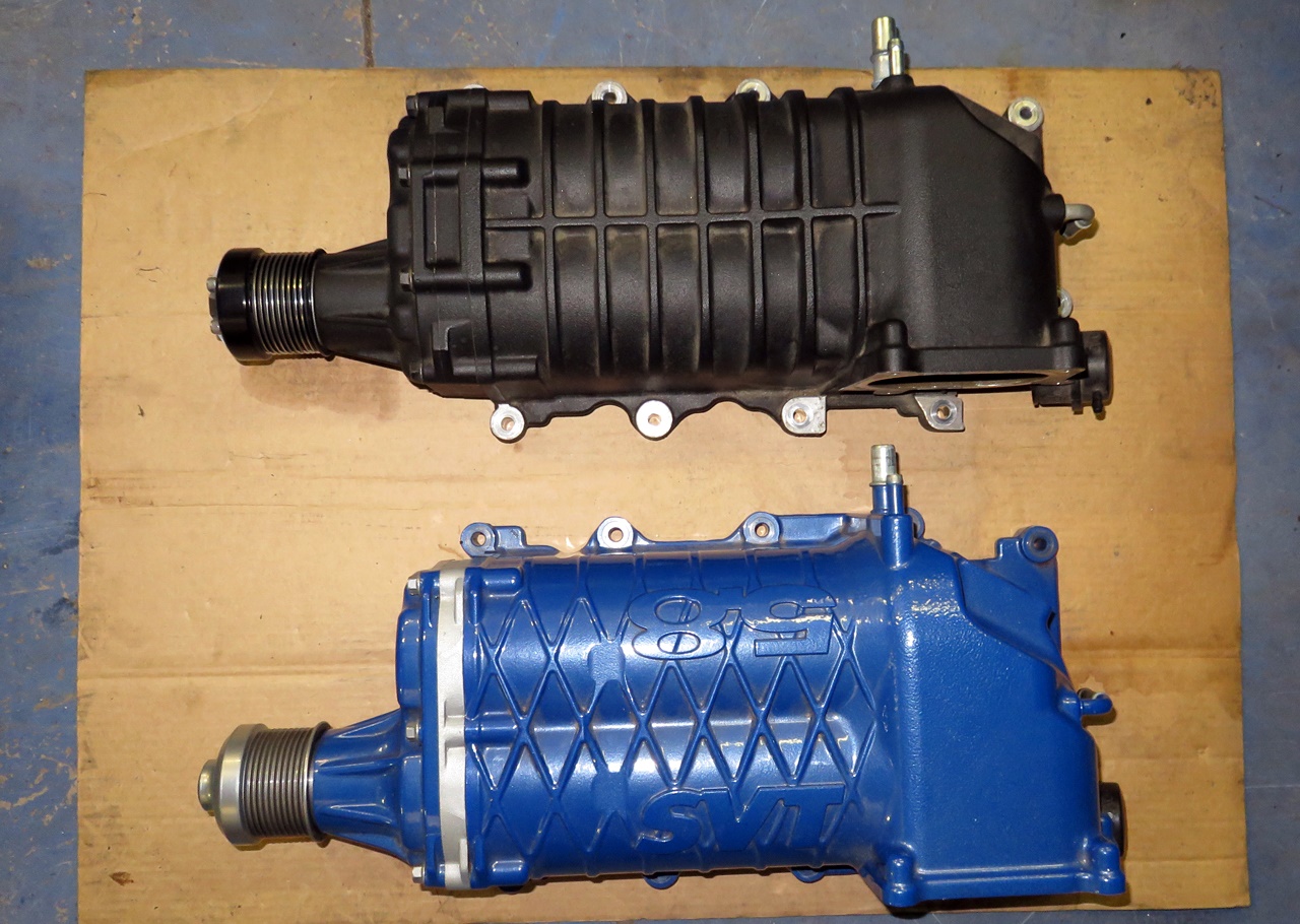

Originally Posted by FromZto5
Gabe I forget... Did you do the install? And did the existing manifold work for the 5.8 blower? Or did you have to get a different one?

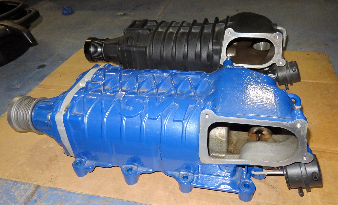

A friend did it, I helped a bunch.
Blower bolted right on, same lower manifold.

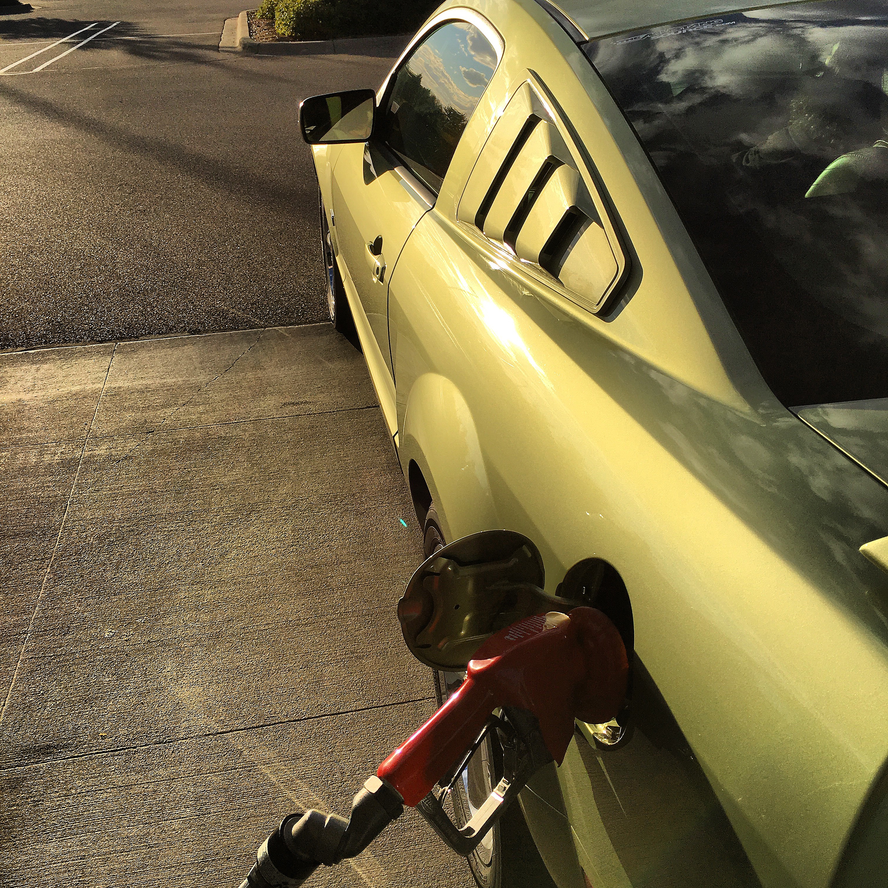

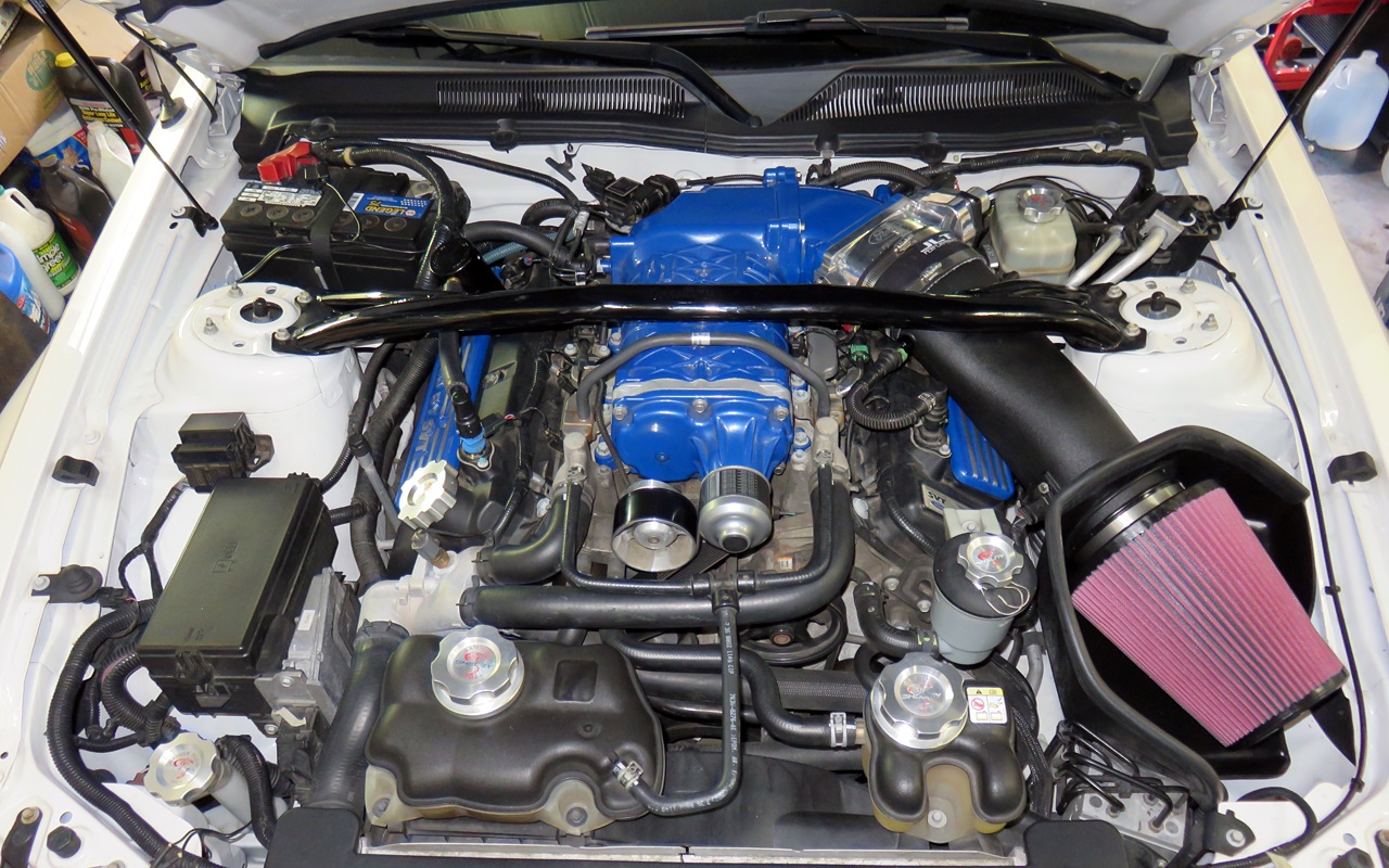

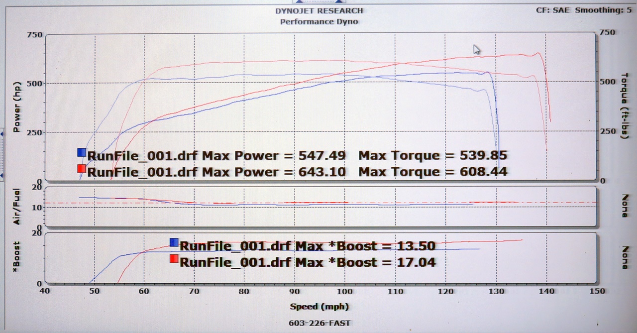

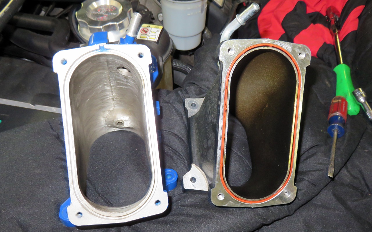

The vid
17psi using stock pulley and a lightly ported elbow
SAE corrected numbers: 643 rwhp, 608 rwtq
Uncorrected numbers: 652 rwhp, 617 rwtq
The "before TVS" numbers and the SAE-corrected "after" numbers:
Installed:
Uncorrected:

Old and new:

Beast mode, Gabe. Beast mode

Looks great Mark.
Awesome photo. Shows the metallic flake.
