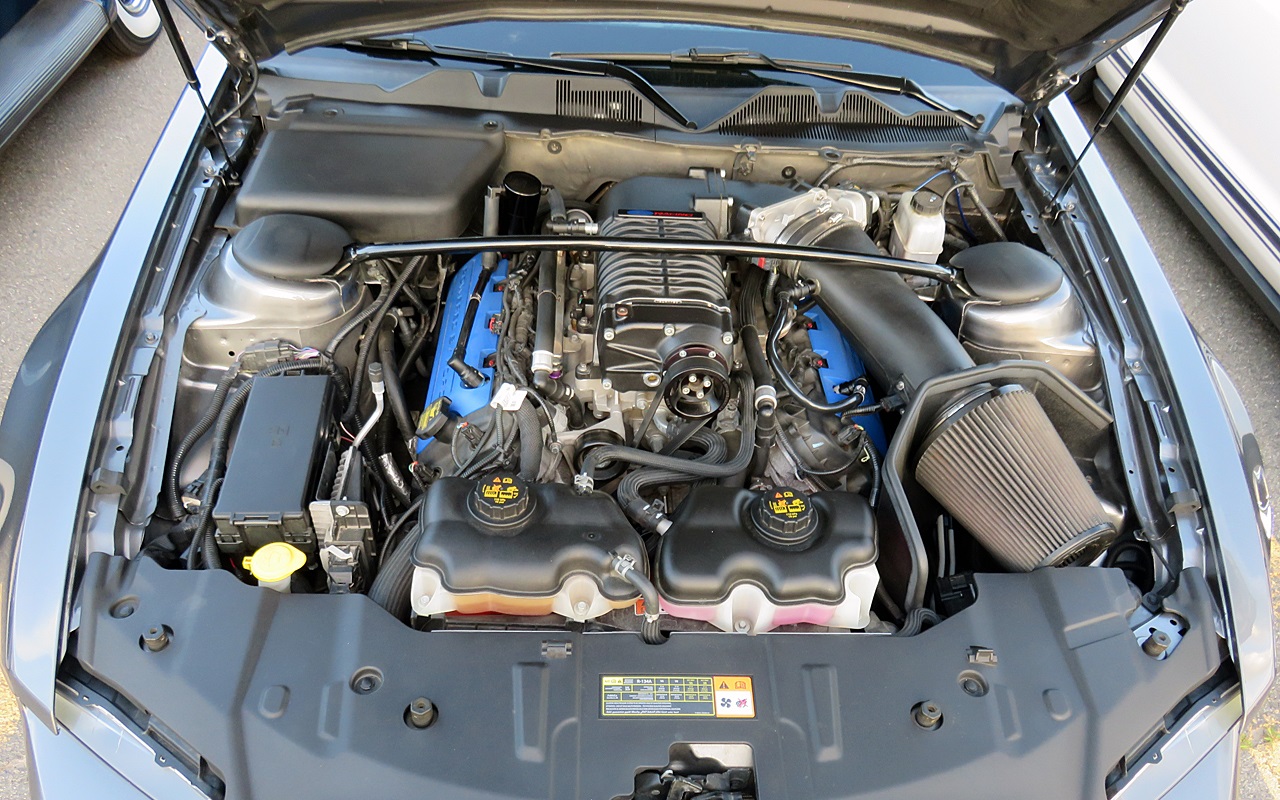

Today I finally removed the driver side catch can since over the last 1,000 miles it's been bone dry.
Problem I had was that during the installation I had cut the original PCV tube that came with the blower kit, and obtaining another one's proven difficult.
So, I recently found the stock PCV tube from the passenger side of the engine, but it had a 90-degree connector at each end, and to make it work on the driver side I needed to remove one of those 90's and replace it with a straighter one, which I just happened to be using with the driver side catch can hose that went to the intake tube.
So after borrowing somebody's lighter (was doing this at a car show, lol), I used it to heat up the tubing so the 90-degree connector could be removed, and used it again to soften it up so I could insert the straighter connector, which still needed a bit of oil on it so it would go in without pinching the o-ring that's on it.
But I got it done, no more driver side catch can, and the connector that goes to the intake tube now goes in at a straighter angle so it fits better.
Old fitment was somewhat suspect, possibly causing a slight lean condition we recently noticed on the dyno.
Happy "after" pic:

That engine ....

Lol, thanks Darren
